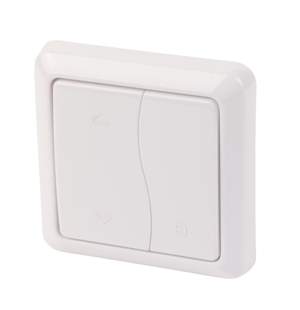

A last option might be Wireless switching like this http://www.wirelesslightingstore.co...ss-1-gang-wall-light-switch-he307w--pack.html

The only other option is radio or inferred links to the switches. From the MK switches to the add ons there are a host of units allowing wireless operation however often expensive and many have dimmers built in which will not work with many LED and CFL used today.
these will work but the unit is not very good looking and there is a trade off between price and looks. It would seem these from screwfix can even be controlled from your Iphone as well as a standard looking switch like this so there are ways around the problem it just depends on how much you want to pay.
