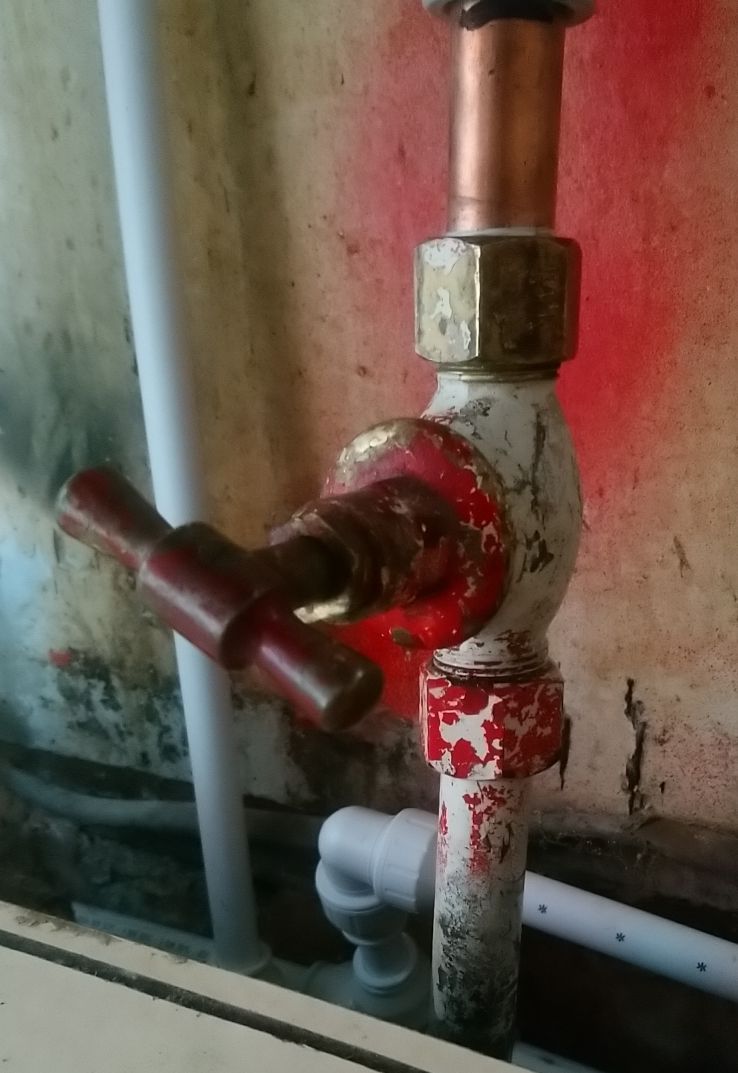

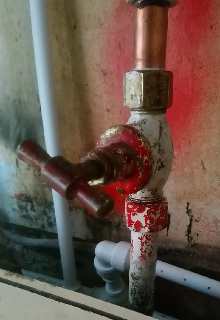

I've just replaced all of the 3/4" pipework in our late 60s house, and the only thing left is the stopcock itself. It has something similar to a compression fitting, but the pipe hardly inserts into the body of the stopcock at all, and the nut is taller than usual and has a rotatable brass bush inside it..? I think the pipe that was mounted in it before had a pre-formed ridge rather than an olive - I'm showing my layman's ignorance here.
I'm using a stub of 3/4" copper pipe and a 3/4" olive but can't get a weep-free connection. I'd rather not replace the stopcock itself if I can avoid it. Can anyone tell me if there's a better way to connect to it please.

I can't disconnect it at the mo so not much to see, but this is it:
Didn’t really need a photo, it’s a manipulative compression joint, so either need to manipulate the pipe, renew the stopcock, or renew just above the stopcock.
Looking at the photo, it seems more like 1/2” pipework as opposed to 3/4”.
Thanks Chris, new one on me. In my ignorance I cut the old manipulated pipe stem to remove the fittings, so I'm a bit stuck from that point of view. I'll maybe see if a local plumber can manipulate and install a new one otherwise I guess the stopcock will have to be replaced.

Yup, as you compress the nut, the bush inside grabs the pipe and flares it onto the fitting making it watertight. Old school stuff that.
Shut off the ouside water and replace the whole thing would be my advice. Old stuff like that will be either 1/2" which is compatble with 15mm or 3/4" which isn't compatible with 22mm and will need a converter.

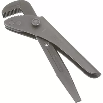

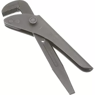

It's amazing the number of jobs you can do with the pointy end of a pair of footprints....
I've often wondered why the end of the inner arm of the footprints is shaped like that! I know it must be for a reason... I guess I assumed it was for flaring out the open end of a lead pipe ready to insert a copper pipe & wipe a 'proper' joint.
