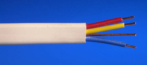

this stuff is 3 and earth
it should availible from any diy shed near you ;) you need to replace the existing run from the lounge light to the switch with it.
