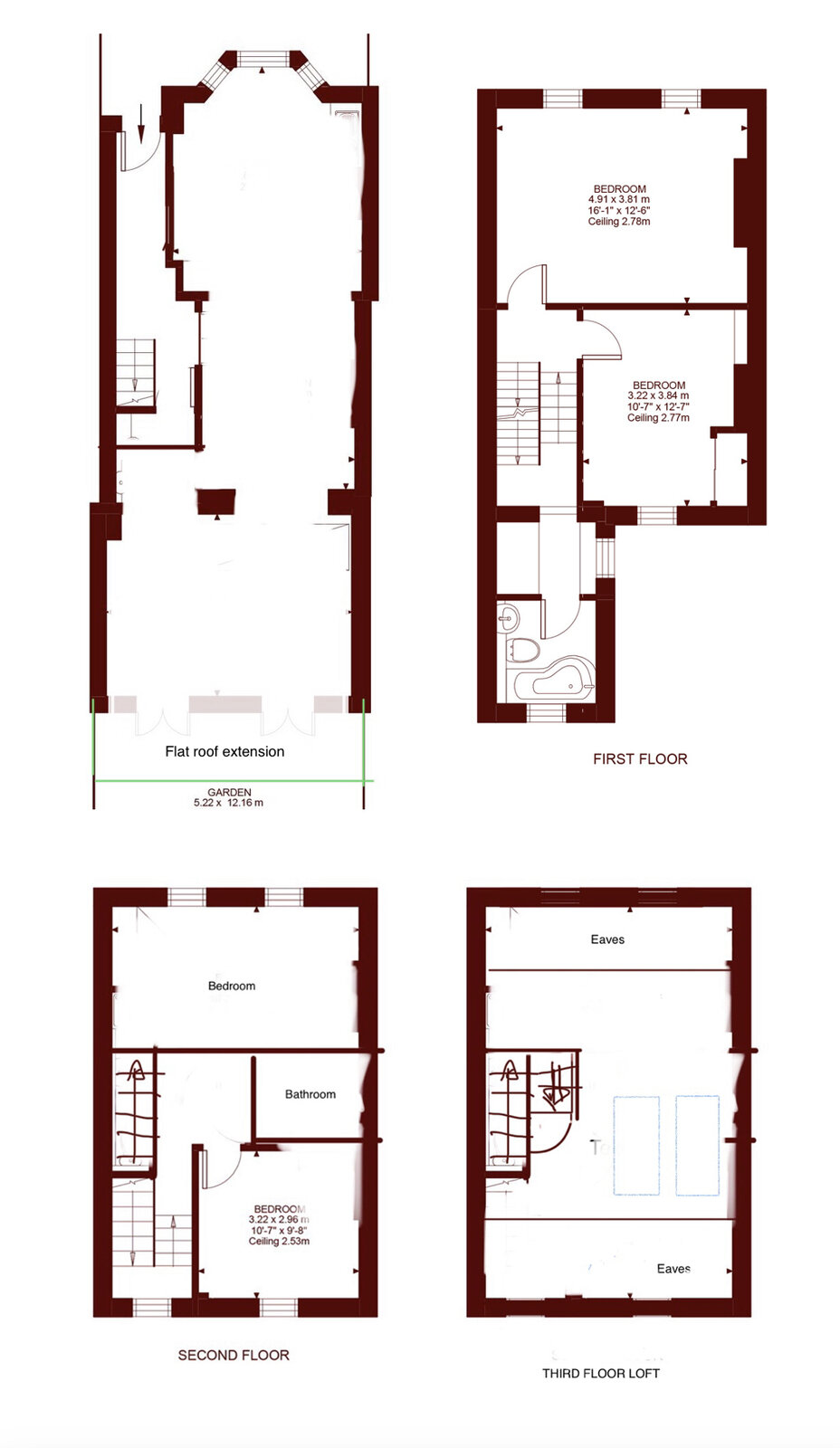

Hi,
I’m renovating a 3 storey house in Brixton. I’d like to make it a 4 storey building by converting the loft on the 3rd floor.
My problem is Approved Document B of the Building Regs, sections 2.5 and 2.6. These require any newly-created 4 storey buildings to have either two staircases or fire sprinkler systems THROUGHOUT (ie in every bedroom).
I’ve contacted various misting companies and all their quotes are 11-12k.
This is a bit of a shock and a blow. I’d intended to put steel into the loft to create a bedroom and support the removal of two chimneys.
But with this very high cost it’s just not worth it.
Does anyone have any informed ideas on whether there’s any way around this provision? It’s a single dwelling house.
Thanks in advance

Hi. I’ve stripped the house and am currently insulating and decorating. Start on a bathroom tomorrow. ‘Through lounge’ USB being installed end of the month. Here are some floor plans - pre and post work.
We’ve had a full measured survey and various engineers drawings done but the floor plans explain the issue best.

2.5 isn’t the issue - 2.6 is the issue. The proposed loft floor is more than 7.5m above ground, and I’d have two floors above 4.5m. So under 2.6 the loft floor would need a separate escape route or I need sprinklers throughout the property.
Or does this not apply because it’s a loft, and instead 2.21 applies?
Looks to me as though you get to swerve 2.6 etc because you are converting an existing dwelling rather than building a new one. But you would be wise to check with some sort of professional on this scale and risk level of work. Your plan drawer or surveyor may be a useful first port of call
Thanks for your help. I emailed council BC yesterday and am waiting for their reply. The house was built in the 1860s - certainly not a new build:) I hope you’re right
I’m assuming 2.6 formalised that decision into the regs and if that decision were out of date I doubt it’d be on the gov.uk website but let’s see what BC say
