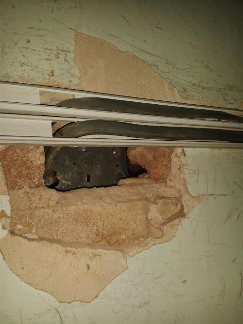

Im replacing my current 45A Coooker Switch for a nicer looking one and at the same time refitting my entire kitchen.

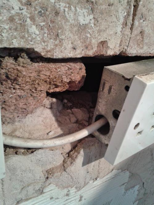

When I have removed the metal back box a load of brick has crumbled away leaving a fair bit of space to be filled in with something to support the metal box.
What can I use to fill the space and what size back box do I need (35mm?) (I want to pick one up from ScrewFix on my way home today)
47mm backbox for the standard cooker isolator switch.
I generally use plasterboard dry-line adhesive to fill in voids/gaps in walls.
It sets rock hard, the boxes can be left to set in them and the compound allows you to put a fixing in it.

The crumbled brickwork has almost gone through to the next room (room under stairs) so Im going to have to fix a backing board on to that wall to stop the filler/plaster/cement/etc from dropping thru it. literally daylight!
If you remove all the loose stuff, then on reverse side of wall (under stairs] cut a wee bit of plasterboard to fit the hole. Apply board adhesive on the internal of hole, so you can insert plasterboard so slightly recessed, 2-3mm on this wall. Have a good dollop of the adhesive on board within hole and wall, so board and wall will adhere. Leave for the manufactures specified time to set (usually a couple of hours).
Then you can fill in the hole on the socket side, if your canny you can set the backbox within the compound, but make sure you have it exactly were it is to stay as it will not budge once set, so ideally isolate circuit, grommet backbox and feed cable through. Then insert backbox into compound to set. Once set I would leave overnight, you can tidy up around backbox, pilot for wall plugs, insert plug and screw up.
The adhesive, will set rock hard, and if backbox is left to set in it, the need for screws would be unlikely but belt/braces.
Leaving 2-3mm on reverse side of wall, will allow you to plaster that flat with existing wall.

How thick is this wall - is it just a single brick thickness? If so, and if we are talking of a 47mm back box, you might theoretically run foul of the regulations about how deep a hole (proportion of wall thickness) is permitted in a wall - if that matters to you!

Good point. I think its single, I'll have to check when I get home tonight. I'll check the size of the current back box as well.

Do both the cables in the conduits connect to the supply side of the cooker switch? It appears to be a ring!
What is the FCU serving, the hob?
:confused:
:confused:
Both the cables go into the back of the socket box. One comes from the fuse box under the stairs and the other cable goes to the oven & hob. The small socket (FCU?) feeds the fan extractor
