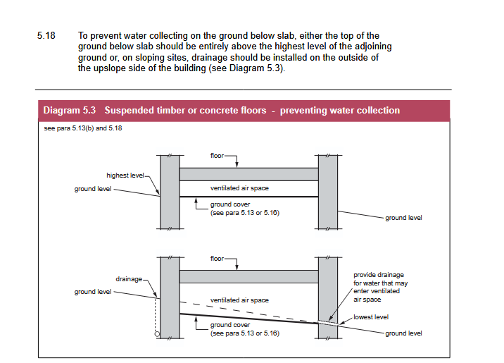

Is there any scope to run drainage along the Left Hand side of the Building?
The distance between the existing left wall of my bungalow and neighbour's is approx 2.4m Any drains that might go down that alley would be closer to my wall found than 1 metre. With very shallow foundations it's probably not a great area for drain runs and involve lots of concrete fill.
The following may also be relevant - some local BC technical advice is attached.
While the patio to the right and rear of the extension are both 125mm above oversite concrete level i'm (tentatively) assuming a single land drain to the rear (as per the plan) will suffice.
I plan to reduce FGL to the left hand side of the extension by 300mm from patio FGL (i.e. two steps). It will then be 175mm below the extension oversite concrete.
The extension (interior) is 4250mm front-to-back. Sloping each half of the concrete oversite top face downward by about 50mm (approx 1/80) to a central channel and providing drainage by way of a 40mm drain pipe through the left wall seems it might have a chance of approval.
Left side FGL rises to rear patio FGL again at the line of the rear of the existing bungalow but I will keep a 300mm wide channel on my side of the boundaty at 300mm less than rear patio FGL until that interfaces with natural ground level some way to the front of the alley on the sloping site..

2.4m is quite wide, I don't see an issue with running a drain through there, provided the existing Foundations aren't undermined.
Do you imagine an overriding improvement (e.g. dismissing extension/garage alleyway foul complications & garage floor storm I.C. complications) by redesign and trying to send everything down the left, or something more subtle perhaps?
You need to keep things as simple as possible. The further and more complicated route the sewage has to take, the more chance of a problem in the future, in the current design you've got it running round 3 sides of the property.
I'd be looking to bring the Kitchen drainage down the Left side, and it can run parallel with the surface water across the front to pick up the sewer as it leaves the property.
Bathroom Stub Stack in the middle of the build, take that to the right at 90° and join into the run on the right hand side where it meets. Bend can be used to achieve required angle. En Suite, I'd be looking to connect Basin either into the WC drain, or drop the basin and shower into a Bottle Gully immediately outside the property.
Then decide if you really need 110mm Drainage for the Hot Tub, if you don't, then it cuts out all that pipework going to and behind the rear of the build. Air Con drainage could then go into the Rainwater, it's clean water.

Extension oversite concrete drainage query (I hope the plan drawing makes this clearer than the following written description!!)
The reason for the additional shading / colouring along the left side of the extension and existing wall being that i'm not particularly confident of my updated extension oversite drainage scheme described below.
In summary, again, the rear/right patio FGL is above extension oversite concrete by 124mm. That oversite level is the same as the top surface of the existing (150mm thick strip ) rear (entire left-to-right) foundation.
In attempt to provide extension oversite drainage (the regulations require this to prevent pooling), to a lower level exterior finished ground level, i've:
Externally to Extension
1/ At the interface between the rear patio and path (of 1200mm width) to the left of the extension the ground level has been reduced by 170mm (i.e. existing FGL here has been reduced by a 170mm single step down).
Note - if the extension oversite concrete where to be level it would all be (170 - 124) = 46mm above the path
2/ This path continues along the left of extension at the same 170mm reduced level
until
3/ At the interface of this left path and the existing rear foundation there is a 170mm step up (across a width of 750mm portion of the full 1200mm) adjacent to the existing residence left wall. The remaining (outer) path width (450mm) is not stepped up, it remains level at 170mm below rear patio FGL
Note - the 170mm step back up is to the original, non-reduced, FGL at that point. If the step up did not occur then (170 - 124) = 46mm of the existing rear strip foundation would be exposed above ground.
4/ The remaining 450mm portion of the (reduced by 170mm) path continues level toward the front garden along the existing left wall until it intersects with the existing sloping path (whose average fall along the side of the existing wall is 5.7 eightieths)
This 450mm "channel" is bounded on both sides by sections of 90mm width concrete dwarf wall (they have a top elevation with 15mm flat and 75mm sloping). The effective width of the channel is therefore (450 – 2 x 75) = 300mm.

A/ At the inner leaf of the rear extension wall and the outer leaf of the rear existing dining room wall the extension oversite concrete is 124mm below rear patio FGL.
B/ The oversite concrete is angled down from both of these boundary locations at 1/80th toward the midline of the extension. The resultant fall is 27mm. This midline oversite is now (46 - 27) = 19mm above the level of the path to the left of the extension.
C/ A 40mm dia pipe exits the 350mm left patio wall at the extension midline. Its internal oversite invert is at 19mm above the extension left path and a 1/80th pipe fall of 4mm sees its invert at 15mm above extension left path (170mm reduced) FGL.
In summary,
(i) The extension oversite concrete drains to the extension (170mm reduced level) left path surface.
(ii) The extension left path level surface drains, via a 300mm wide level (front to back) "channel" (at 2385mm towards the front garden from the existing rear foundation) at the interface between it and the existing (5.7 eightieth fall) sloping left path.
Does that seem reasonable?
