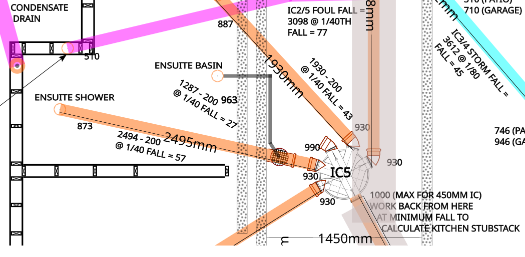

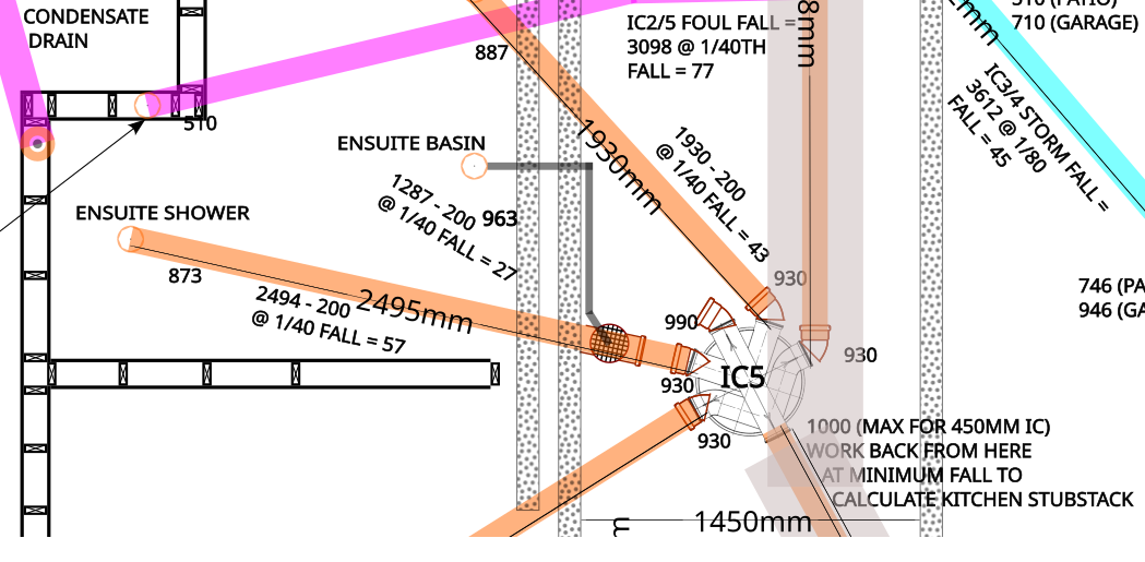

I'm currently using Inkscape to draw a Building Contol Application for flat roof extension to / renovation of my suspended wooden floor bungalow - please see a screenshot of the drainage (with calculation) as a work in progress attached.
The image currently displays 450mm foul Inspection Chamber "IC5" with:
1/ left 90° branch in connected to internal bathroom stubstack
2/ left 45° branch in connected to ensuite shower
3/ main in connected to ensuite basin
4/ right 45° branch in connected to ensuite WC
5/ right 90° branch in connected to upstream "IC2 main out (which acts as a collector for the planned kitchen stubstack and several other items (including garden hot tub).
As currently configured the bends connecting directly to the Inspection Chamber for items 3/, 4/ & 5/ are greater than 45° with 5/ being greatest at around 60°
Is it known if those connector angles (i.e. adjustables greater than 45) are acceptable, possible or definitely unacceptable in the circumstances?
Any comment appreciated - including if there are any other "obvious" mistakes.

That drawing gives me a headache. :oops:
The shower and basin don't need 110mm drainage extending all the way into the building. Both could discharge into a single external gully, depending on where the shower waste exits the tray.
It looks a mess to be honest, and very overcomplicated. Which parts are existing and what are you planning to add?
Keep runs as short and direct as possible, you're showing one run from the bottom left going around 3 sides of the Building, could that go straight across the bottom? Again, the en Suite Bathroom, one 110mm run for the WC and the basin at least could connect to that, possible the shower could too.
Most drainage plans get amended once you get into the ground: the more complicated the plan the greater the chance. KISS principle.
It looks complex but logical. I can't see how you could simplify it given the amount of stuff that needs connecting.
My rules are that the turn which is part of the chamber itself doesn't count, as it's all accessible when you open it up.
A 45 degree directly on the inlet is fine, as you can reach around it or rod it to/from the chamber.
I say it's all fine. But I'm not an expert!
Use single socket corners for the inlets, not a double socket with a little stub of pipe to connect it. Then it will be almost inside the chamber and really easy to access.
Try and put toilets into the central inlet if possible. If not then at least put something regularly used there, so you don't end up with jobbies sitting in there stinking as nobody's used that rarely used basin for a while.

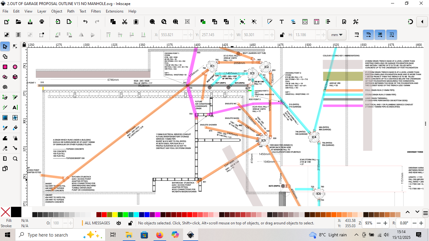

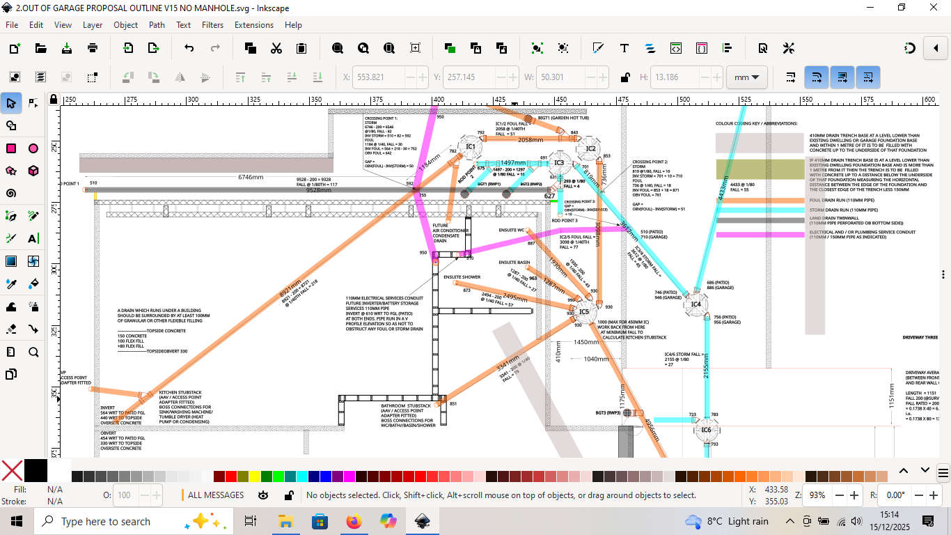

I'll add a pdf that has work in progress of the entire drainage scheme in it - making things a bit clearer (hopefully).
The bottom left is the head of the foul drain run, which terminates in a stub stack to service the new flat roof extension kitchen to be fitted against the leftmost wall in the original image. A 45° connector leads to a short branch and SVP on the external wall close by. The top of the strip foundation, that runs left to right across the back of the existing bungalow, in this location is 125mm below patio FGL (the 1958 concrete is approx 150mm deep).
I thought it might be prudent to get back from that strip found reasonablky quickly and be at least 1metre back so as to avoid concrete drain trench fill to the level of the underside of the existing found.
In order to pick up a possible future air to air heat pump condensate drain on the back wall of the extension (but that is simply water, so is it meant for storm drain) and to add a foul branch from a garden hot tub sunk into a raised garden area, I decided to just keep on going with that drain into the rear patio area.
From what I can tell, the obvert of the (storm) land drain must start at a minimum of 400mm below patio FGL hereabouts. The foul obvert to land drain invert cross point gap is currently only 50mm so would appreciate other options.
So long as I can independently pick up the garden hot tub & future heat pump condensate drains, I can't see a good reason not to place the kitchen stub stack at the far side of the extension and have drawn that possibility on the the pdf. The drain now then runs from there to IC5 45° in (hashed red line) along the same line as the ensuite shower (the less crossings, the better).

Other background:
The bottom of the footing (edit: "footing" should read as "strip foundation") of the detached (1958) garage is 30mm above patio FGL (sitting proudly exposed). It's approx 100 deep. Garage FGL is 200mm above patio FGL.
The wall gap for the foul run between the garage and extension is 1450mm. I believe the full length of thar drain trench must have concrete fill to the level of the underside of the bungalow foundation.
The gap between bungalow back wall and garage front wall is 1175mm. The invert of foul IC5 main out is at lowest permitted value (1000mm) for 450mm IC. The connection between it and driveway foul IC7 squeezes through this gap but undercuts both garage and bungalow foundations, thus requiring concrete trench fill to the underside of existing bungalow foundation (and "packing up" to the underside of the garage foundation).
The land drain & regular storm drain are combined via IC3 prior proceeding through the garage wall, welll below existing strip found level (thus underpinning required).
All falls for storm and foul in the patio area & garage area are at minimum requirements (1/40 foul & 1/80 storm) and all drain runs appear to achieve minimum required cover. Likewise all IC's in these two areas appear to have IC main and branch inverts / obverts within spec.
The existing bathroom becomes internal. It is extended into the area of the flat roof extension so as the base of its servicing stub stack does not need to go beneath the existing strip foundation of the bungalow's back wall (underpinning avoidance).
The top of the strip foundation of the extension will be at least 1000mm below patio FGL.
The extension floor buildup will be the same as the existing suspended floors. All will be modified to ensure 150mm clear void between top of oversite and bottom of floor joist.
The driveway has 3 distinct average slope regions. Various foul/storm drain falls (at or above minimum) were chosen so as to maintain all drain run obverts 600mm below driveway FGL and IC obvert / inverts between 600mm & 1000mm of driveway FGL.
If possible I do not wish to construct or have a prefabricated manhole (for drain invert of greater than 1000mm) anywhere in the scheme.
If possible I do not wish to have any exterior wall standpipes in the scheme.
Unless otherwise stated figures at IC's are invert values with repect to rear patio FGL.
Two further queries:
a/ It all seems to "fit. However, many/most of the drain crossing points have very little separation between obvert below / invert above - is this an issue?
b/ Again, if nothing is changed from the plan as it is currently stands, are/should/could the 5 input connections (some greater than 45°) to foul IC5 be acceptable?

Could you not drop the basin and shower waste into the soil rather than all the additional pipework?
If you mean drop internally vertically down onto the top of the drain then .... since neither would be upstream roddable directly from an IC nor, explicitly, roddable downstream (into a branch connected directly to an IC), my understanding is that the decision could be contentious.
For example, a bottle gully trap is considered explicitly roddable downstream if Y connected to a branch drain (even though not directly roddable upstream from an IC). However, I don't want external standpipes.
Similarly, a back inlet bottle gully trap is also considered explicitly roddable downstream but, to the best of my understanding, the internal horizontal run connecting to its back inlet must be very short before turning vertically up (and could only service a single internal appliance).
I could be wrong.
I can't, currently, see how anything other than a direct IC connection to the ensuite shower will work.
I'll have a think about using a back inlet bottle gully trap for the ensuite basin and connecting that directly to the ensuite WC drain to free up an IC5 input which could be useful (there's not much space in the alley between the garage and extension though).
Thanks for the idea.
The shower could be spigotted into a gully back inlet. The basin can discharge through the top grid.
As per attached?
The BIGT 160mm stackable risers I have seen are 250mm tall so 3 or 4 needed to take the it's outlet invert to 930mm. I don't think i've ever read of a limit to the depth of one of these ... should that be ok?
