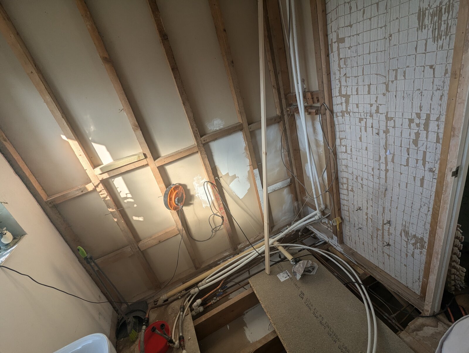

Its a partition stud wall. Bedroom one side, bathroom the other. The depth of the stud is actually about 70mm hence why I originally bought 50mm insulation pads. But now decided to add 18mm battens on the face of the studs to build it out deeper so I can fit a niche.
It's plasterboard facing bedroom and will be putting hardieback bathroom side, tanking and porcelain tiles
