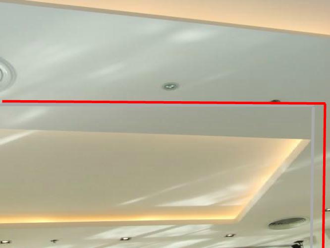

Couldn't agree more, they are only there to allow me to get the conservatory certified :cool:
They'll be recessed and have solid sliding blinds underneath, similar to those found on aircraft windows, I'll frame them with some form of indirect lighting to disguise their true purpose :evil:
I'm only going down this route as to get the look I want certified as an extension will cost a small fortune in triple glazed units, bloody greenies :rolleyes:[/img]
