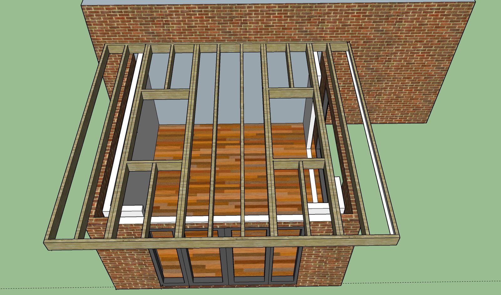

Hi everyone
So I'm looking at sorting out my conservatory and after next door had a flat roof with a lantern fitted I plan at getting rid of the polycarbonate crap.
So size is roughly 4m x 4m
Glazed all around
mini cavity wall with brick & breeze blocks
My plan is as followed
One wall completely brick up (this is on the outside of my garden area so don't make sense having it a window?)
pillars added to each corner
all done with brick & breeze blocks
Then a flat roof with rooflights
I have done a quick sketchup of my idea just wondering if anyone can see any issues with it?
I know it's more expensive, but a larger single central pitched lantern would create a room that feels more spacious.
If you do a warm roof, by the time you've got joists, insulation over top and lantern upstand the reveals to the lantern usually end up being over 300mm and can make small roof lights feel a bit like letterboxes.
Unless you really need it, I would avoid brickwork above the doors. In any case, you would need 3 courses so you could fit standard catnip lintels.
If you want the brickwork at the front to act as a buttress it needs to be, probably 675mm wide (I think 3 bricks is ok for a 2.4m height - but others will confirm)
The roof overhang is a nice feature - done well it can look great and its practical as it keeps rain off the doors and windows.
Cheers
Nothing is to scale in the sketchup..
Would I get away with no bricks above the door and window? I added it as support with the catnip lintel, if I can do away with them it would make it easier.
Yes going for warm roof the next door neighbours is a lantern I shall look into them
Scrap that I know how to get the support
Shorten the roof to stop above door then add a overhang extension part to it
What size timber will I need for the roof? thinking of 400 centres?
