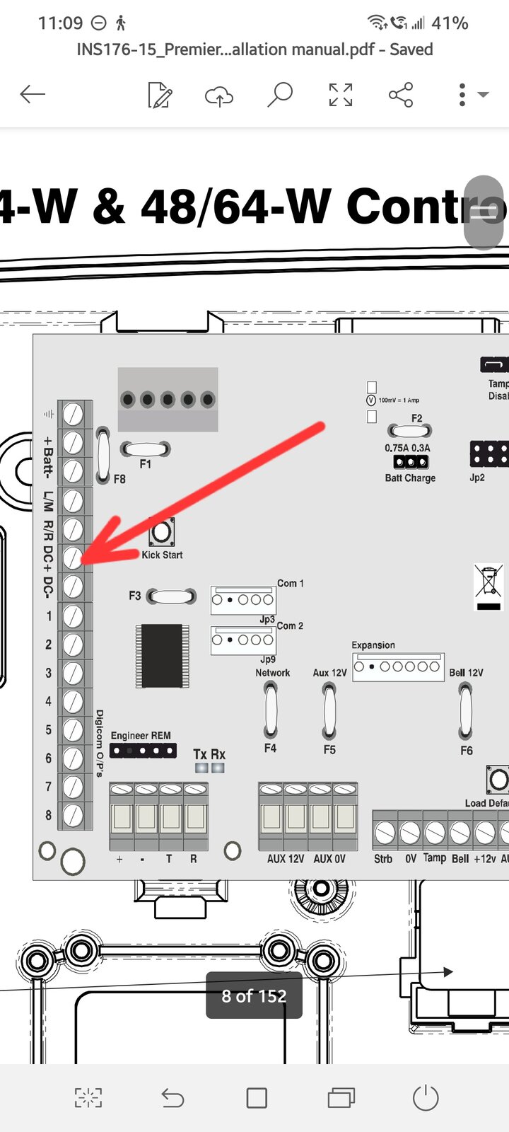

Hi
Default PSU in 64w is 1.5A.
Can this be removed and replaced with Texecom 2.5A PSU and I assume you'd have to put a larger fuse in?
Asking because the system I have in mind will be close to 1.5A draw when in alarm conditions (if not slightly over with 2nd bellbox?).
You can but wont do you any good in doing so.

List the products you are using.
You can use 1A inline fuse on the dc communicator power to provide power for the second bell potentially.

You have 900mA fuse for the bell terminals in the alarm panel.
The XBE draws 18mA idle plus 40mA for the back light plus 285mA for the sounder in alarm plus 100mA for the strobe.
The Nova depends on how many piezos it has but similar, so inline fuse as mentioned above should resolve that issue.

Not quite sure what you mean above about "DC communicator power" ??
Do you mean an additional psu200 to support the main panel?
I'd rather not if I can avoid it.
Maybe I need the garage bellbox to be wireless instead of wired. That should make a difference.
On the alarm panel dc+ dc- and digital outputs, put in line fuse on dc+
Ahh, so you're saying wire the 12v+ wire from 1 external sounder to a digicom terminal (dc+), but put a 1A in-line fuse (does it need to be slow blow?) in it.
I assume the other 4 wires from bellbox go to the normal panel terminals (0V, bell-trigger, strobe and tamper).
Or have I got it completely wrong?
