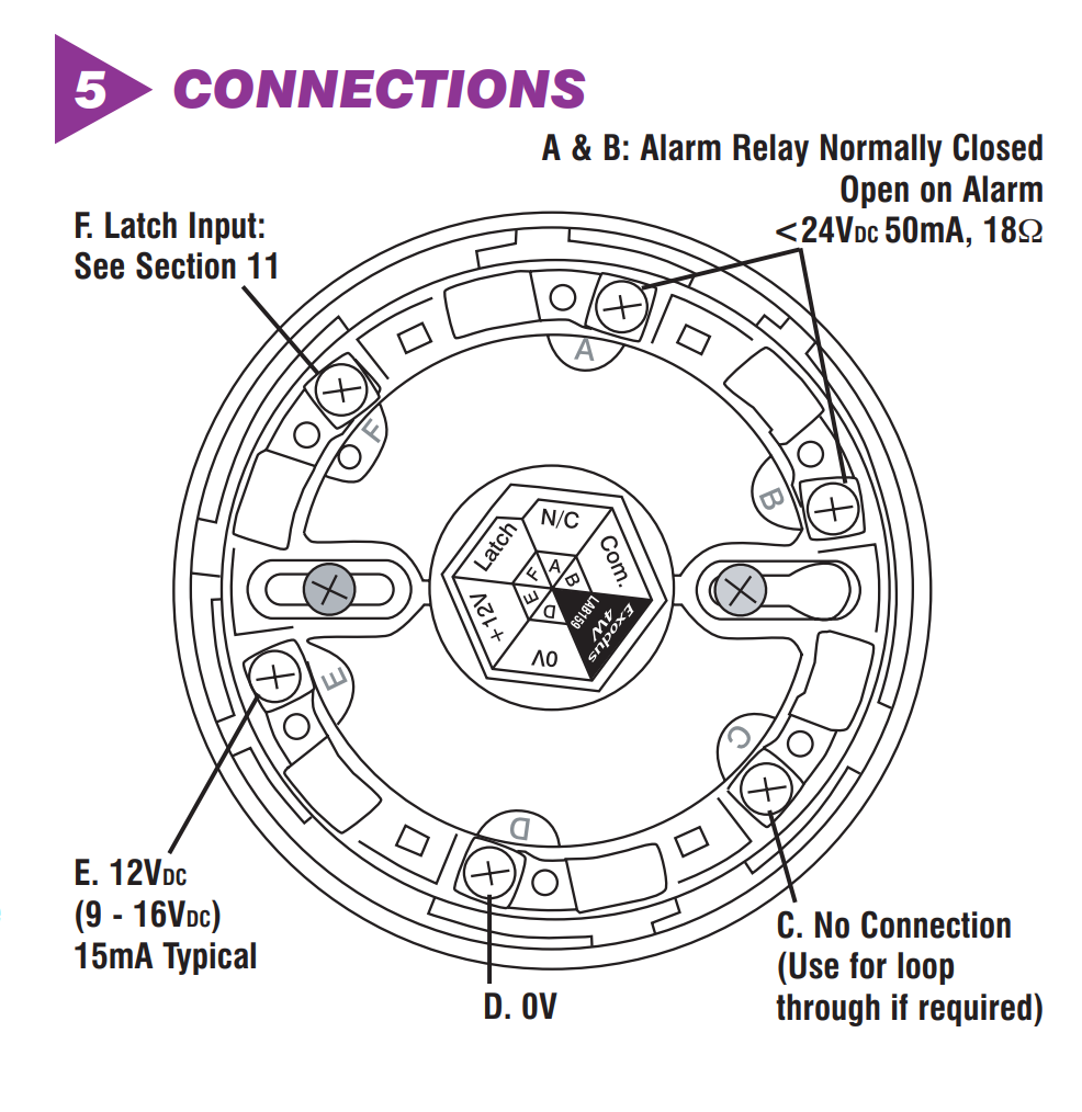

ok so I get the wiring for pir now and ill need a expander. Having reviewed the smoke head wiring I can see I need 12&0v to E & D but then from the panel instructions it says to use Output 1 for fire detectors, so is this just 1 wire going into A at the head and out at B to the next head finishing with a eol resistor or something?? very confused with this!

If you have spare zones just wire as normal one per zone ....if not it sort of works like an old fire alarm but devices are normally closed , and an extra wire for detector reset ( programmes as an output at the panel )
Right got it, I'm happy for it to operate as traditional fire alarm instead of rewiring. So which leg of the smoke does Output 1 go to and which leg does the zone connection go to? Thanks

the smokes are wired directly to the zone and 12V auxiliary power
thanks, so having review the manual for panel and smoke heads again, the 12v comes from the 12v in the panel, the 0v comes from Output 1 (set to fire) in the panel then either leg of the zone connections goes to either point A (N/C) or point B (Com). Is the zone then programmed in windex to say which leg of the zone connections are N/C & Com, and are no resistors used? Thanks
I'm replacing 3 that are currently in the house wired traditionally, I think I'm now planning to wire each to a separate zone, more wiring but should be worth it.
