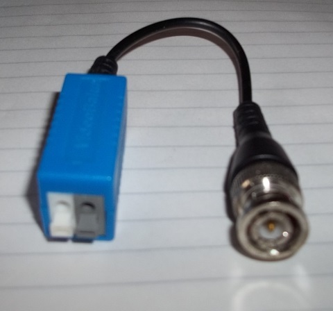

Using a balun to convert from co-ax ( un-balanced ) to twisted pair ( balanced ) you can send video over twisted pair in cables such as CAT 5 and even telephone cable.
There is a small transformer inside the blue box that converts from un-balanced to balanced at the camera. Another balun does the opposite coversion at the other end.
Alarm cable is not made up of twisted pairs so is not really suitable for carrying video signals. That said if there is only one video and smooth DC power in the cable then reasonable quality video may be possible over a short distance if the cable is not close to power cables.
Best to install CAT 5 (or 6) copper cable ( not cheaper CCA Copper Coated Aluminium ).
