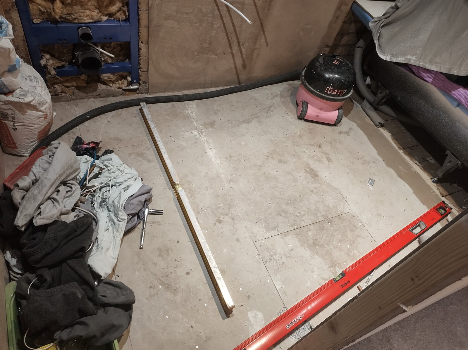

I'm starting with the floor, it's (so far), first floor timber, t&g boards, SBR, flexible adhesive, 6mm cement boards screwed into the adhesive.
The tiles are 600mm porcelain. The floor is out by no more than 4mm over the length of a 1200mm level.

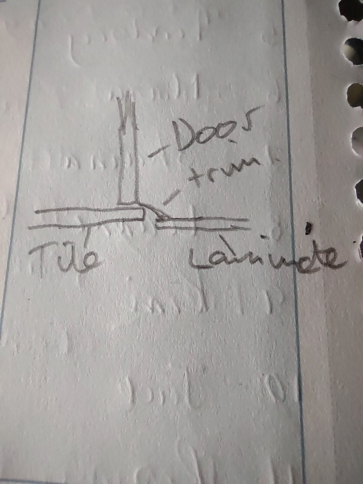

on the general layout, I have plenty of tiles so I'm not having little cuts, but wonder how far into the door opening I should go? I'm thinking they should finish at the outside of the closed door with my transition (from the lower laminate outside) just covering any tile visible from outside?

Only 4mm out over a distance above a meter?

A large trowel would be good, i prefer square to get in the corners, and a sticky consistency in the adhesive, easy to spread but not so simple to pour. Is it a wetroom?
If you have time maybe a dampseal course would help keep things dry underneath the tiles, which i usually give a 3-6mm grout line, depending on pattern or plain.
So 4mm is good! It's not a wet room so I'm not going to try and tank it.
