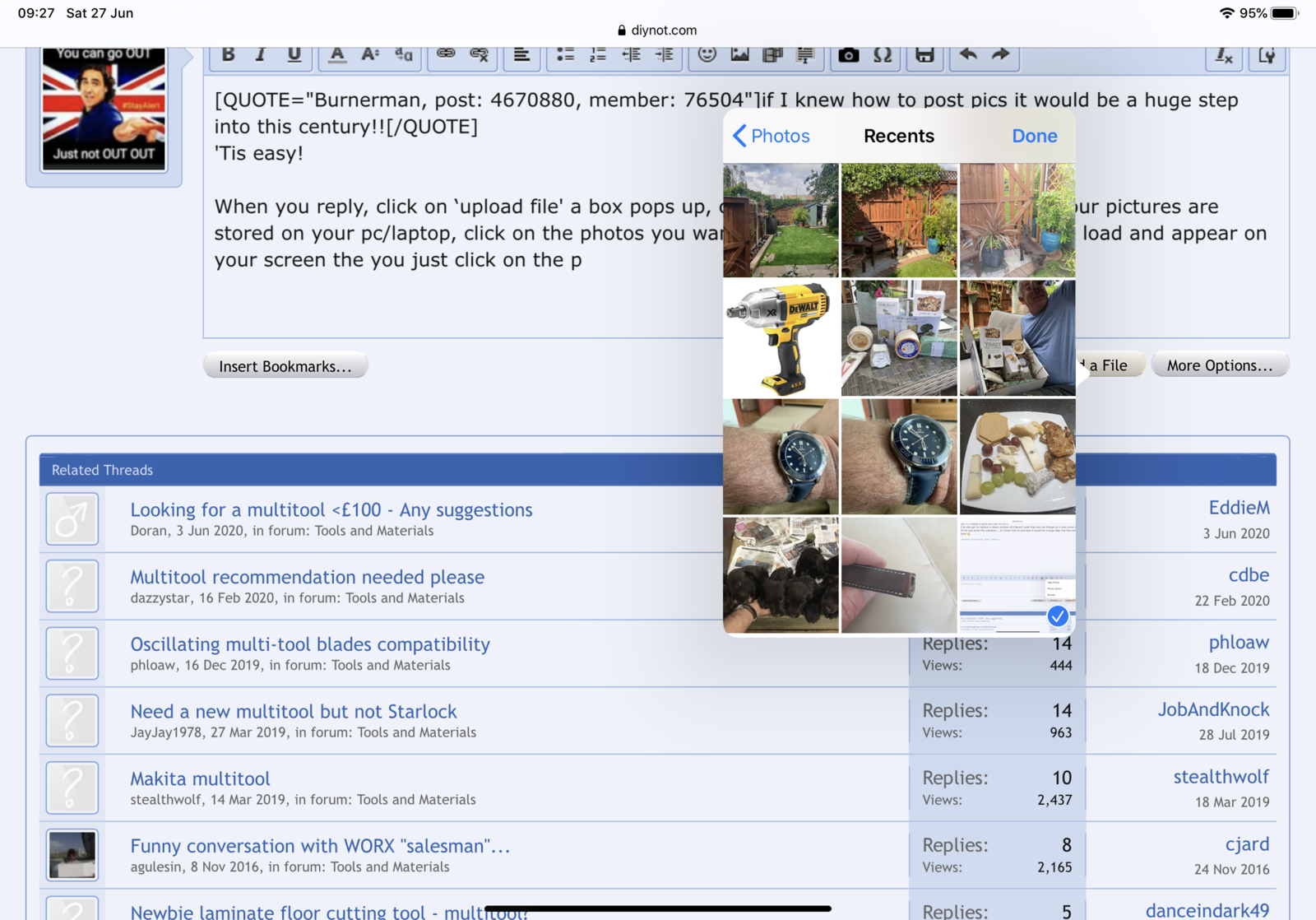

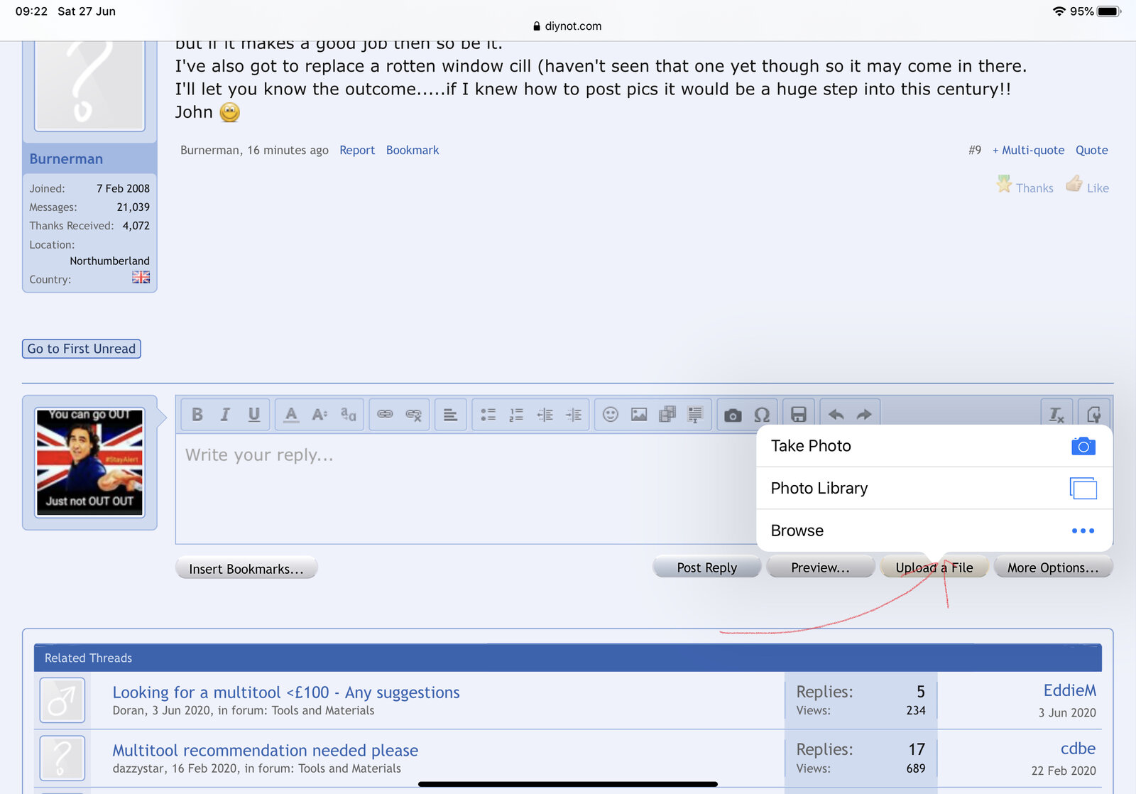

I'll let you know the outcome.....if I knew how to post pics it would be a huge step into this century!!
John :)
'Tis easy!
When you reply, click on ‘upload file' a box pops up, click on 'photo library' or wherever your pictures are stored on your pc/laptop, click on the photos you want, then click 'done'. The pictures will load and appear on your screen the you just click either 'thumbnail' or 'full image' and that is placed into your post wherever the curser is.

Thanks for the advice Mottie, if I can find how to transfer photos from my phone to the lap top I'll maybe give it a go!
