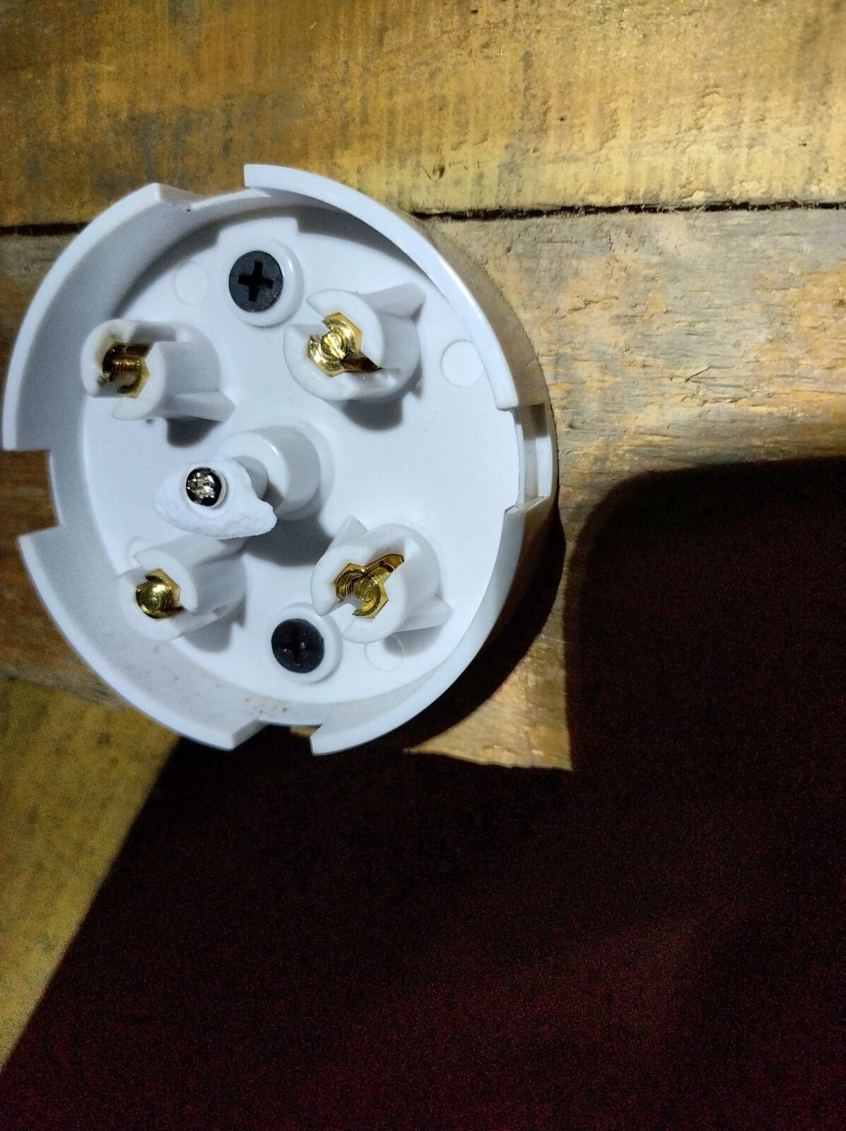

I have a light switch going to one light bulb fitting already in the loft . I'd prefer two lights activated with that one switch.
I understand a new light fitting can either be daisy chained from the last light fixture or a new wire taken from the loft light switch box? Both of these options require sticking two wires into small a pendant light connections or the light switch box connections - which is not ideal and fiddly in a dark loft.
Is there a way I can take the wire from the light switch - split it into two and then connect it to different light fitting so I can have two lights?
Is it possible to do the below?- or does it HAVE to be daisy chained from the previous light or HAVE to be wired direct from the Switch box connection?
If its possible, what Connector will allow the live, neutral and earth to easily and cheaply be split off into two?
This - with the two wires coming out of it of one coming in?
That would be the usual choice. Add another cable from the switch to the new light.
No real problem with it either, it just means 2 wires into the L switch terminal, 3 neutrals in a Wago connector or similar, and 3 protective conductors in another one.
No need for any extra boxes, just a couple of 3 way connectors to go in the switch box. You could even use those screw terminal strip connectors instead.
one of these is all you need
at the position where it says connector
Hiya, now you would think that, but I tried - one wire from the switch, one to the light 1 and the other to light 2 - but getting 3 stacks of neutral, brown and earth into three of those slots and the grub screw closed - ain't happening (unless that isn't what you are supposed to do)?

Just didn't think I could run one wire from the switch and then split it - as that wire would be carrying the load for two lights (and that isn't the way ur supposed to do it?).
I could get it wired up outside of the loft and then just take it up. If I did that, how could I test it? - connect the wire into the switch with a plug and stick in the mains - would that be okay? - or are lighting circuits lower amp and I could blow the lights?
There is no difference between splitting the cable from the switch to the first light and daisy chaining a second from the first

Cause then there are three wires to accomodate into the switch and its cram to get the box closed without something moving inside and a right royal pain to get three copper wires to connect into each earth, neutral, live connection of the switch box - let alone try and closing it after.
makes senese to wire it up outside of the loft. also these batten lights are a pain to fix and get the clips straight, so plan is to stick it onto a wood peice and then just screw that wood onto the loft beam when in the loft.
Any easy way of testing the lighting rig prior to going back into the loft? Can I plug it into the mains plug or do I have to use a lighting connection to test it?
A lighting circuit should be protected by a 6 A or 10 A MCB or a 5 A fuse. The cables used for lighting circuits are good for much more than that (17 A if 1 mm2 if I remember correctly).
Why do you think one cable shouldn‘t supply two lights then? The fuse or MCB limit the current long before the cable gets overloaded and that‘s why they‘re there.
