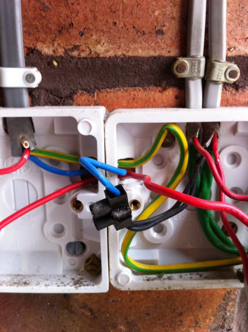

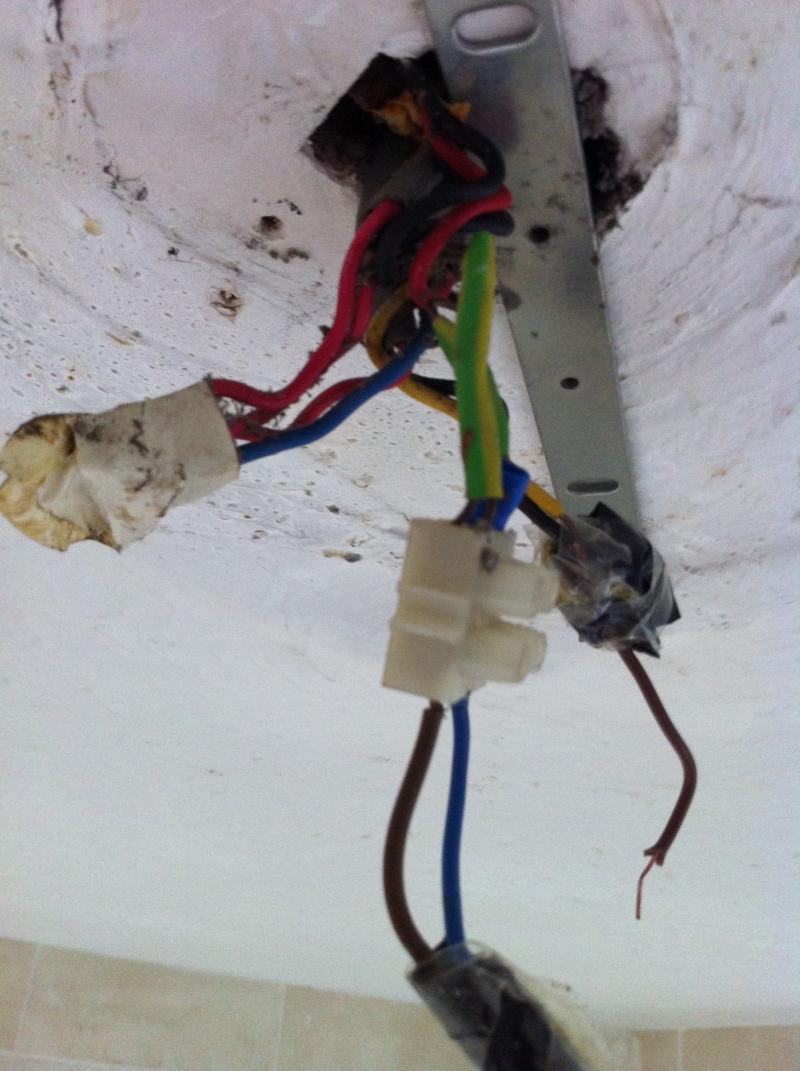

Here's some to keep you amused until Rob comes along with something more entertaining:-
The laws of physics obviously don't apply to lighting manufacturers !

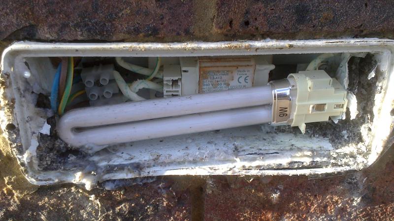

Brick light after four years of use

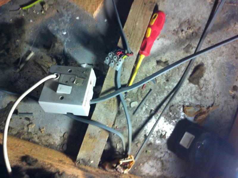

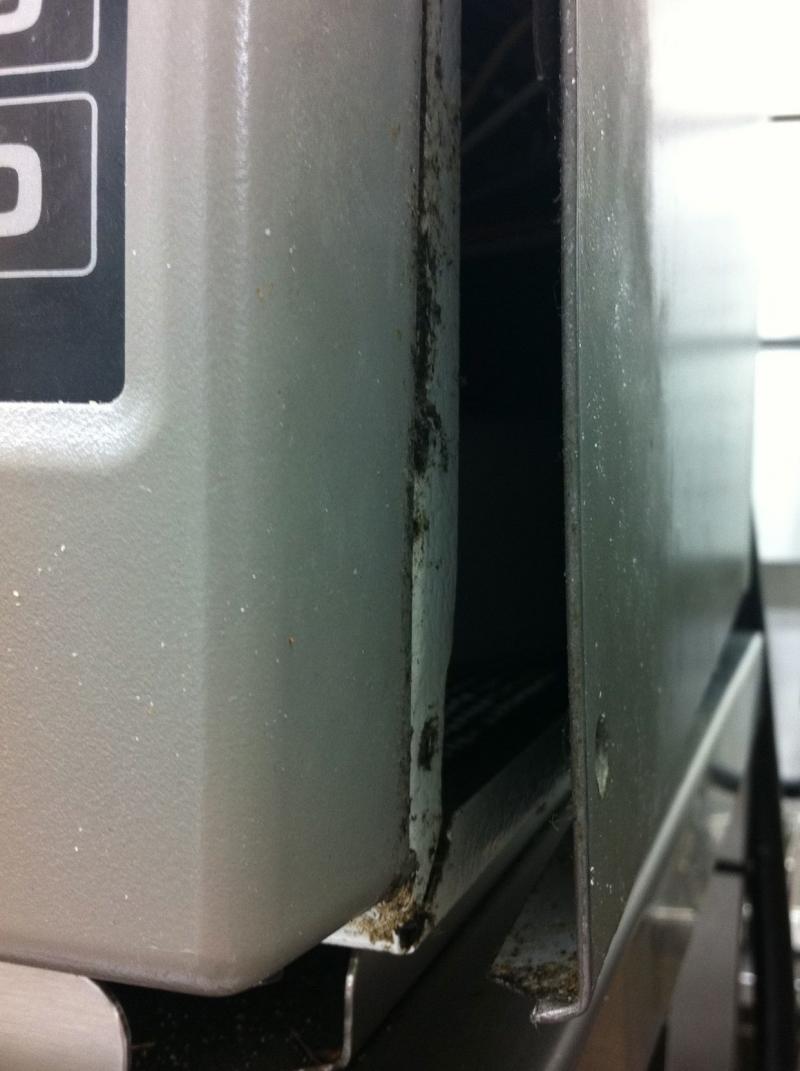

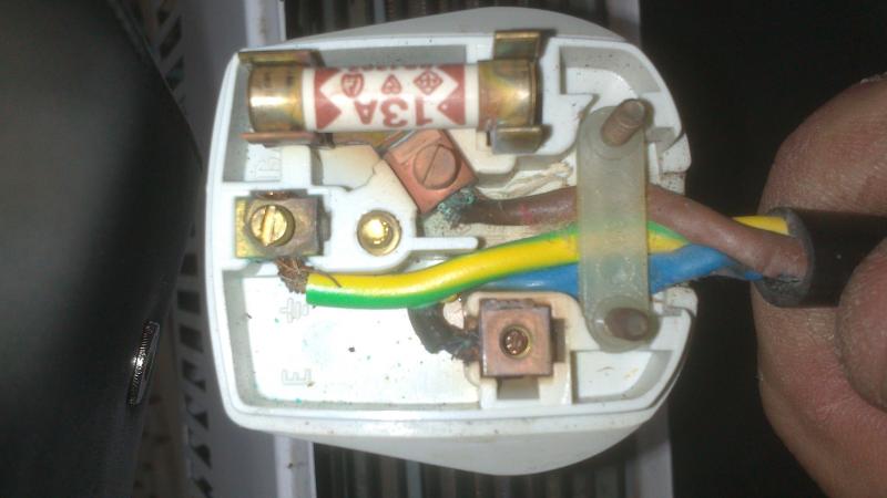

One of the directors asks me why his fan heater is causing problems

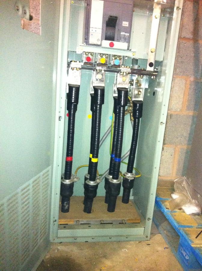

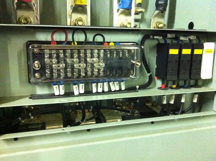

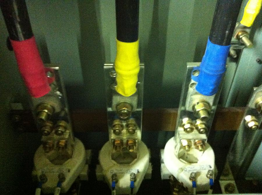

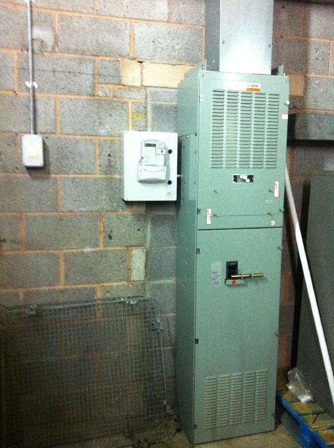

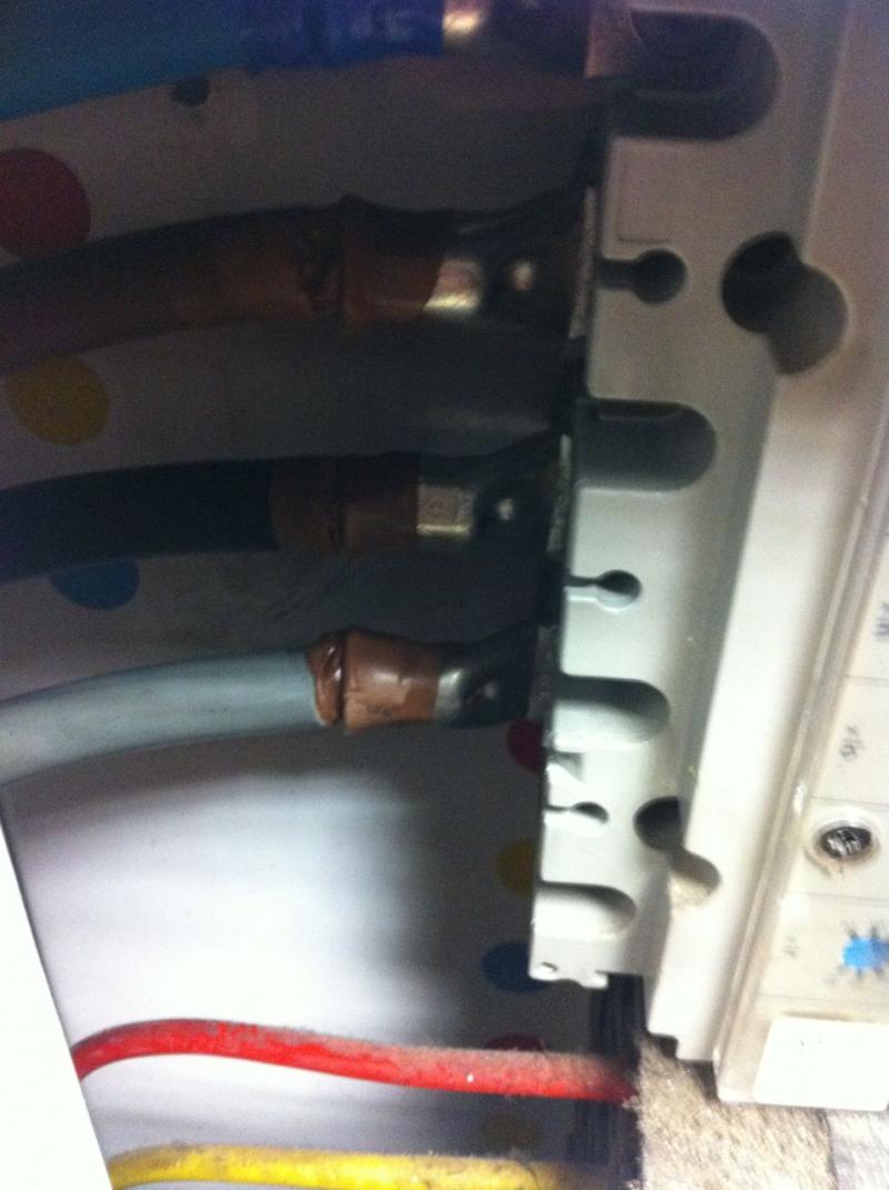

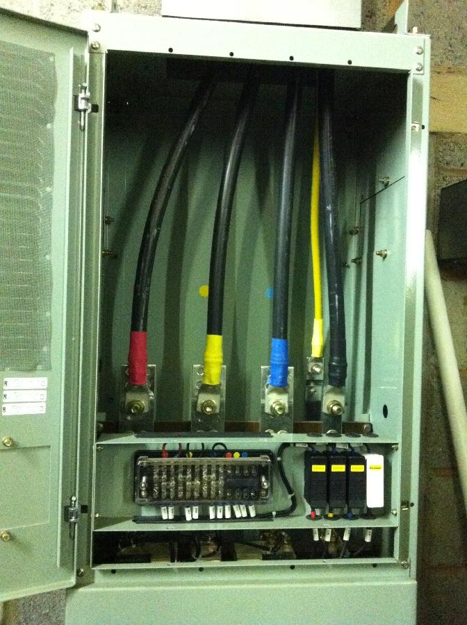

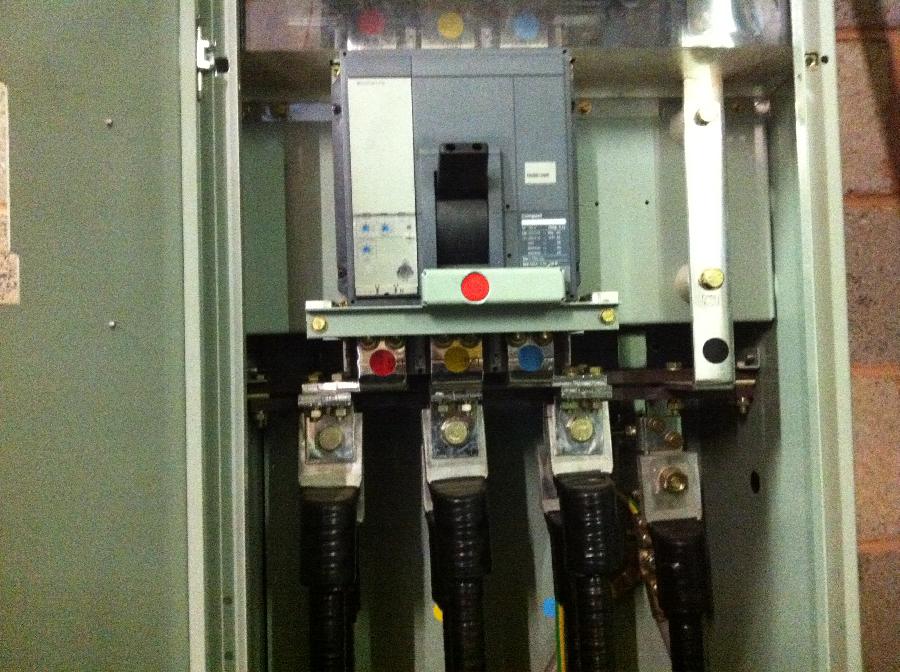

Recent alterations to a site due to 800kW, 11kV turbine install.
1200amp capacity supply, but fused at 630amps currently, which is ample.

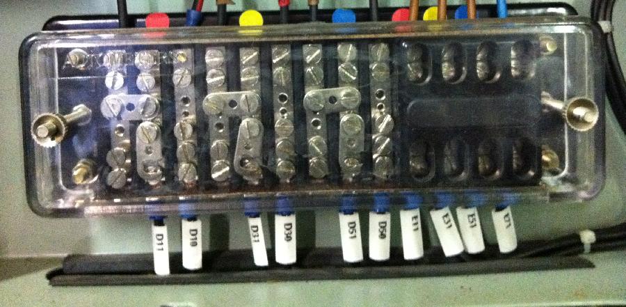

Old LV CT metering removed, but DNO incomer, CT's and service cables adopted and now under our control. Site now has HV metering and two HV RMU's, one feeding the turbine and one the sites new tranny. One DNO meter, one generation meter and now a site consumption meter to check calculations which I installed yesterday. Difficult to get pics of the HV kit as when your inside the GRP enclosure there is little space to take photos!

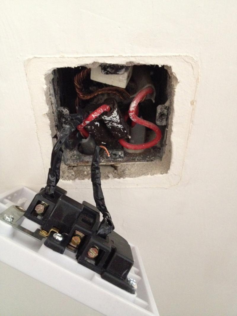

Tidiest socket outlet I've ever seen

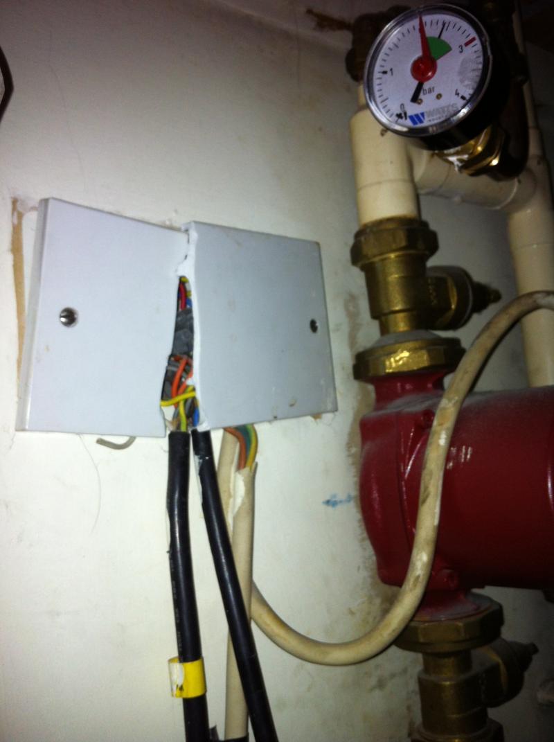

Closely followed by this beauty

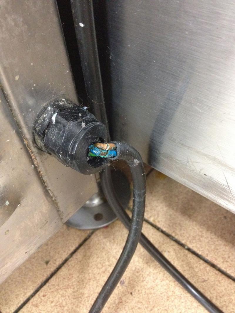

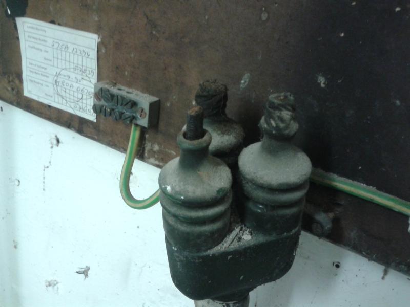

In-Service piece of equipment......
