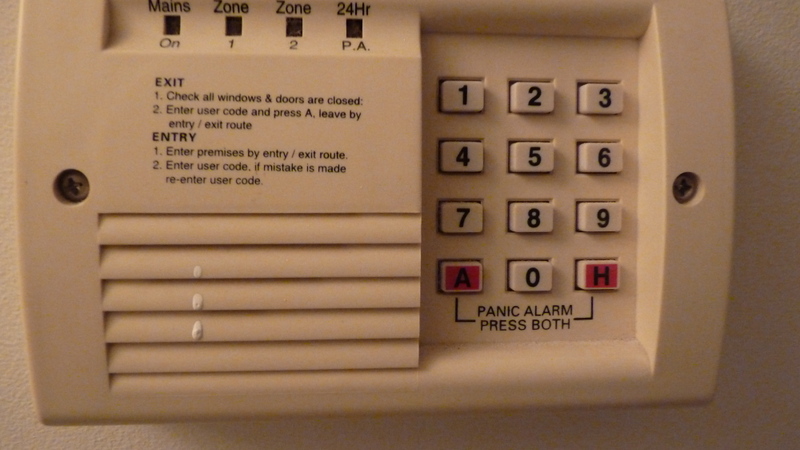

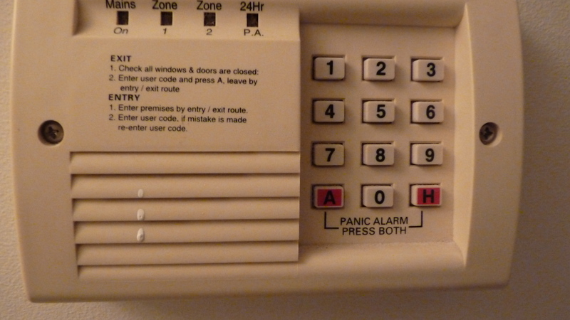

IMG_1685.PNG Post a picture of your alarm panel

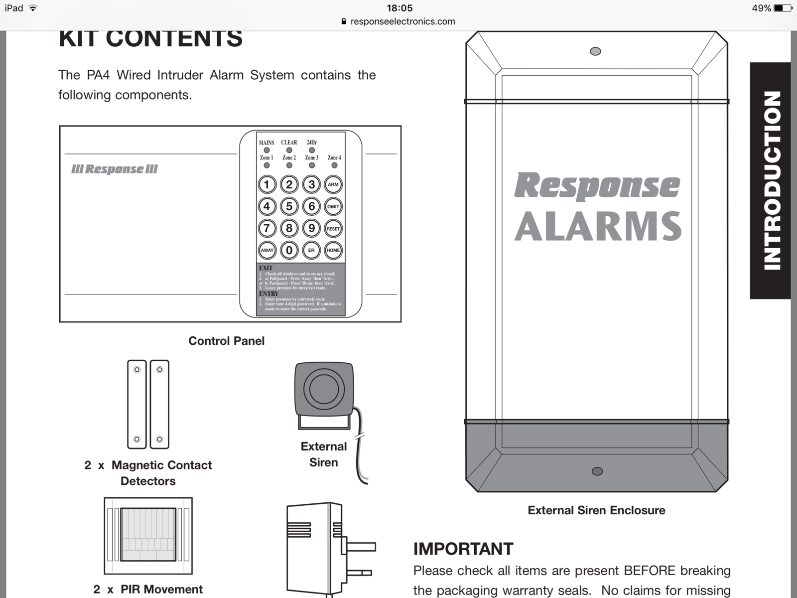

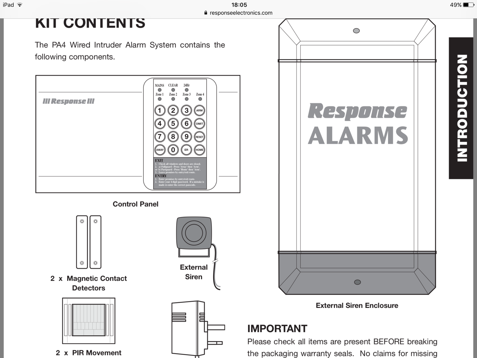

Does it look like this ?
It looks very like that one which is the Response Alarms version. Are they still in business I wonder. The external siren enclosure picture is exactly like the one I am looking for, thanks. I checked their website, their new B&Q ones look very different but I've emailed Response to check for a fit. Thanks again for your help.

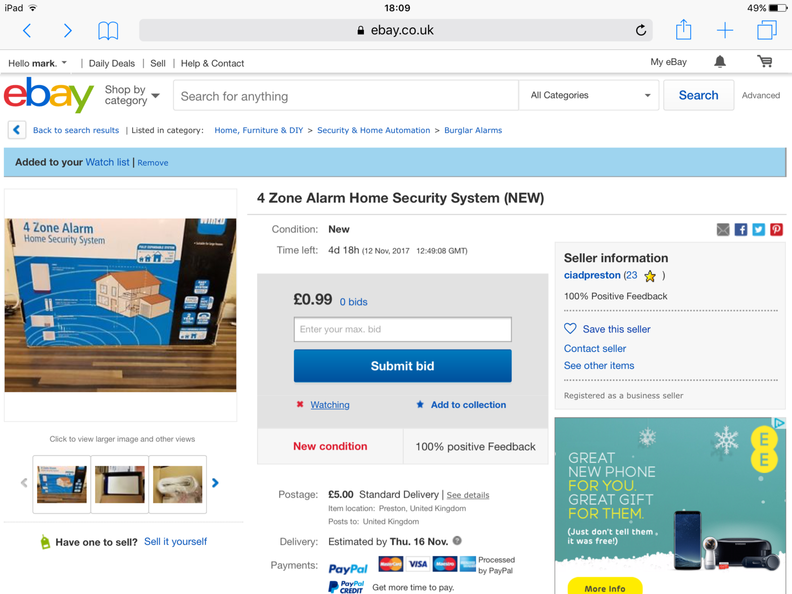

Thanks a million. What I need is the 2 zone version of this one. The box is different on the 4 zone shown as it doesn't have the wall fixing holes on the front so it must have a backplate. It has however narrowed down my search on EBay & elsewhere. Thank you for all your help.
