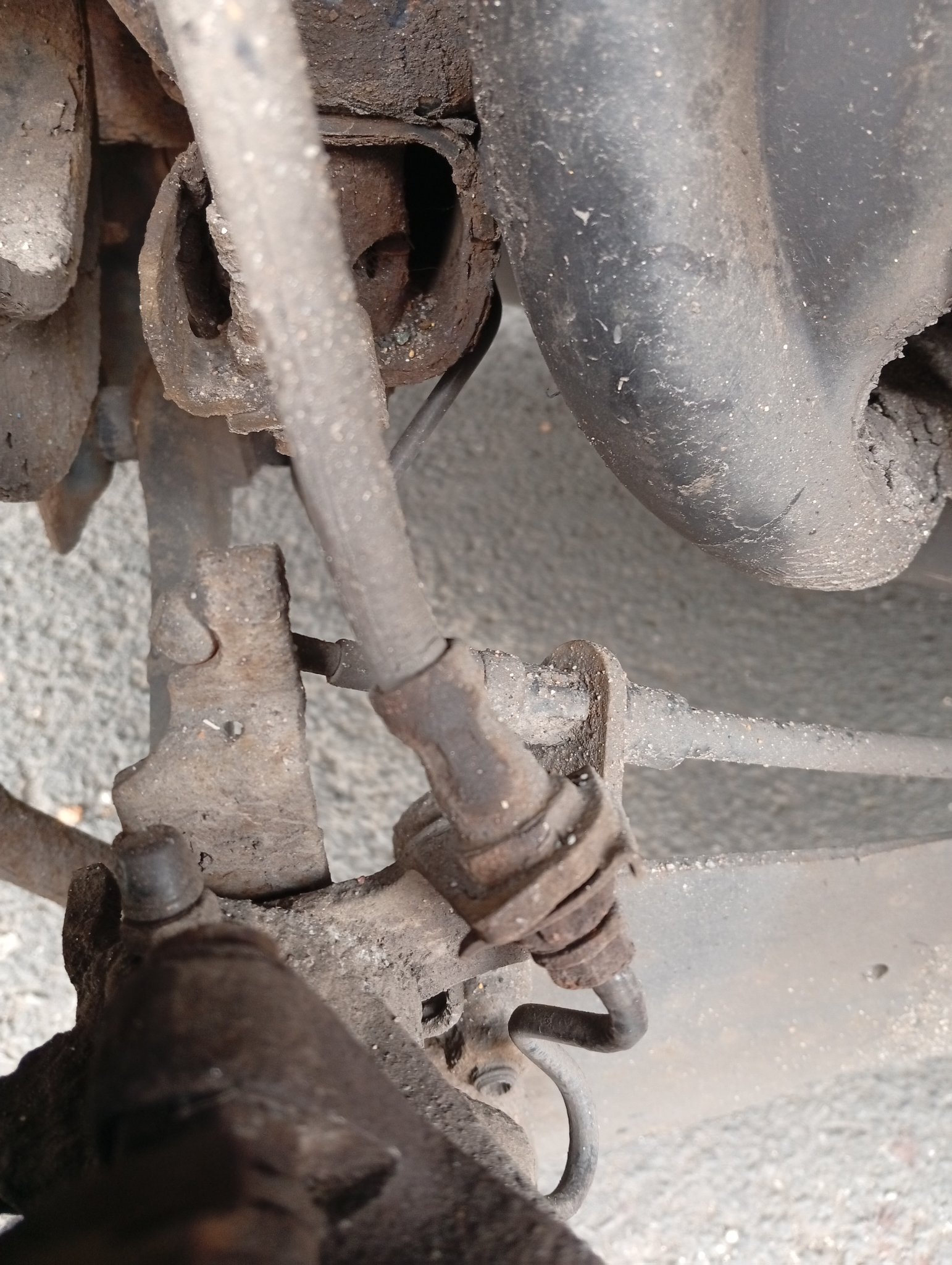

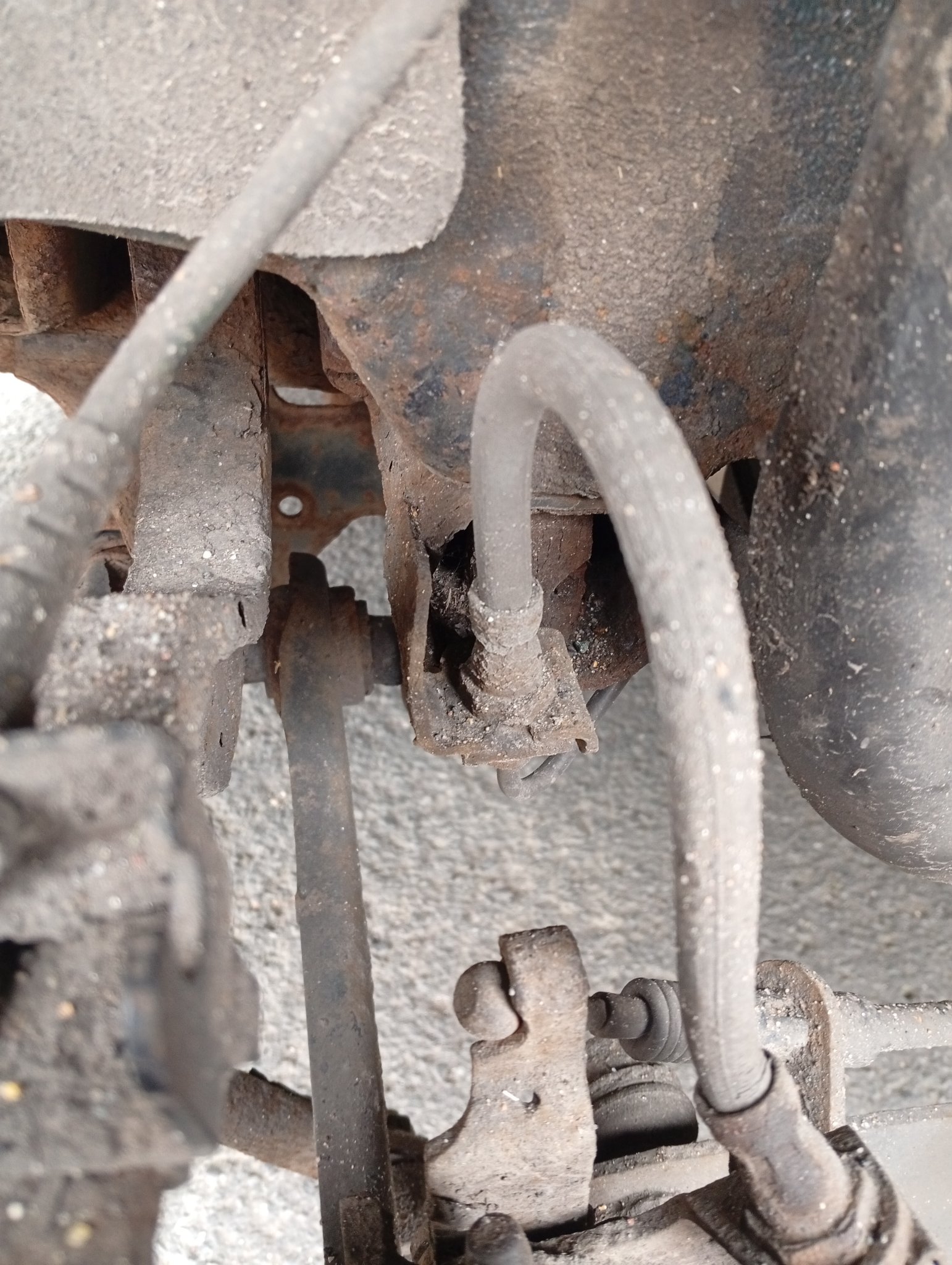

Hi everyone, I am about to attack this task on Saturday because both calipers are totally seized and I got new ones cheap from GSF (£30 Febi).
Done this before on other cars, but this is well rusty, anything in particular I should make sure I do?
I'm a bit concerned about the hoses bolt that looks very rusty.
Any advice on removing them safely?

Those pipes shouldn’t really be much of a problem. A drop of penetrating fluid on them and use a pipe spanner on the nuts. Jiggle the nuts back and forth as you are loosening them instead of one steady pull and they should undo pretty easy.
A quality pipe spanner is a good move.......I have a Halfords Professional one, nice wall thickness etc.
On difficult pipes I've used Mole grips if the spanner jaws had a tendency to spread.
Curious - I thought these cars had a banjo bolt system on the rears!
John :)
Give it a good soaking in Plus Gas before you start then grab a cuppa to give it time to soak in.
They are normally pretty good but sometimes the nut on the brake pipe can seize, be careful because if that`s the case it can shear the pipe.
Wire brush it all as best you can and apply penetrating fluid, yours don`t look too bad to be fair.
A bit of heat can be used if hoses/calipers are being replaced but just take care.
