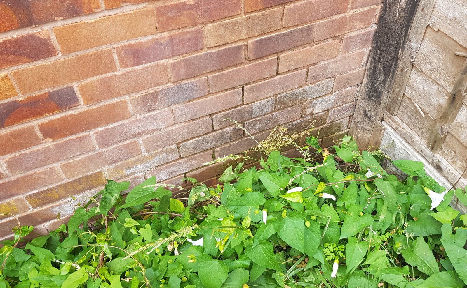

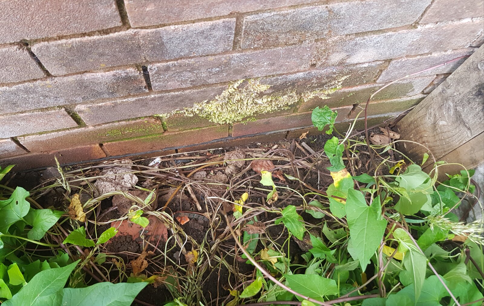

About to start garage conversion, but found a puddle of water?

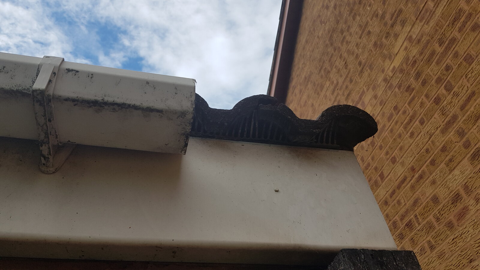

This was the cause of the damp in the first place. No gutter to catch rain water causing it to trickle down exterior wall and soak mud. The downpipe is still draining into the mud but its catching all roof water now.
