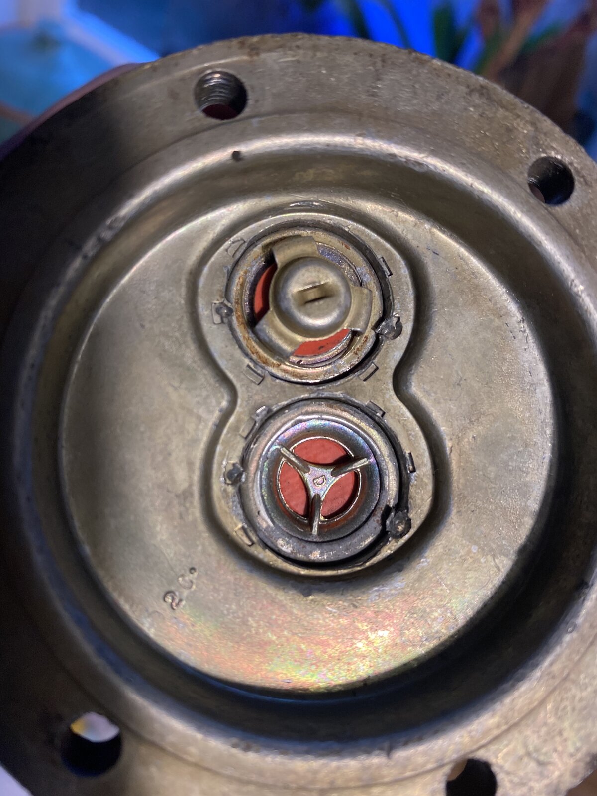

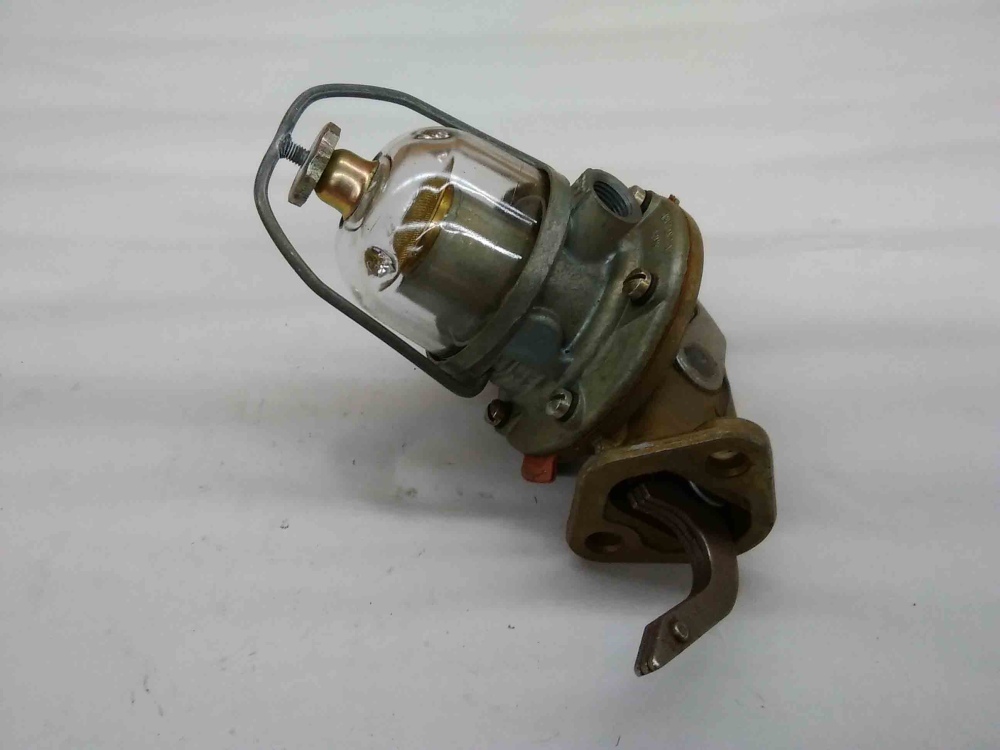

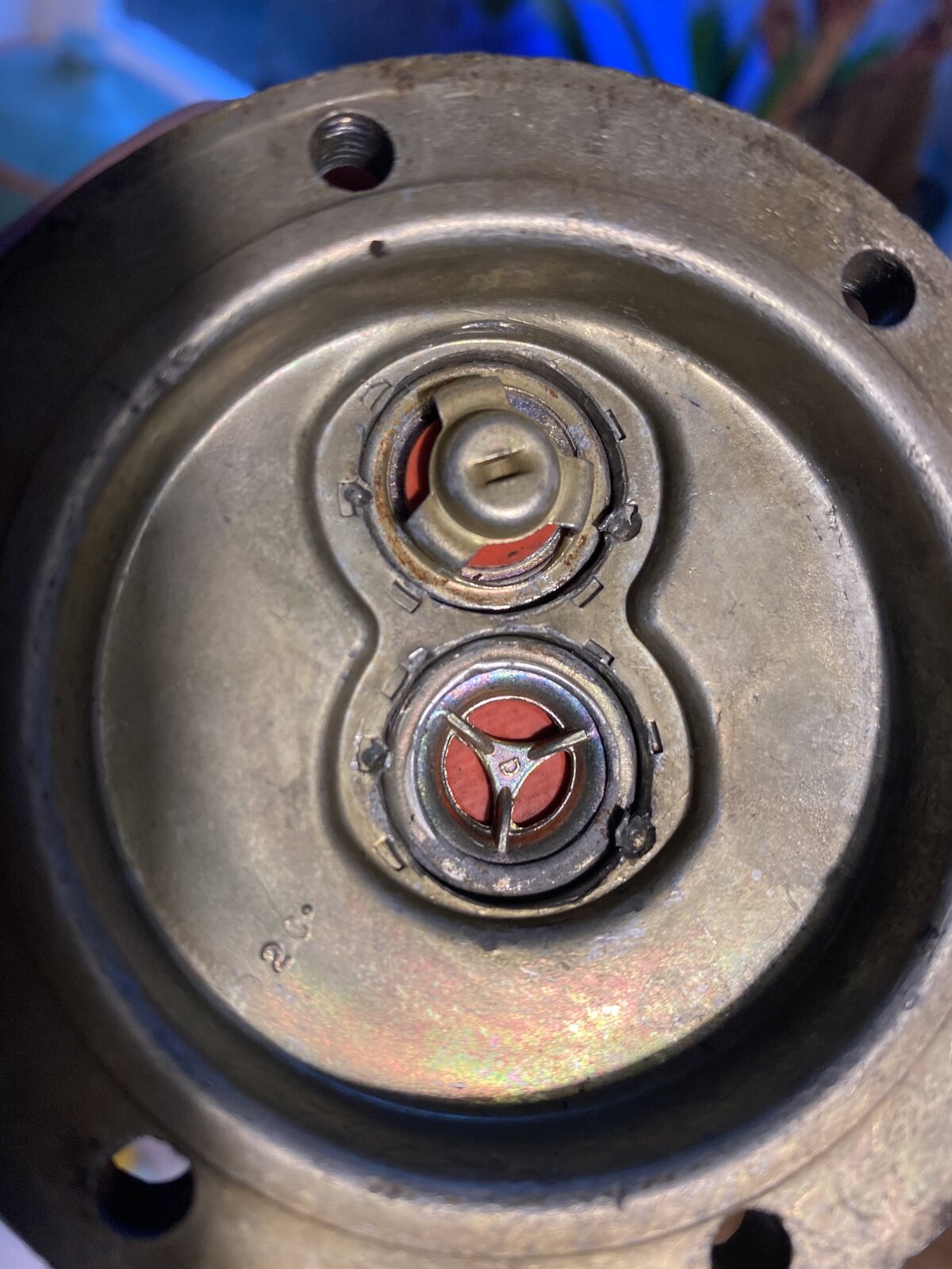

I am suffering from fuel drain back to the tank on an older car which uses a mechanical fuel pump, it's the glass bowl type one as seen in the attached image. Fuel is also leaking into the oil through the diaphragm, so the whole thing needs refurbing.
The car is used weekly and each Friday the fuel has drained back to the tank, which makes it a pain starting as there's no manual lift pump (primer). I don't mind cranking a bit to build up oil pressure, but sitting there 10-20 seconds is causing premature wear on the battery and starter each week.
I have decided to rebuild the pump which should be fairly straightforward, however I'm not sure how to get the check valves out of the pump housing. They are apparently 'peened' into place using a suitably-sized socket and then a punch to bend metal over the top of them to hold them in place.
How would I go about 'un-peening' them and then 're-peening' them into place? Anybody here still know how to maintain these? Annoyingly, the later pumps (with a the manual primer) used a plate held in with screws to secure these valves which would be much easier!

I'm not sure it would be any help to you, if you could get those valves out - you will not be able to repair/service those, or buy replacements. I half remember replacing those valves on one where they were not peened in place. I think your only way forward, is to seek a complete replacement.
Aha, traditional engineering :love:
The best way to remove peins is to grind them away - with great care! Out with the Dremel.
If you can get new flap valves (Rimmer Bros maybe? you could replace them, and then pein them in place with a very sharp centre punch.
As Harry says though, a new pump is by far the easiest way.

I should have said, I have a rebuild kit which includes all the gaskets, rubbers, etc.! This kit does include two new valves which I know do fit this pump (some are 0.014" too small in diameter and there are plenty of them still out there.
I've seen a new pump at £90 and I'll admit it's probably easier, but I'd rather service and maintain the original. I'll try the Dremel with a fine head on it to grind it away gently.

You can see the extra metal that holds those valves in place. Just turn them back to align with the housing using a pair of pliers. Those pumps are about £25 from places like Rimmers, Davind Manners etc. Make sure the seats are clean before replacing. Mended one on a Spitfire at the side of the road in about 30 minutes.
I saw the protruding metal, I will remove this with a Dremel or Stanley blade.

You dont need to remove the metal, just ease it back so the valve can pop out.
Thank you, I will inspect it on the bench at the weekend and look at doing this. I do want to give it a go to maintain originality and just for the achievement factor.
Rimmer Bros. have actually got back to me and said they don't stock any Rootes stuff, but the one in your link looks right -- thanks for sharing that. If it goes t'ts up with the valves, I'll go with the new pump and just carry a spare old one (along with the points, plugs, etc. that we all carry!)
