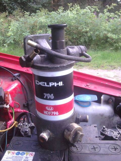

Found a picture of the rare beast! (Link below)
It's a 3 part sandwich.
Bottom half features in/out coolant pipes for pre-heating the fuel. A water-in-fuel sensor, and water drain plug.
Top half has the fuel in/out pipes, air bleed screw, and centre bolt that holds it all together.
The ''black hat" primer at the very top, leaks fuel out when pumping. Making me think that a seal has gone in the plunger, ultimately over time, causing air to get into the fuel filter, which is affecting fuel pressure and causing starvation.

Thanks for the photo - its the CAV type with a water pre-heater and an electrical connection to sense water in the filter bowl, as you say. Some 205's had the pre heater on the back of the block, offside but I guess yours is the later version which also served the turbo model.
Anyway, your diagnosis is absolutely correct, air is entering the fuel system and causing the problems you describe. When you press the plunger, there should be no leaks, and fuel/air is bled off at the nipple on the injection pump.
Hopefully there will be a replacement somewhere - new, old stock perhaps.....but the Ford replacement would do but you would lose the pre heat and water sensing facility I guess. The engine would cope perfectly well anyway without these.
The XUD7 engine was a brilliant design, long lasting and responded to a turbocharger very well....years ahead of its time.

The C25 filter would do very well, and elements wouldn't be an issue.....depending if the banjo threads were the same of course (and they should be).
The rubber bellows type (before the filter) work well too but sometimes they leak, sometimes the one way valve doesn't!
If you can't use the preheater, just join the pipes with a length of copper tube and jubilee clips and ignore the electrical water sensor connection.
John :)
Popped an O-ring over the shaft of the primer, which is clamped down between top hat and the metal tube. Then put a rubber glove over the lot, and that's worked for now! Still ****ing out fuel when priming, but got me through a 500 mile round trip over the weekend without any further intervention.
