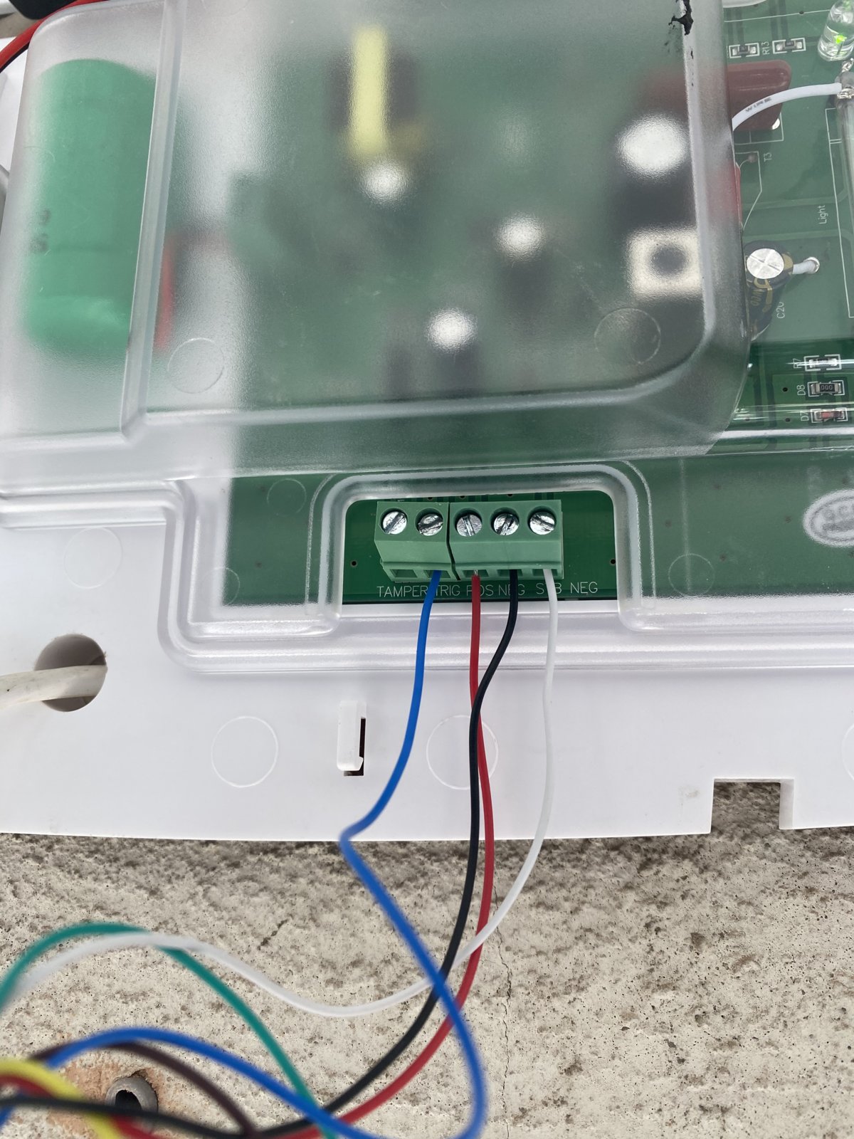

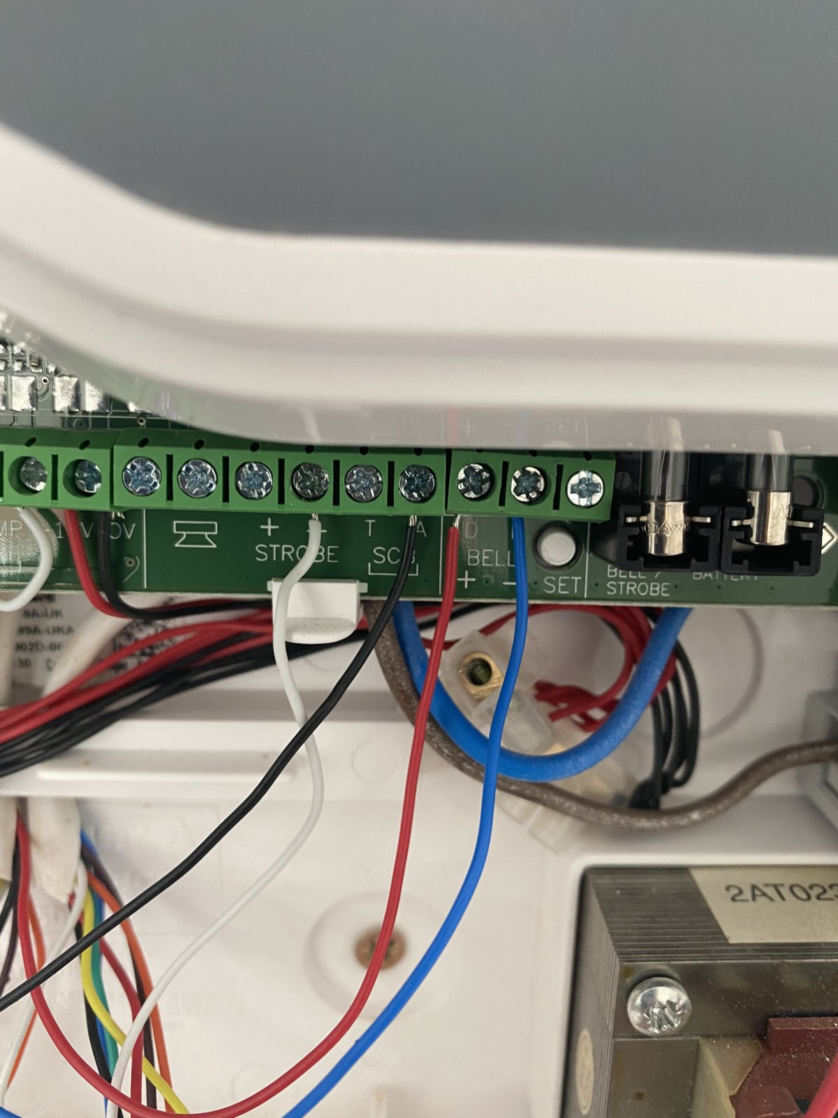

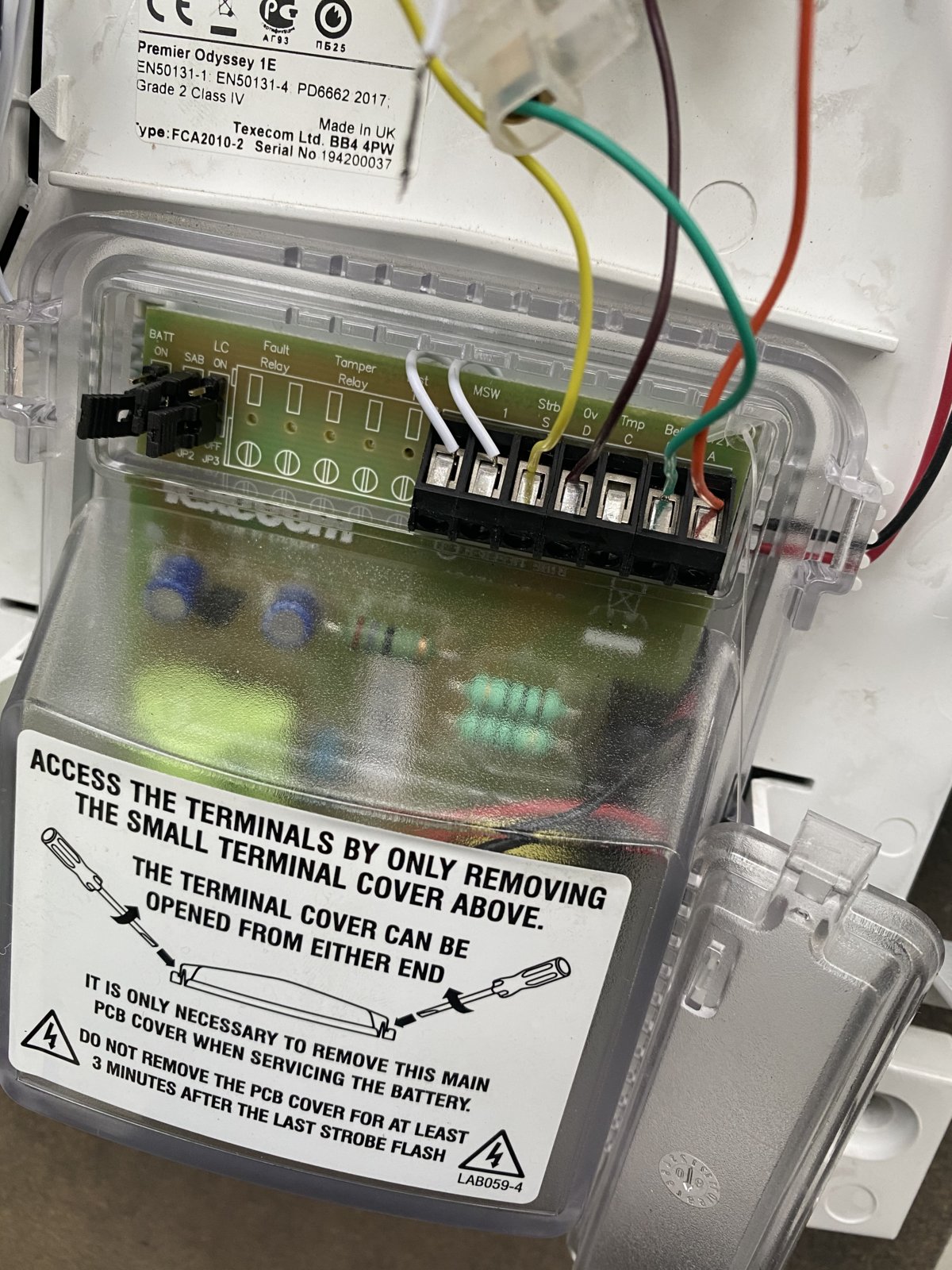

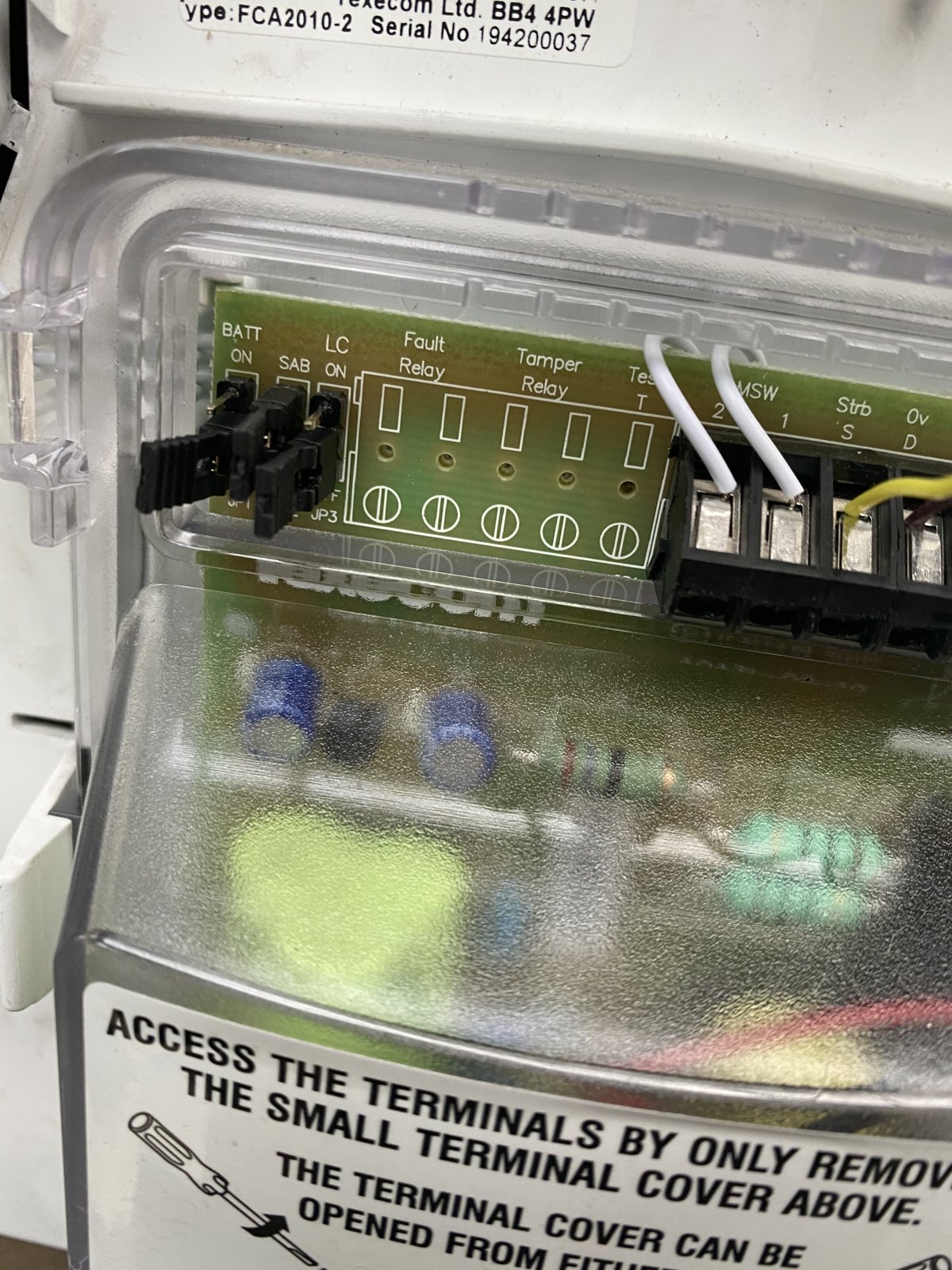

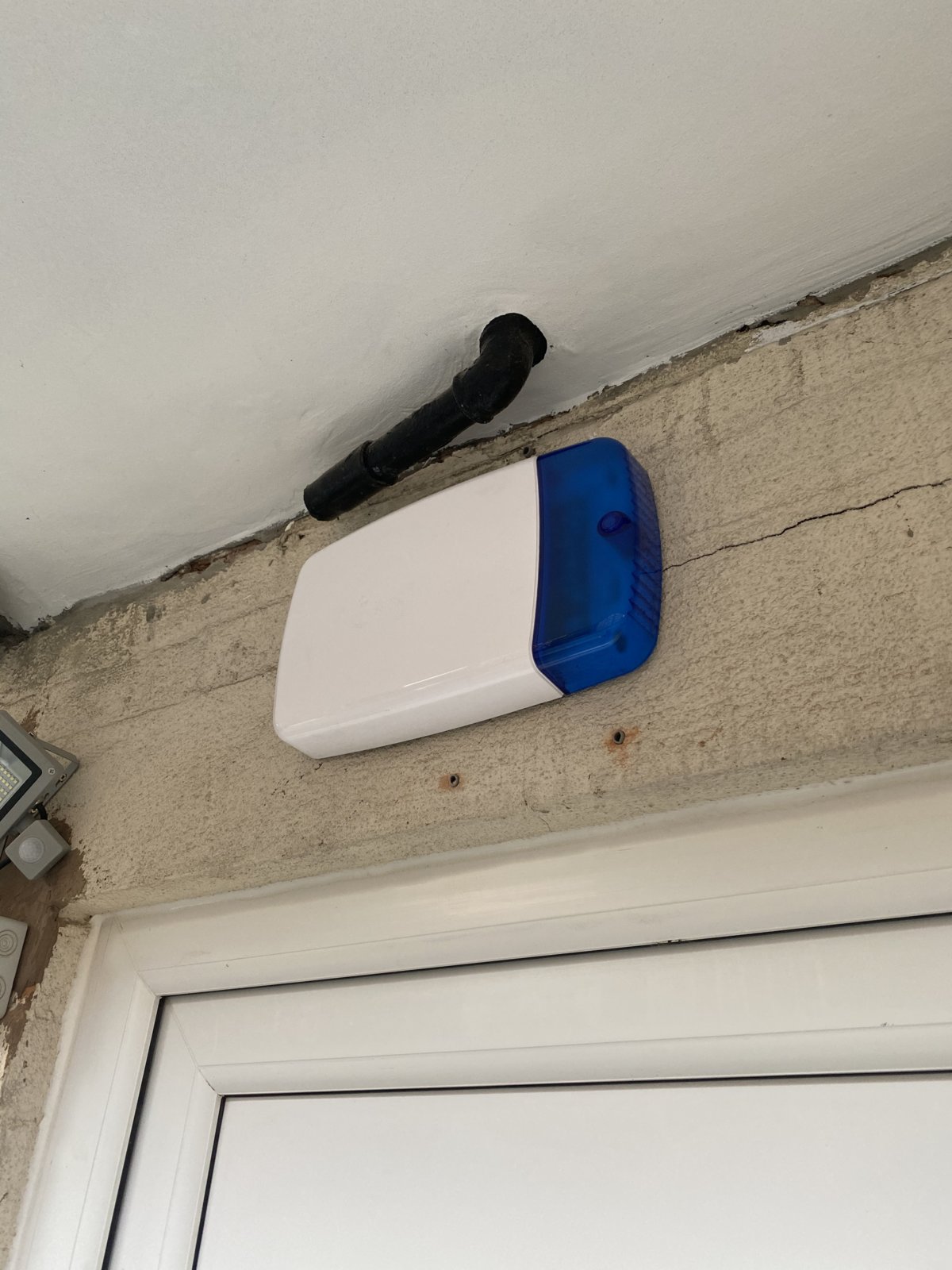

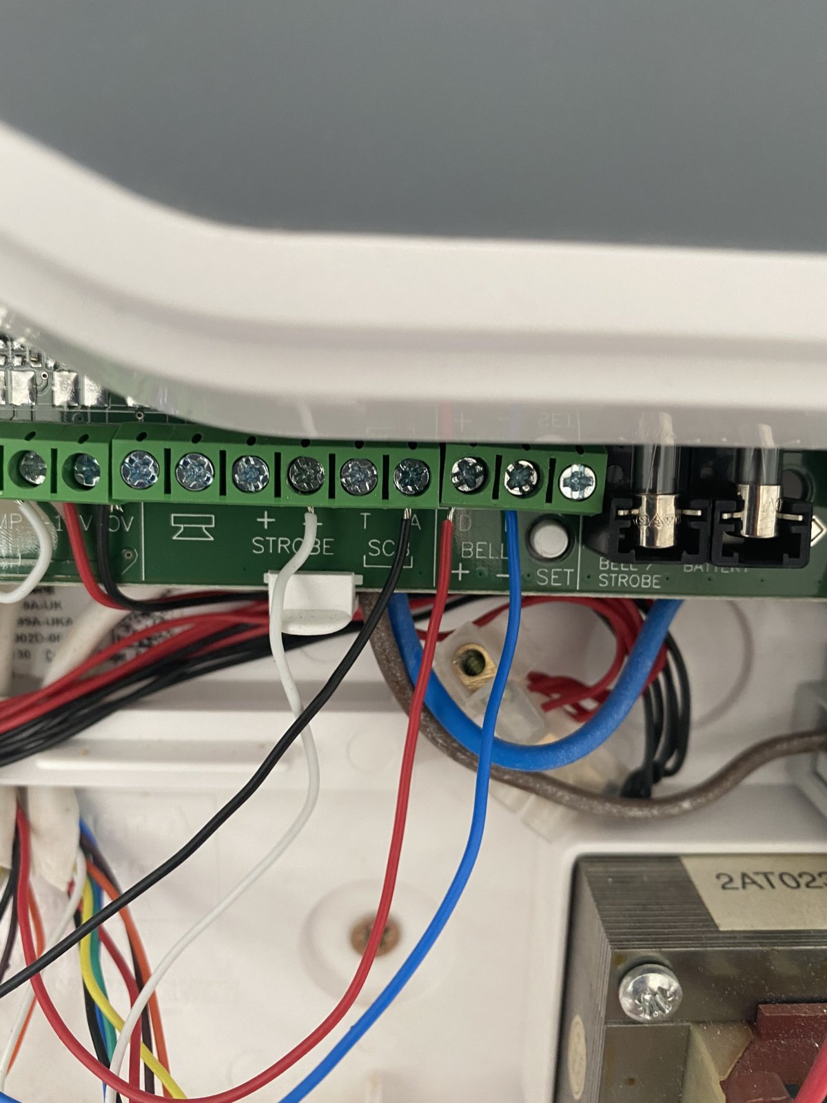

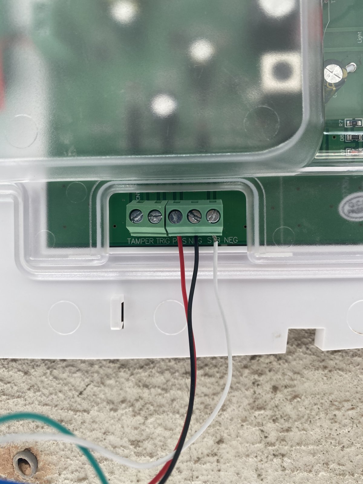

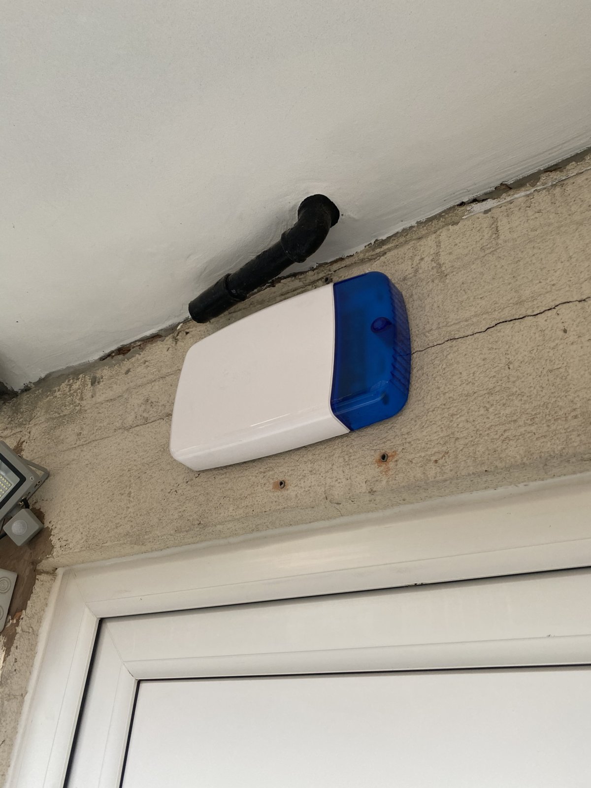

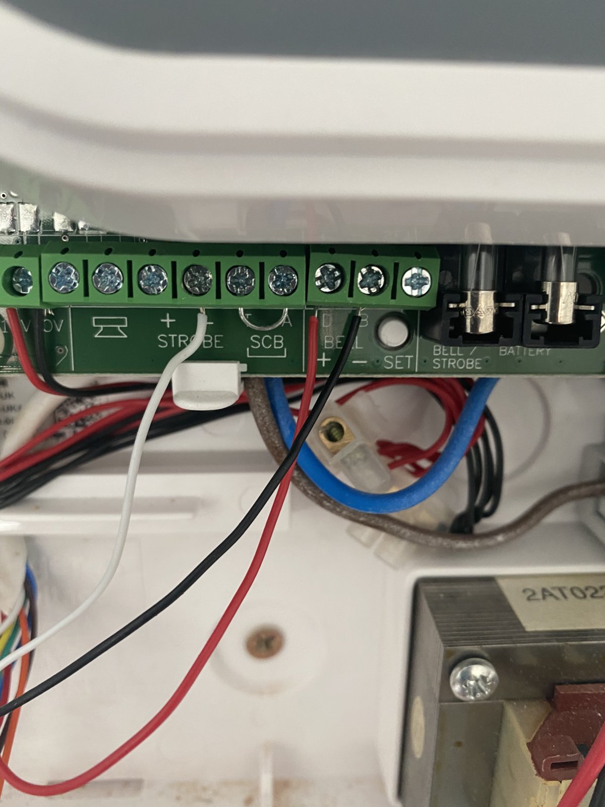

Evening all. I need some help trying to install two alarm bell boxes please both bell boxes are different brands and both cables are going to the panel where I think made a mistake.

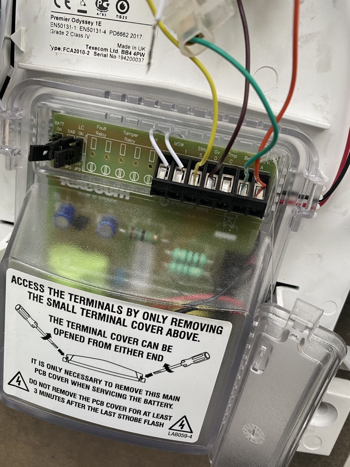

The first 2 pictures of the bell box is a Odyssey and I have attempted to install but can not get the bell box to operate.
And the third picture I could not open but I have attached a pic of the bell box cover I hope this helps.
Can someone just tell me what to do so the alarm has lights flashing and the bell box external sounds sounds. I am not fussed about the tamper etc because It’s a flat.
Thank you all

mixing brands makes it more confusing.
best bet is to post picture of the panel wired for the bell box's, and the two pcbs of the bell box's.
looks like the two internal bell box pictures are of an Odyssey E

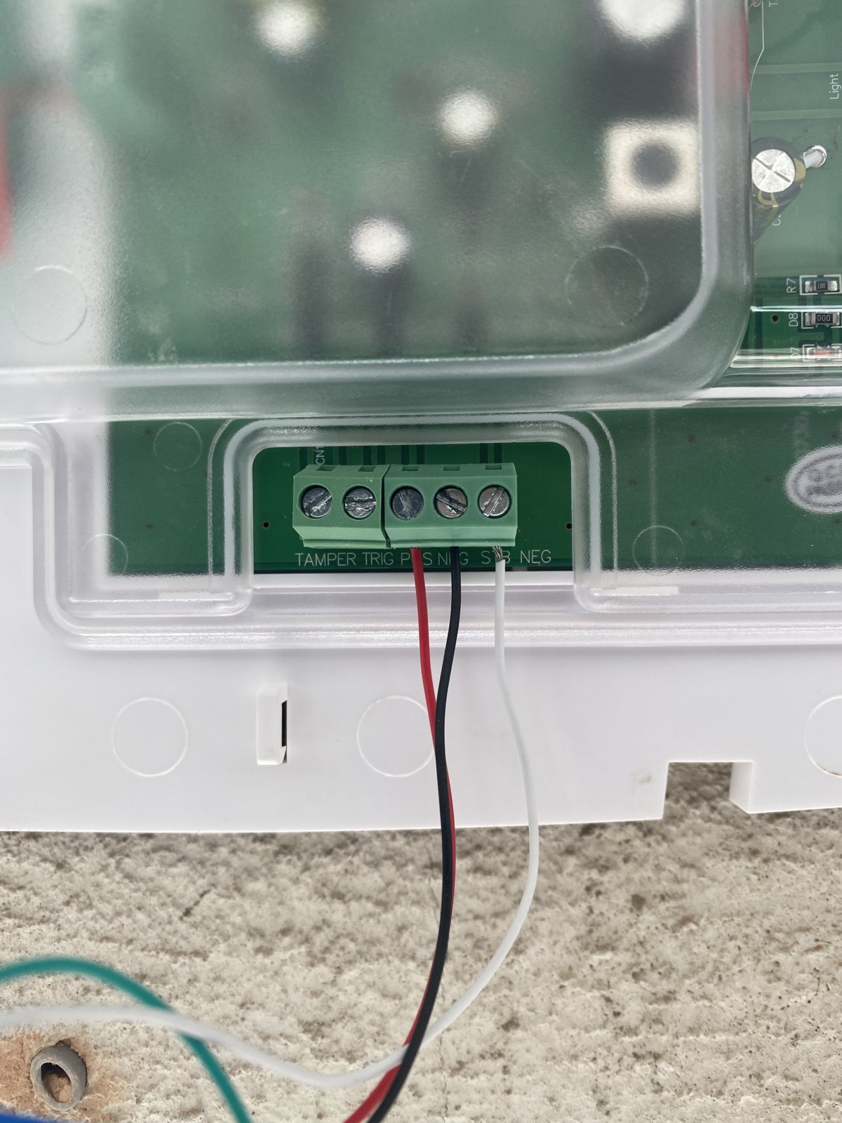

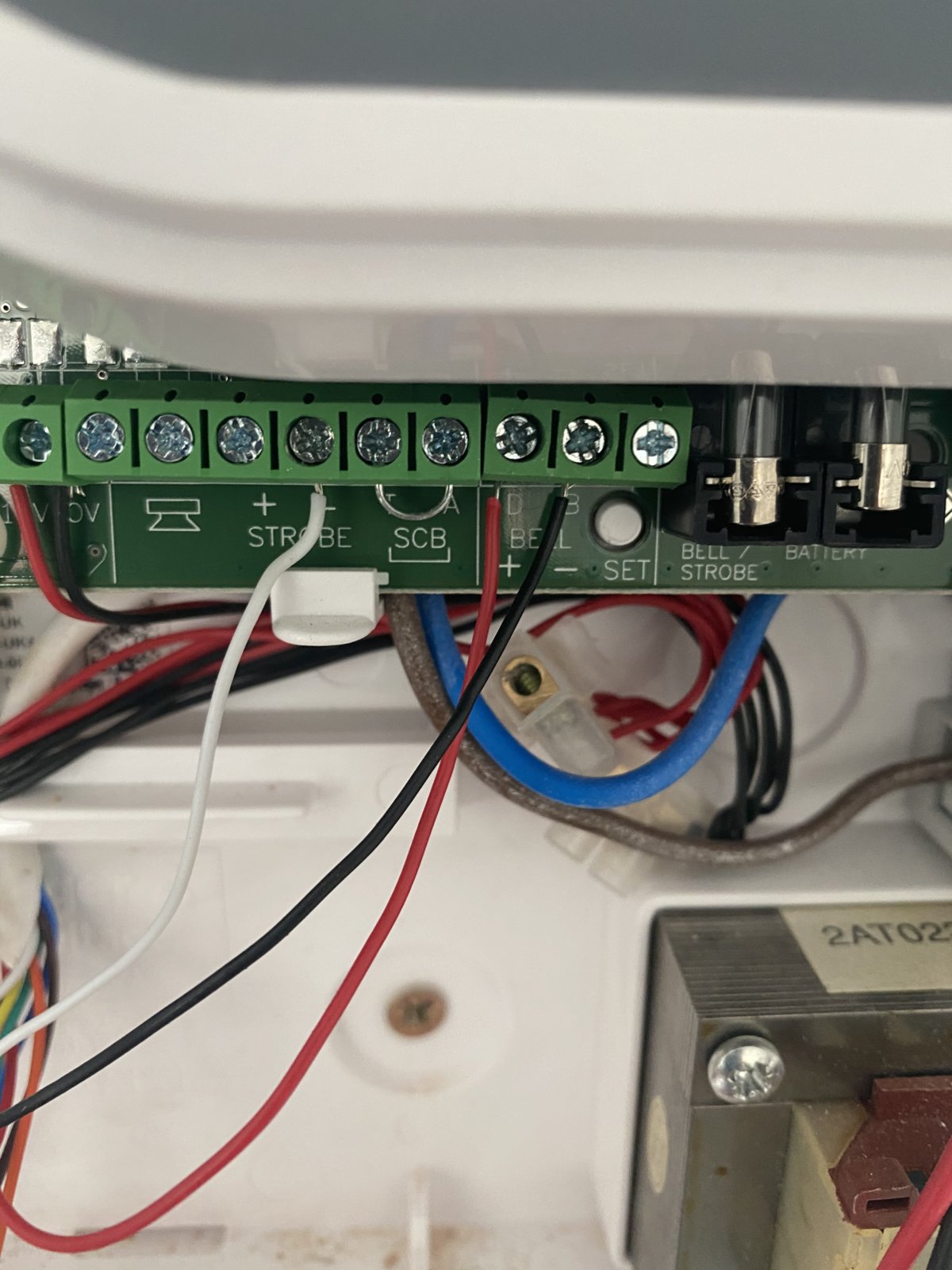

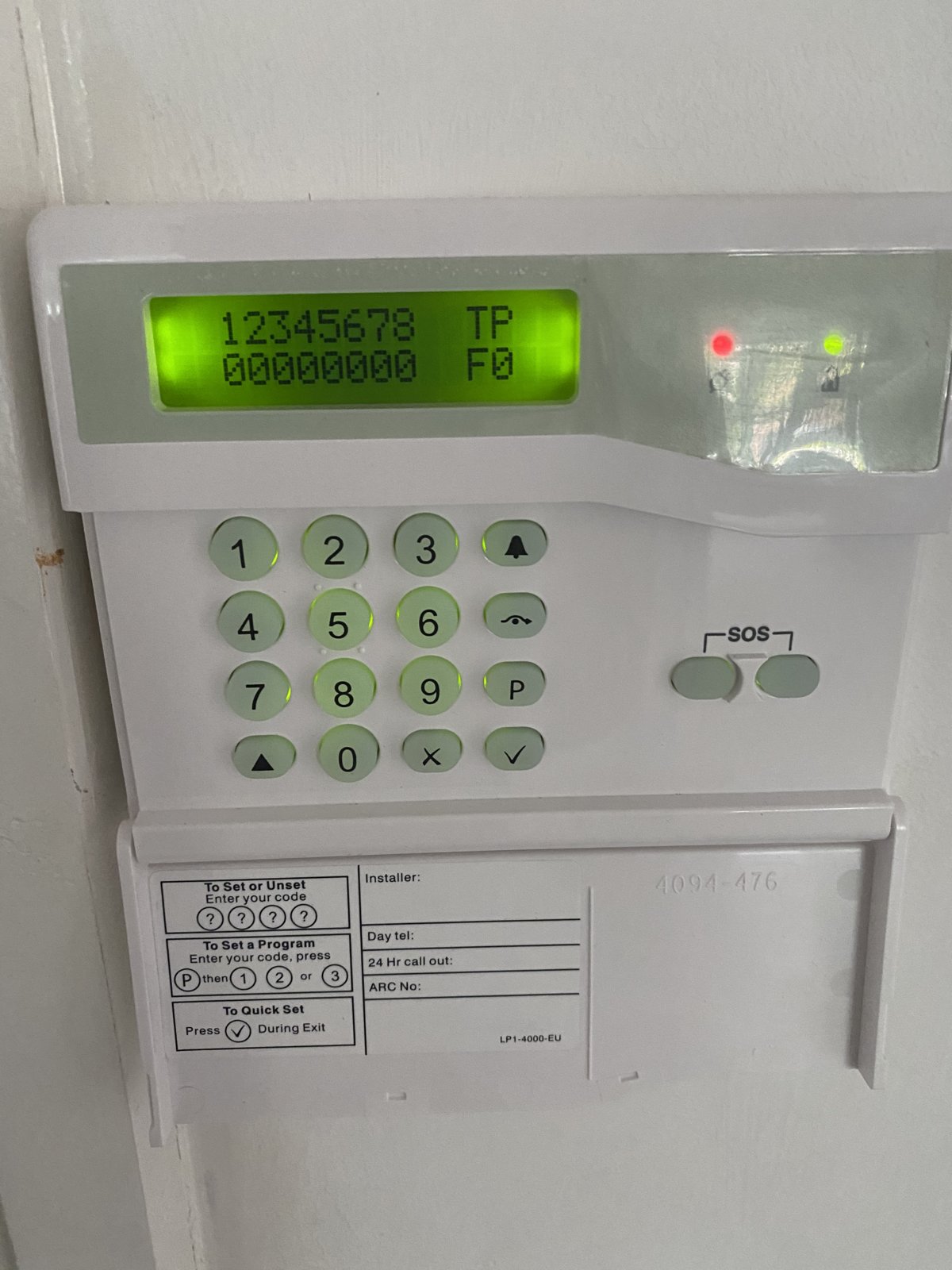

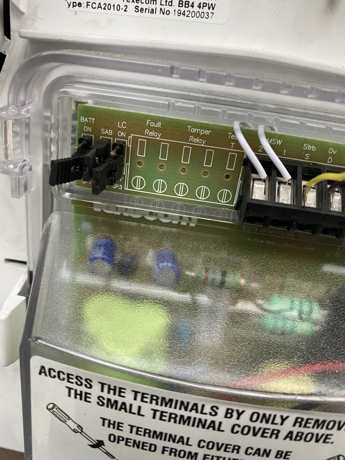

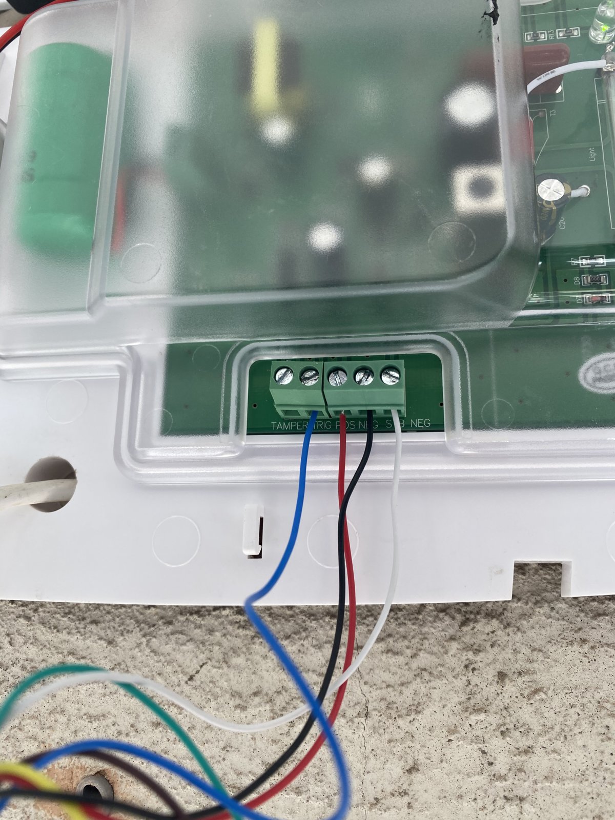

Hi all hope you are all enjoying the weather!
Please find attached pics is this wired correctly?
I don’t think I’ll be able to get both bell boxes To work so I’ll concentrate on the back one instead.

Okay so I think I have managed to get both working. In which points in the panel do I put a link in to deactivate the bell box tamper?
sorry for the numerous replies :(
Just do it right , put the yellow in the tamper at the bellbox , then put the yellow in the T at the control panel...

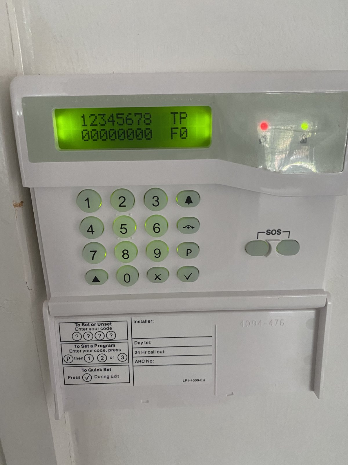

Thank you I managed to get them both working! Only issue the keypad goes off randomly with no reason nothing displayed on the keypad either except when I enter the code and the numbers are displayed on the keypad. Any ideas what it could be?
Take the yellow wire out in panel and touch it to the blue wire in the panel ....does the bell sound outside when you touch it to the blue wire ? ....I take it you don’t have a multimeter ?
