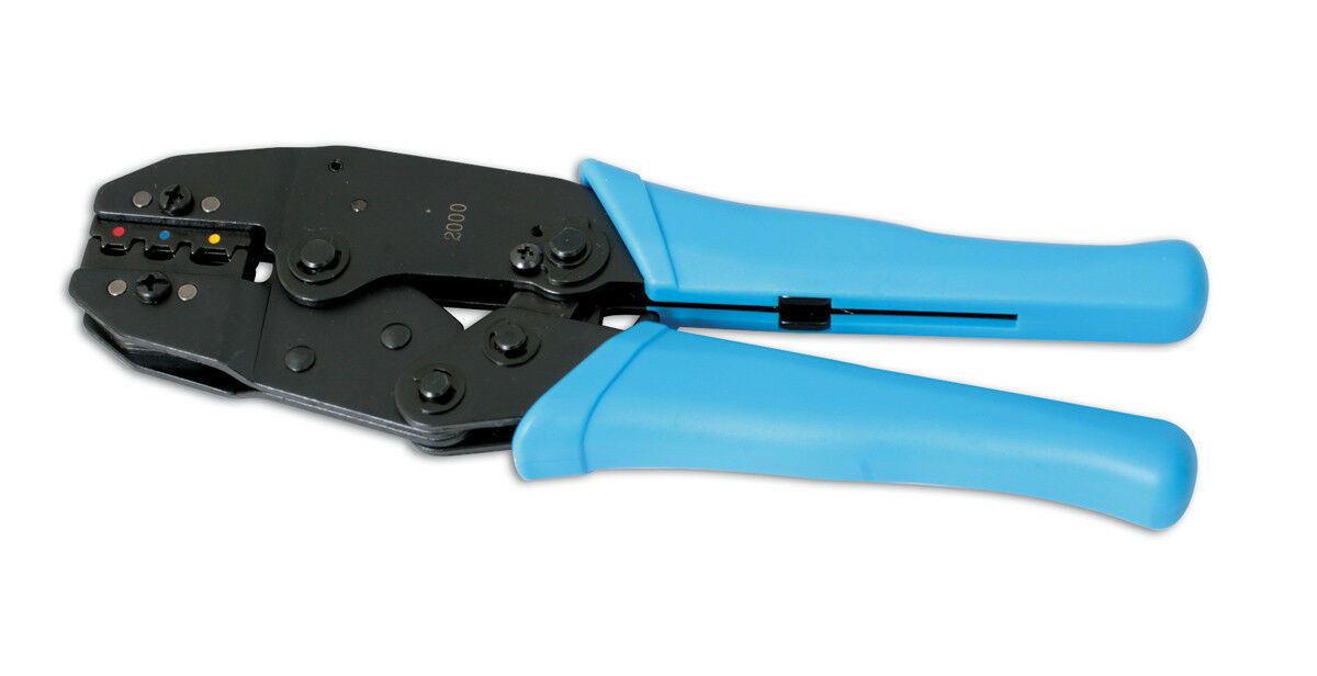

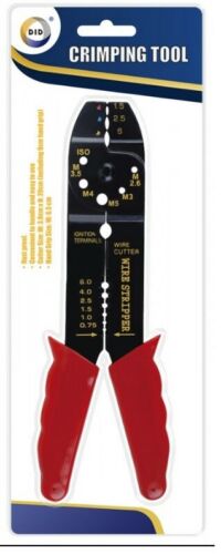

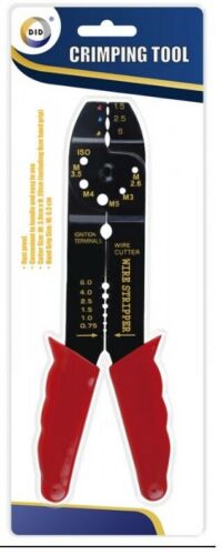

You should not crimp solid conductors with the rubbish crimps and crimpers on general sale.
They are not much better for stranded, either.

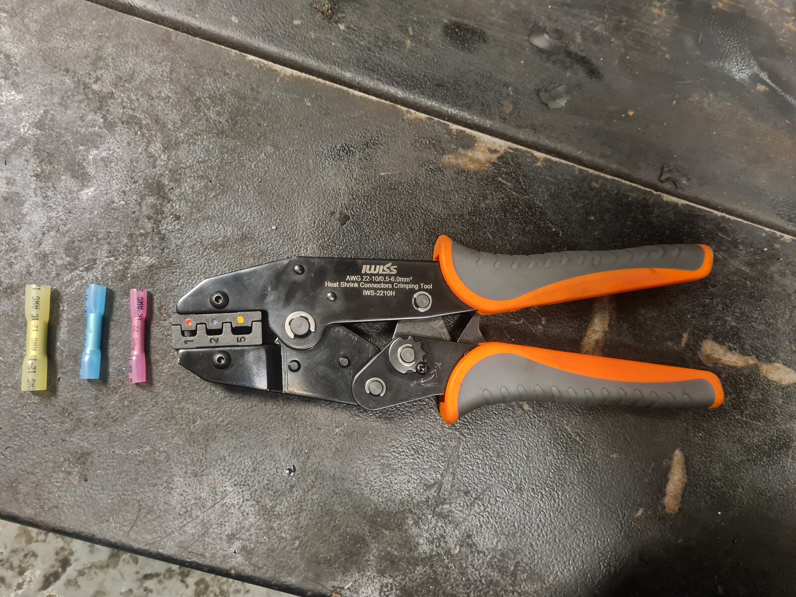

like this?
or this?

I'd be interested to try these on a scrap bit of wire and see if it passes the pull test.
The un-sheathed earth wouldn't have the benefit of the glued shrink plastic though as I doubt it would shrink down far enough.
The cable/wire is clamped in the copper tube inside the plastic though Keith so it should still stand the pull test. The plastic surround is insulation for any stray whiskers are bare wire showing. They have no bearing on the mechanical strength of the joint.

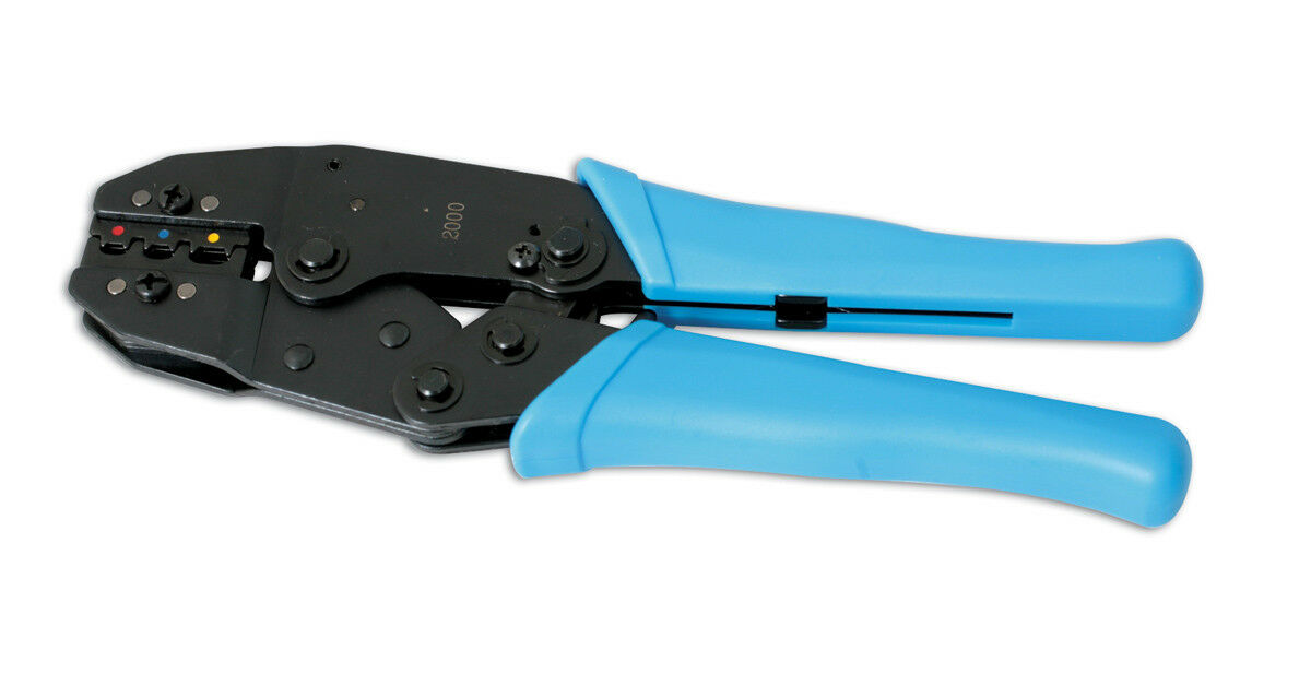

Yes, ones where the crimp/ferrule actually fits the cable and the crimpers compress squarely (is that the right word?) or hexagonally.
They are more for terminals than joining wires.
