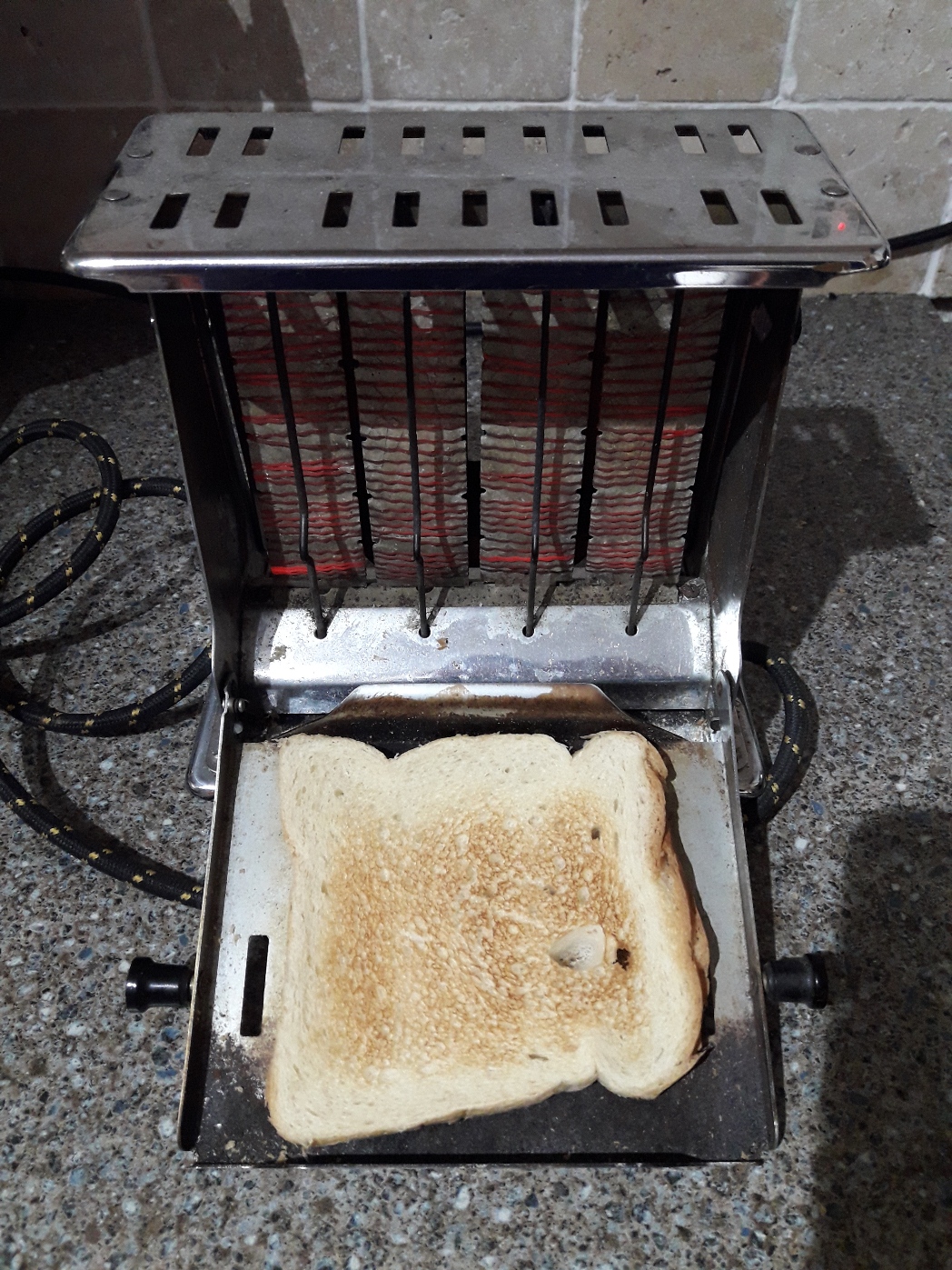

They are permitted as long as the elements are surrounded by earthed metal IIRC.
What is meant by 'surrounded'? With my toasters, if one were so inclined, it would certainly be possible to touch the element with, say, a piece of metal cutlery, without also touching any earthed metal
Kind Regards, John
I think it meant the opening where you put the bread, and it would take effort to touch it with your finger as it the tingly parts are under the opening. My toaster would not comply, as the elements aren't surrounded, it would be easy to touch them during normal use of the appliance. It makes great toast really fast though!
But as I've said before, if you are stupid enough to touch metal that is so hot it is glowing orange, you deserve an electric shock. :)

The sad thing is this 1930s toaster that only cooks one side at a time is much faster than my pathetic modern one that does both sides at the same time.
I've had to fashion some heat shields out of aluminium foil to use in my toaster to only do one side.
There is a design flaw with this one though, the stops that prevent the sides opening too far are too low, so the very hot metal at the top edge of the sides touches the table...
