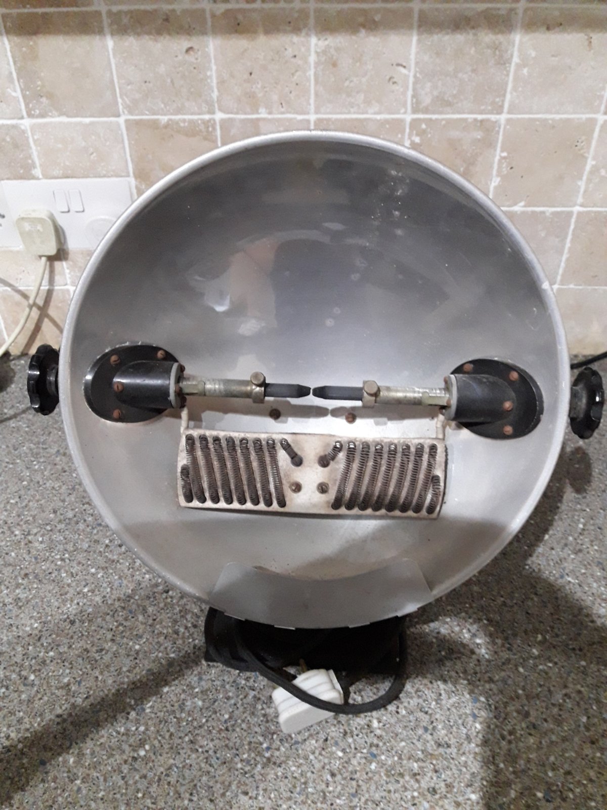

Hi, can y'all answer this for me.
Is it allowed to have exposed live terminals on an appliance as long as that appliance is pushed against a wall?
(not fixed to the wall, can be pulled out).
I know my answer but am seeking some clarification and hopefully for someone to reply with a standard or legal requirement they can detail?
Especially if it's also in BS7671 18th ed.
No.
Appliances are not covered by BS7671, so nothing in there is relevant.
What is relevant is The Electrical Equipment (Safety) Regulations 1994
and in particular Regulation 5(1)
and
Schedule 3, 2(a) : Persons and domestic animals must be adequately protected against danger of physical injury or other harm which might be caused by electrical contact direct or indirect;
Exposed live terminals will not meet that requirement, even if the terminals are against a wall. A wall is not part of the appliance.

You're saying my tanning lamp is unsafe?

Appliances are not covered by BS7671, so nothing in there is relevant. ... What is relevant is The Electrical Equipment (Safety) Regulations 1994 ....
The latter is obviously relevant but if, as seems to be the implication, the appliance is hard-wired, does not the connection between the installation's wiring and the appliance come within the scope of BS7671?
As for the appliance regulations, as a couple of people have said, it's quite common for live parts to be accessible if the appliance is laid on its side, and I have at least some like that. I had always assumed that this was acceptable (to the regulations) because it would not be in that position 'during normal operation' - but maybe that's not the case, and all the appliances in question are non-compliant with the regulations?
Kind Regards, John
John, yes the fitting of the cable between the appliance and the wall comes under BS7671 but the actual manufacture of the appliance does not. It mentions that at the very start of BS7671
Any appliance that has accessible live terminals during normal use is AFAIK non compliant unless they are covered by a basic insulation.
Pulling an appliance away from a wall to clean behind it is a normal use. I suspect that turning a washing machine upside down or on its back it not normal use.
EN60355 part 1 appears to me to say that a washing machine is not compliant if you can touch live terminals. I will be able to tell more once I have managed to get it printed.
