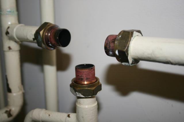

hi people,
hot water ok but central heating failed.
the three port is a acl 679H340-30L0,it has the manual lever on top,if i move that across and lock in position (fill position) CH works fine,once i kill the power completely the lever will move back across to HW only,then with power back on CH will fail untill i move lever back across,would this suggest that valve is ok and that the synchro motor has failed?
i can get a motor for £15 and replace my self of i can get a plumber to replace whole unit with a new one for £200.
thanks in advance

Sounds good so far. Refitting is the reverse of removal
thats obvious tbf. i was just asking if it was worth trying a motor change, hence why i asked if lever moving back suggested that the valve was ok.
It's certainly worth trying. If that doesn't work, you can replace the entire head for very little money, and you might well be able to do that yourself too
thank you. the head and valve will need replacing as its the old type not the snap on/off new style unfortunately,it means ill have to do a system drain.
You don't need to drain the system to change the 3 port valve. Buy a radiator valve change bung kit and you can block the feed and vent pipes in the header tank, crack one of the nuts on the side of the valve until the water stops running and then take the valve out and swap it over. If you fit like for like the threads will be the same size so if you get an emergency the new valve can be shoved back in place pretty quick!
