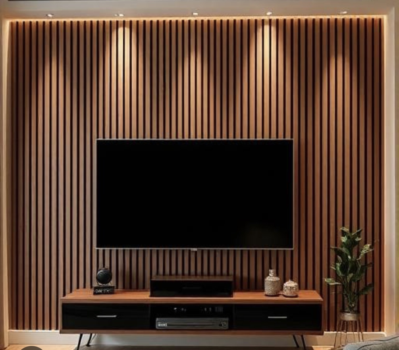

I've got some of these to put up and wanted to check on your preferred method. I've seen some that have just used glue whereas others have used drywall screws in the black sections of these panels.
I am fixing on to a plastered wall.
Thanks in advance.
Depends on panel as there are different sorts.
Also depends if you want to remove them easily
It’s one of these type of panel walls that I’m building. No plans to remove once it’s up.
How flat is the wall? If the wall is uneven you'll notice it so may need use some spacers or whatever to even things up, in which case mechanical fixing might be more suitable.
I used a combination of Black CT1, and some black stainless screws when I installed ours. This was primarily as we knew we wanted to put shelves up, and just wanted the added piece of mind.
one more on this please: should I use a multi cutter or jigsaw to cut out the socket sections?
When cutting the slats with a circular saw to reduce the length, did you cut through the foam with the circular saw too or does that need to be cut away separately?
I used a track saw to cut through both the slats and the backing. Definitely a multi cutter on the socket cutouts.
