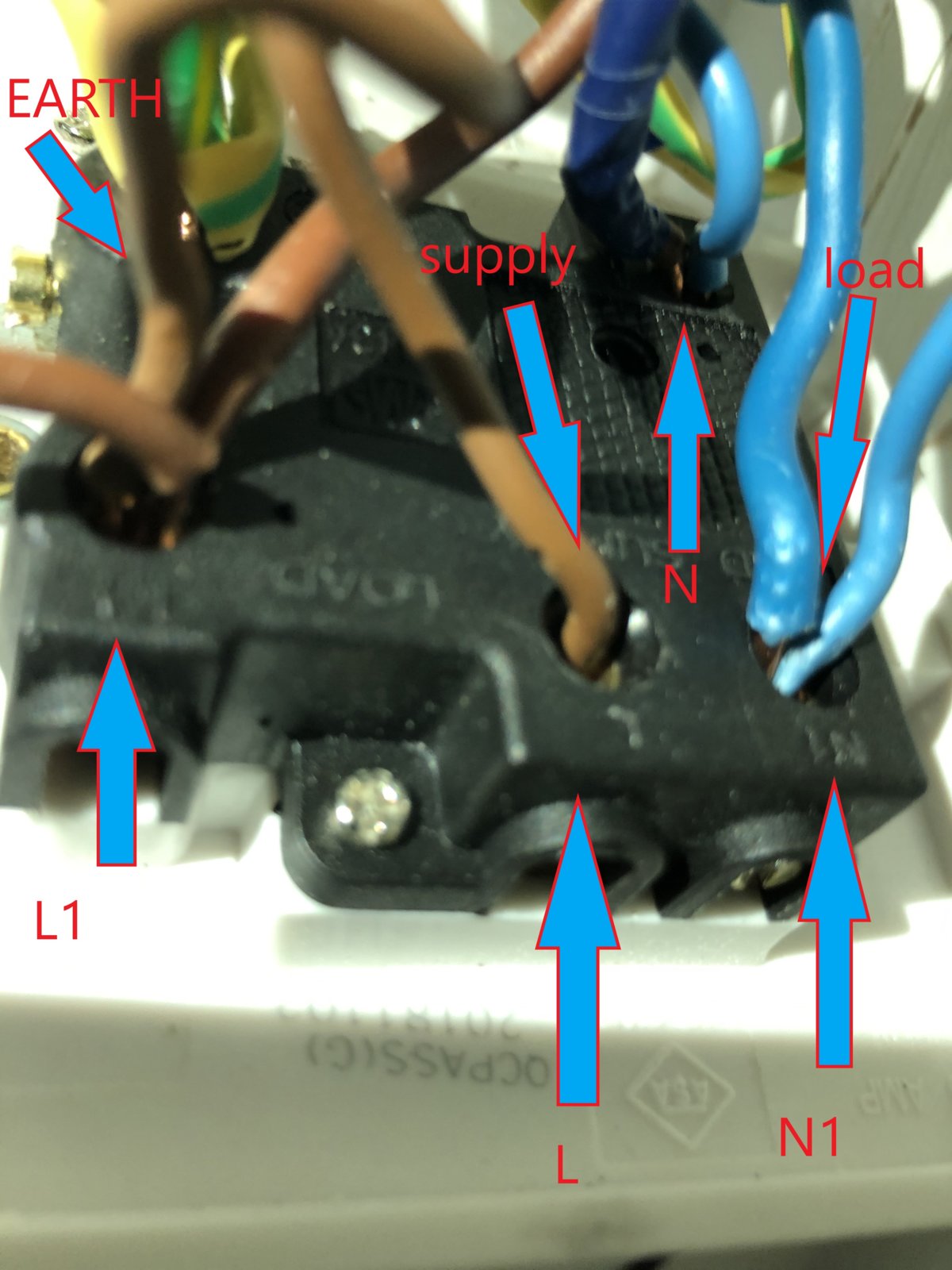

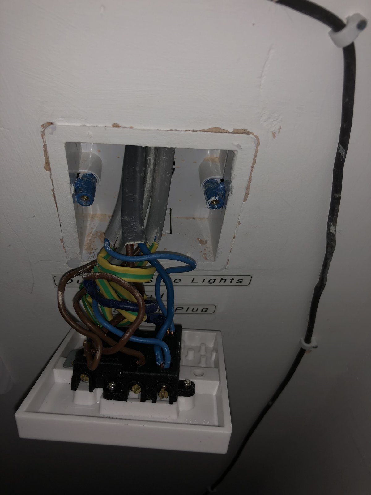

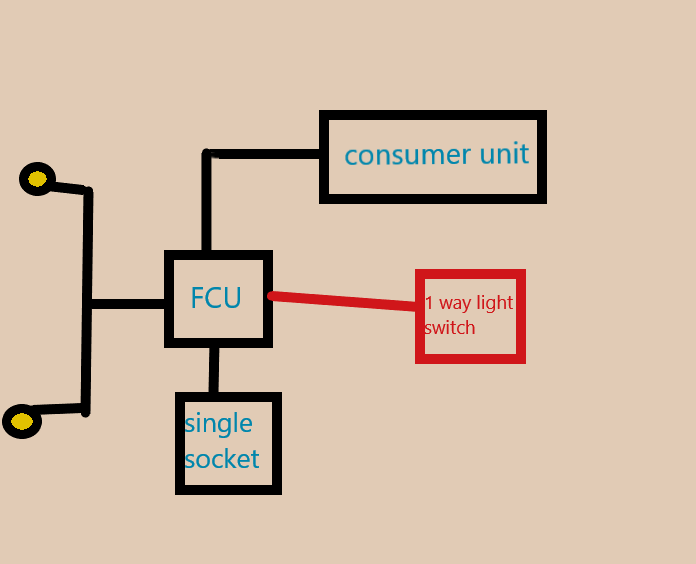

Hi
I have an issue with my outside lights whereby the sensors don't work well I therefore would like to replace the lights with ones without sensors
I would like to add a 1 way light switch from the switched FCU inside the coat cupboard to control the lights from inside the kitchen.
I have in the past spurred a single socket from this switched FCU to power a charger for the vacuum.
I would of thought if I spur a light switch straight from the back of the FCU then will I power the single socket off and on with the additional light switch which is obviously something I don't want to happen.
Some advice would be appreciated

It's difficult to tell from the picture what goes where.
Your diagram doesn't make much sense.
I presume the yellow bits are the lights, but there already appear to be four cables at the FCU. What are they?
Your diagram makes perfect sense.
Assuming your cable is in 2.5mm2 cable, and I think it is from the picture;
1) run a t+e cable from FCU to new light switch.
2) at new light switch, brown to com, blue (sleeved brown) to L1.
3) at FCU connect main feed cable(s) and socket cable to FEED or IN or SUPPLY terminals.
4) at FCU connect light NEUTRAL to LOAD or OUT N.
5) at FCU connect new light switch LIVE to LOAD or OUT L.
6) at FCU connect new light switch blue (sleeved brown) and the light LIVE together in a separate connector block.
7) at FCU connect all earths to the earth terminal on the FCU.
All this is dependent on the size of the circuit breaker, if this a a ring etc, as your photograph doesn't show everything, and we want it to be correct for you.
What size circuit breaker at the consumer unit supplies this lot?
Was your socket cable on the load side of the FCU?
Minus the socket cable, how many SUPPLY cables at the FCU?
Ok I am tying to provide as much info as possible thanks for the replies
So the consumer unit breaker has a label that says outside and downstairs lights, it is a 6amp breaker
The single socket is wired as follows brown L in socket into L1 FCU and Blue from N in socket to N1 FCU.
I presume the other wires are supply incoming and the 2 outside lights.
This is a new build property if that helps at all built last year
so the brown wire from socket is currently in L1 at the FCU this needs to be moved to Supply?
6) at FCU connect new light blue (sleeved brown) and the light LIVE together in a separate connector block.
sorry i'm confused if these go into a connector block where do they connect at the FCU?
That shouldn't be there for a start. A 6a breaker feeding a FCU (unknown fuse) feeding a 13a socket feeding a plug (unknown fuse). Whatever were you thinking. That 13 a socket should be on the ring (via a spur if necessary).
The cables look relatively large, so it may be possible to change the breaker for a 16A breaker.
