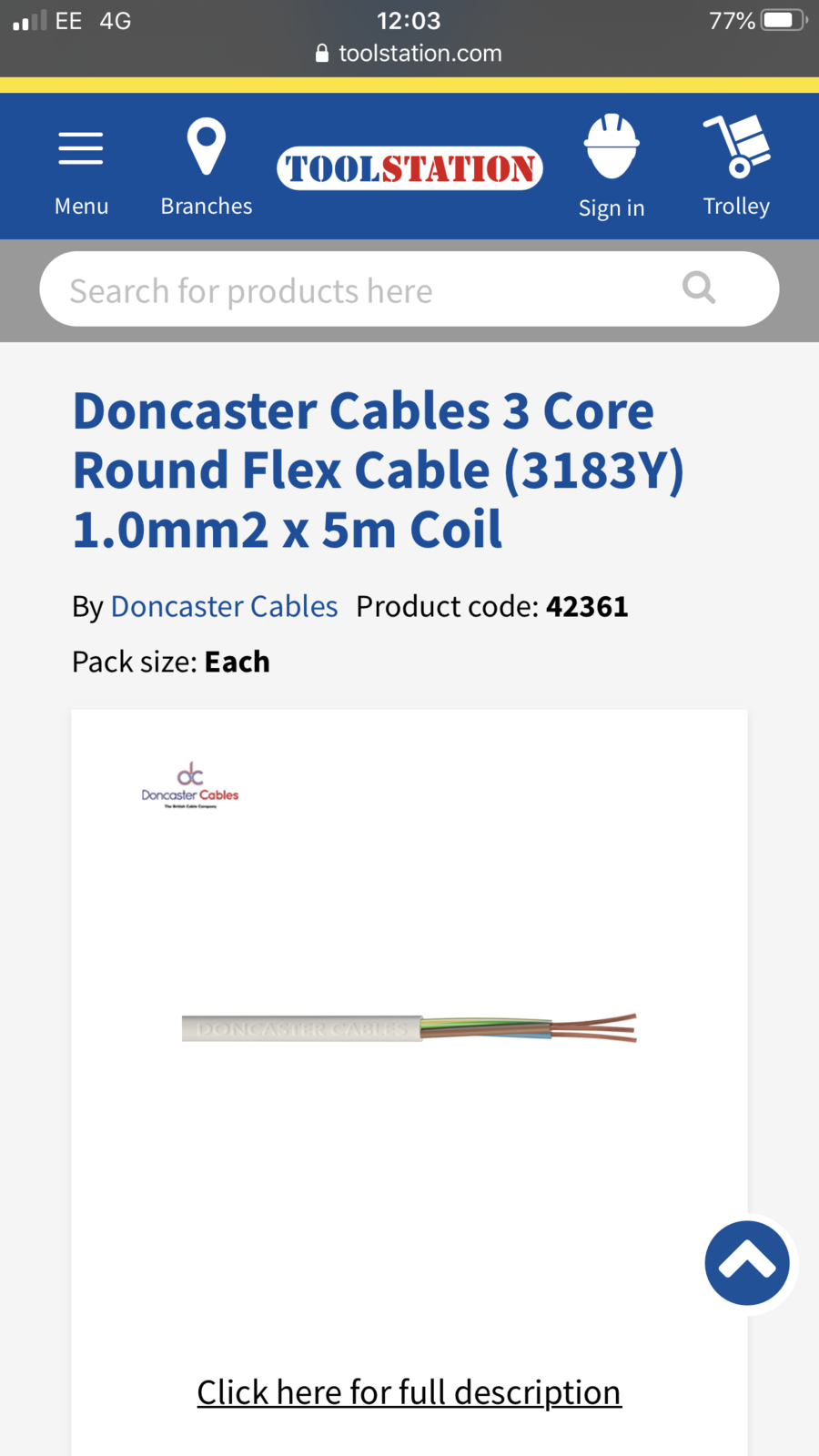

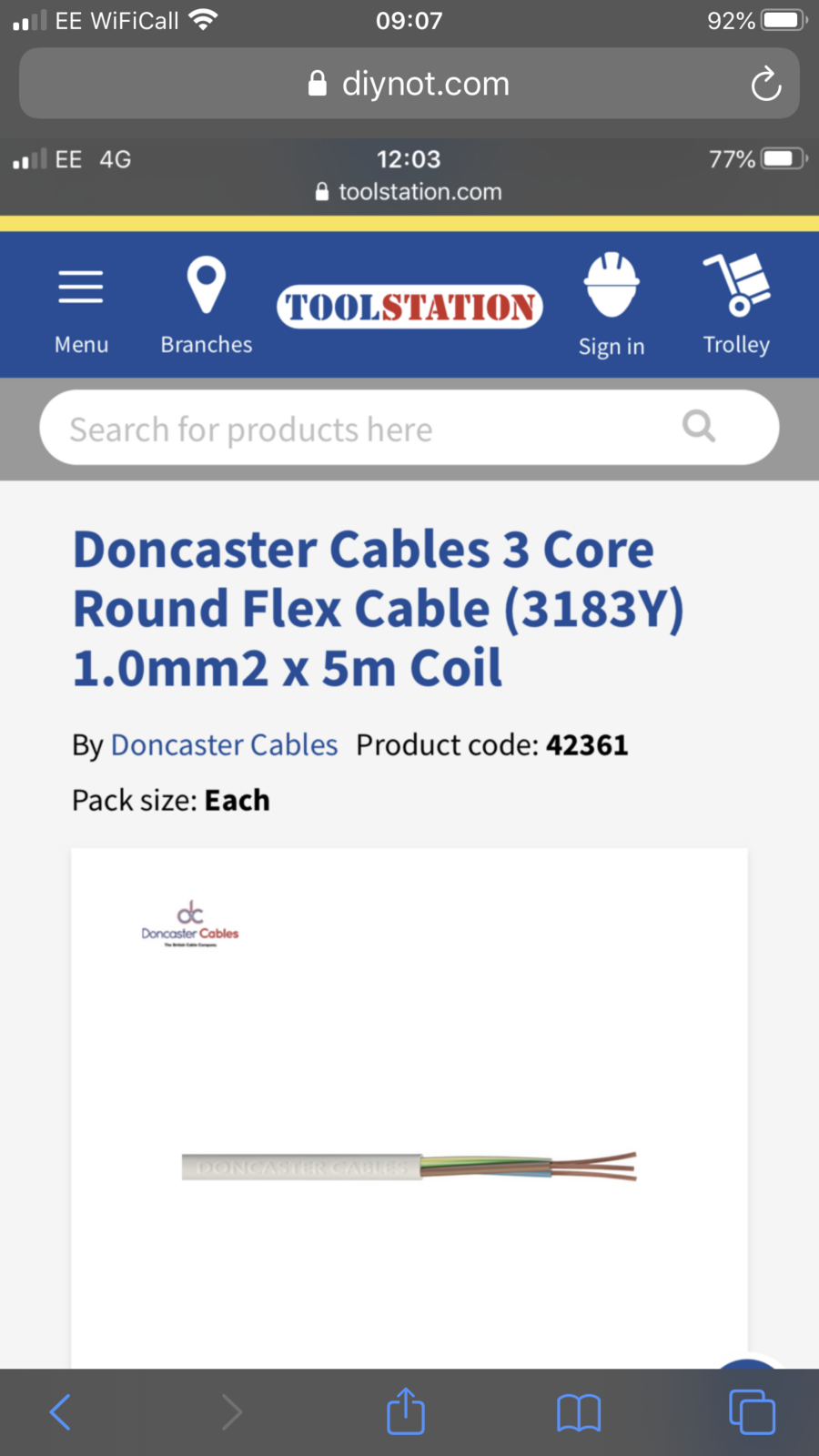

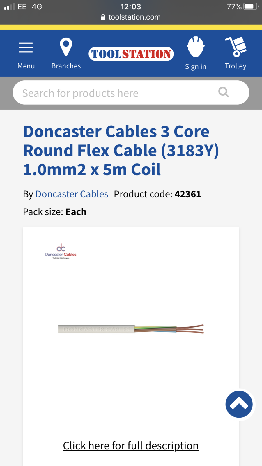

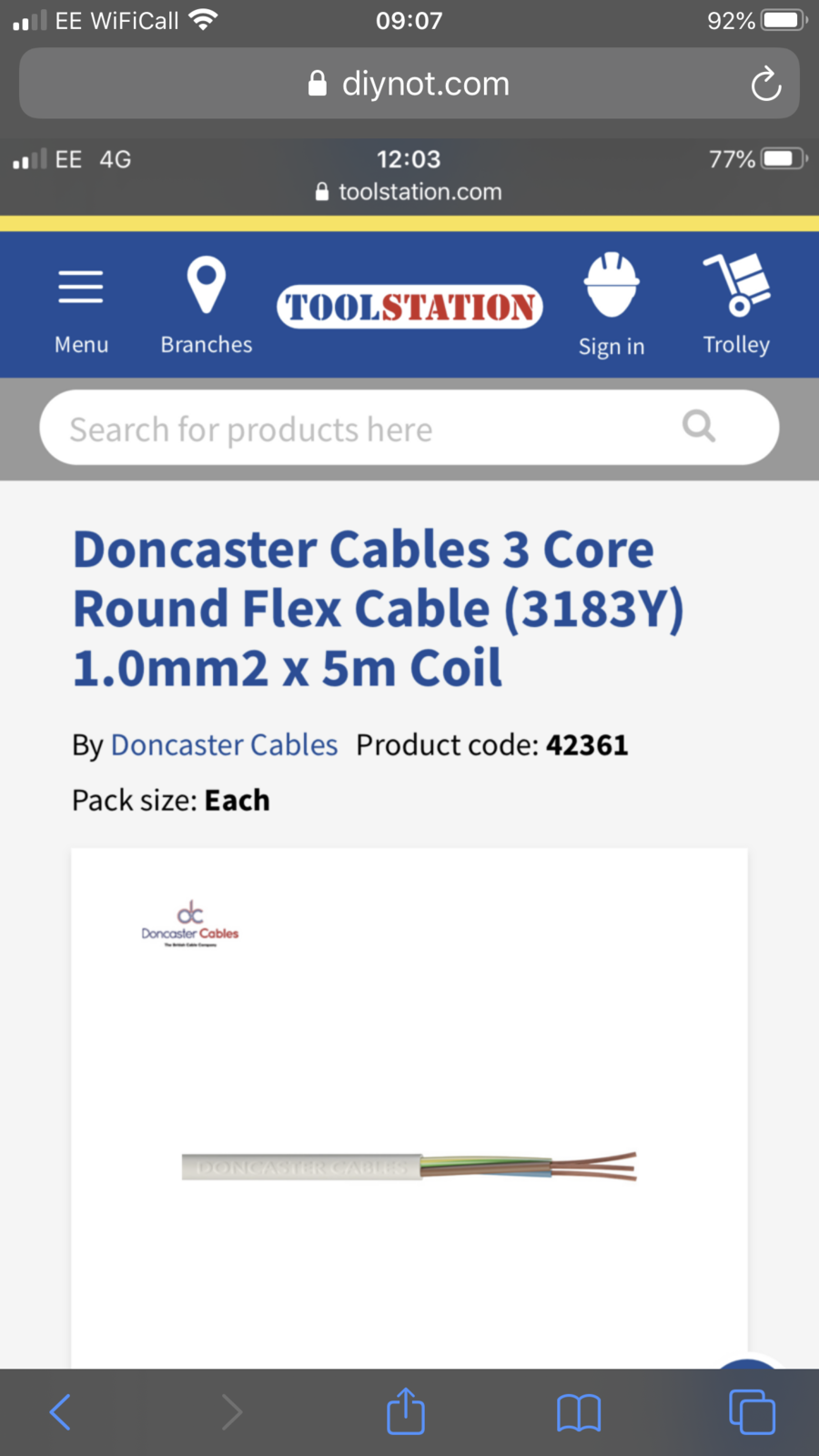

Also, can I stick this flex cable on my light and a 3 pin plug on the other end to operate via a Electrical socket?
Thanks again
