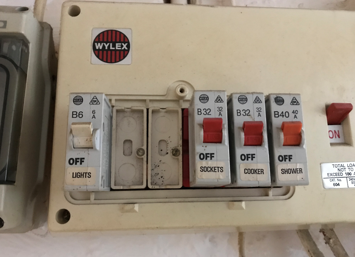

Please note that this is a Victorian property and here is an image of the Consumer Unit:

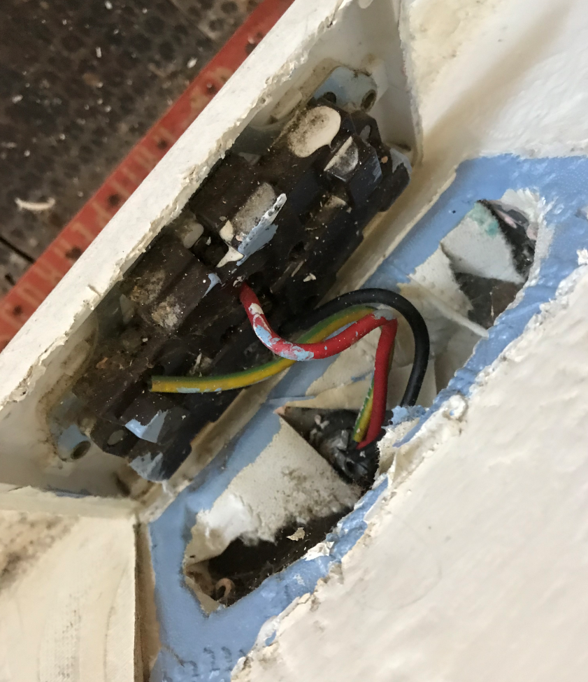

When I unscrewed the socket in question, I noticed that it only has one set of 2.5mm T&E cable.
Below the floorboard I noticed a junction box which has the other end of this cable along with a couple of other cables. One cable appears to be heading towards another socket and the remaining cable, I believe is a spur from another socket.
I unscrewed a different socket in the house and noticed that this does have 2 sets of 2.5mm T&E cables. None of this is my doing I should add!
Would it be possible for me to add another 2.5mm T&E into this junction box to feed my Switched FCU to operate this external light?
You will need to establish, by testing, if the other two cables in the JB are two ring final cables.
Do you have a multimeter ?
One of the other cables is definitely another socket as I also unscrewed that to confirm that it has a single cable. I am therefore confident that the 3rd and final cable is the live cable from another circuit - presumably on a ring.
No. But I do own a 2 Pole Tester with a Voltage Reading display
Does your two pole tester have a continuity function ?
If a socket has only one cable it is a spur ,or possibly the circuit is a radial circuit and it is the last socket.
Yes, it has a continuity function.
I suppose it could be a radial and perhaps the socket I found two sets of cables in, is the one that feeds the JB....
Is the circuit protected by that 32 amp MCB marked sockets ? That would be unusual for a radial circuit wired in what appears to be 2.5mm² cable.
It's quite possible that originally it was a ring final ,and over the years has been added to ( badly) and that can produce some spidery legs and spin offs !!!
You may have opened a can of worms !!
Yes. the 32 amp MCB protects all the sockets in the house. My parents have owned this house for over 30 years and aren't aware of any electrical changes.

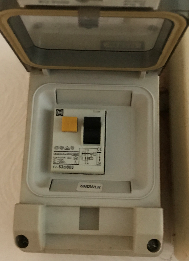

Is that a seperate RCD enclosure next to the consumer unit ,that feeds the consumer unit and protects all its circuits ?
You need to do some investigating ,and testing . Starting at the consumer unit.
