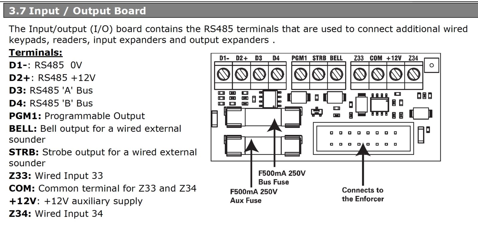

I did a self install on a wireless Pyronix Enforcer system and to be honest its working great. However I want to drive a Klaxon from one of the wired outputs from the board below, which came installed in the main Enforcer panel.
The Master Blaster Klaxon has a 12VDC interface relay (which draws around 35milliamps) which when activated then pulls in the 240VAC supply to power the Klaxon.
So my questions are...
1) Can I drive the the Kalxon interface relay from the BELL output on this unit?
2) If I can do (1) above how is it wired? I am thinking I take a pair of wires and connect these to the +12VDC terminal and the BELL terminal in the Enforcer panel and connect to the relay. Is this correct?
3) Do I need EOL or Tamper resistors with this set up? If so what values and where do I connect them. The Klaxon does not have any Tamper connections so if I need to connect resistors I would do it in the Enforcer panel

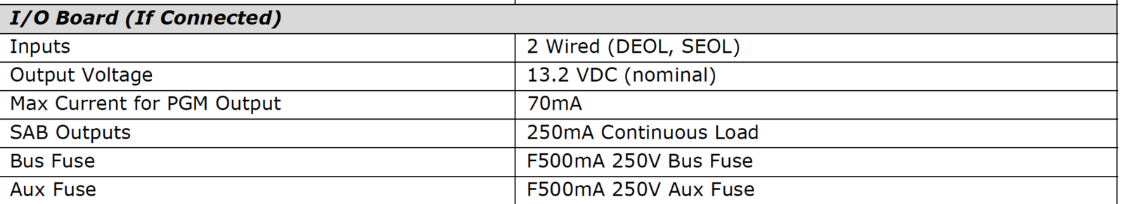

4) I am assuming from the I/O board specifications above the bell circuit will drive unto 250 milliamps.
Sorry its a bit long winded, and thanks in advance for all answers.

Hi,
1 - Yes, that won't be a problem
2 - That's correct. +12VDC to the positive trigger wire on the master blaster, BELL to the negative trigger wire on the master blaster
3 - Not really needed, but if you wanted to monitor the trigger cable, you could utilise a spare pair (say, blue and yellow) in the cable connected with a 2K2 resistor across those wires at the master blaster end. Wire the other end across COMM and Z33 in the panel and program it as tamper.
4 - That's the maximum the BELL output will supply, so plenty of power for the master blaster trigger
Be careful when testing your master blaster ?
Hope you get on with your neighbours as a master blaster is very loud.
Set bell timer to no more than 10 minutes or you could have problems for your local environmental health department.
