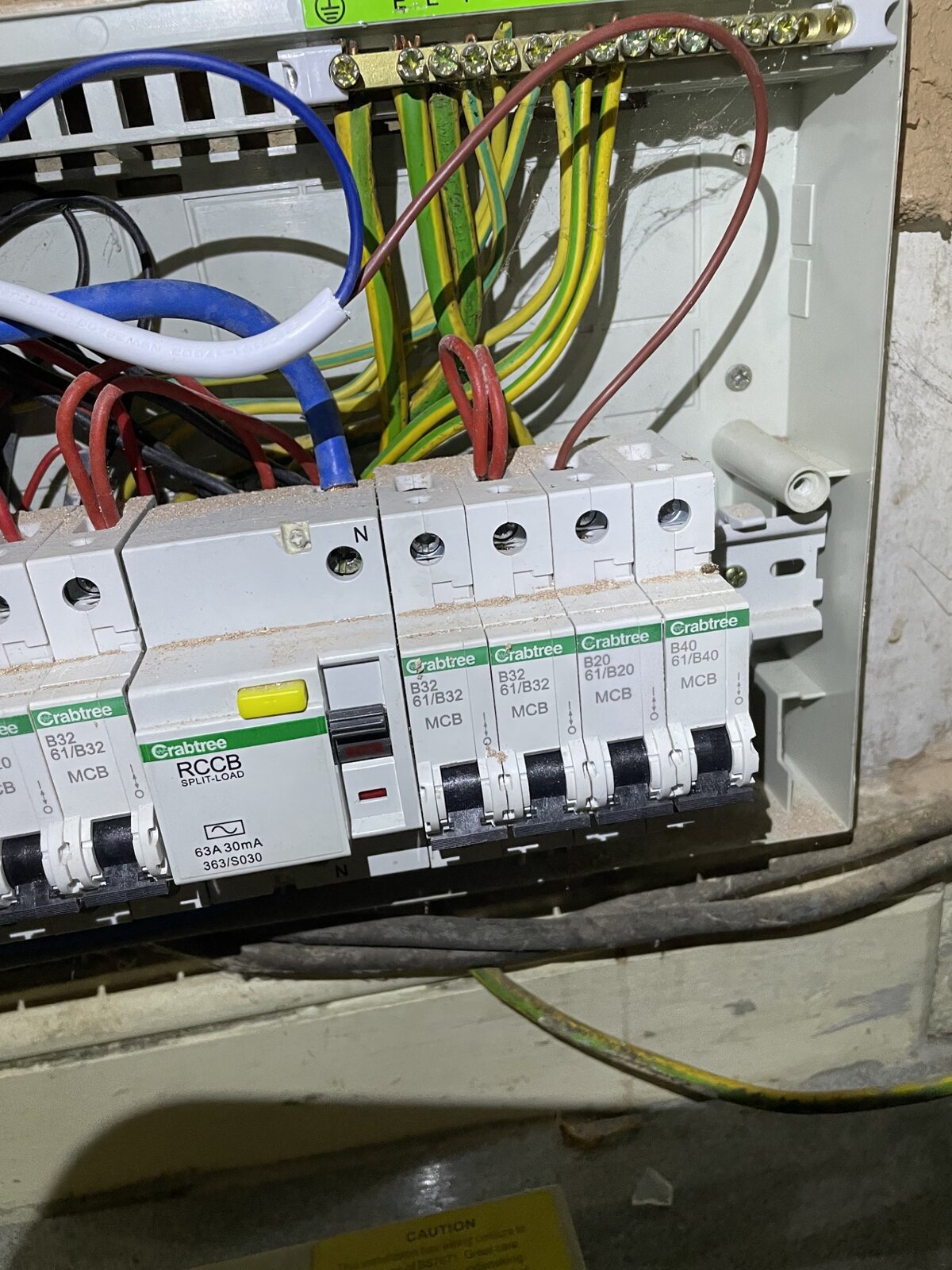

Ok so I did some digging downstairs sockets are on a B32 mcb with 2 live wires going into the CB, upstairs is also on a B32 upstairs sockets + doorbell, 2 live wires. The ones downstairs there's 4 sockets on this circuit 3 are in place and wired up, just the one you see in the picture in that white box is the one we were going to remove but I was thinking i can just re route this to where I need the socket, what I need to determine is if the cable is 2.5 or 4mm. I opened each socket up and they all have a single cable going into them apart from one socket (and the single socket on the floor in the pic) so is this a ring or a radial with spurs? vid of where I want the socket also I wanted to ask that i need to add the wire running up behind those pipes with conduit then to get plastered over etc, would that be ok?

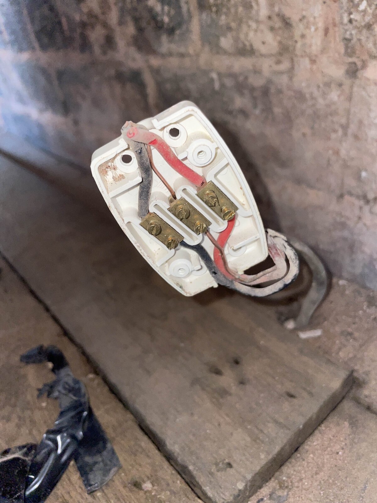

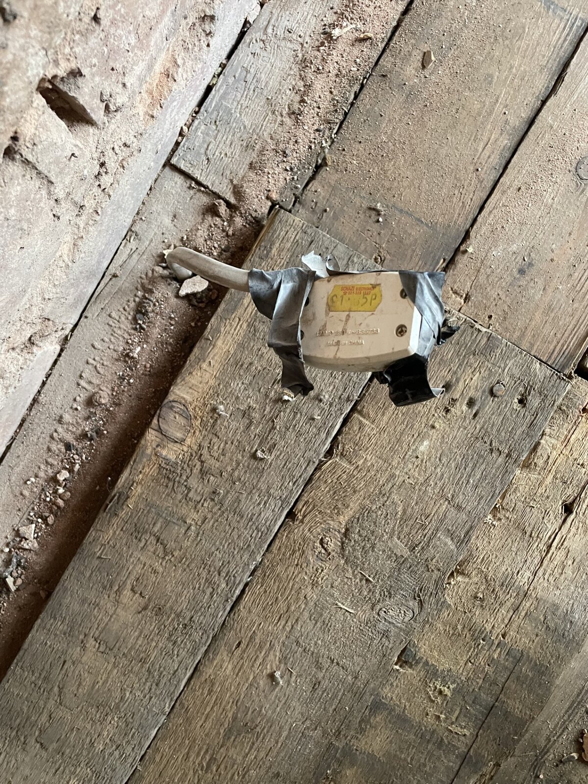

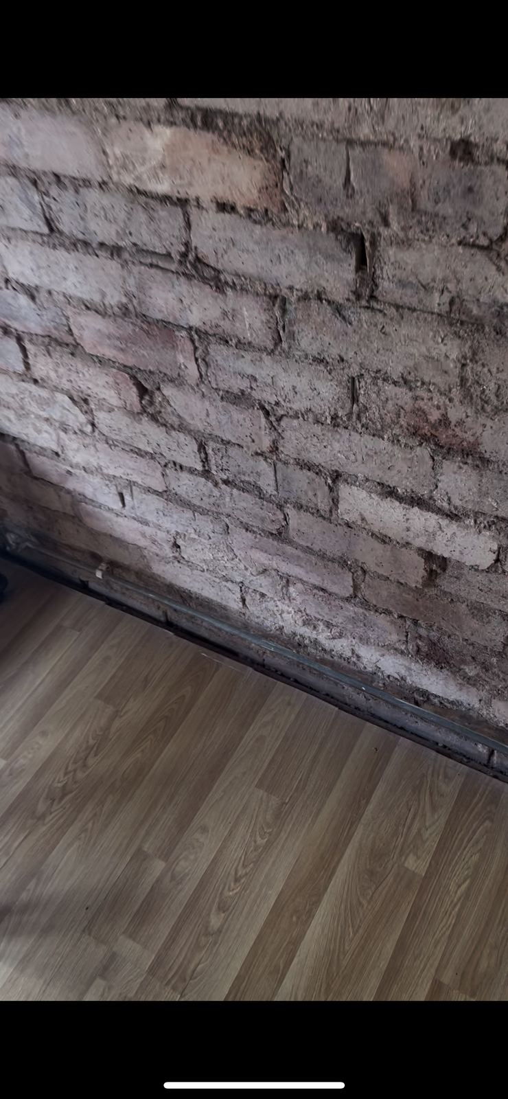

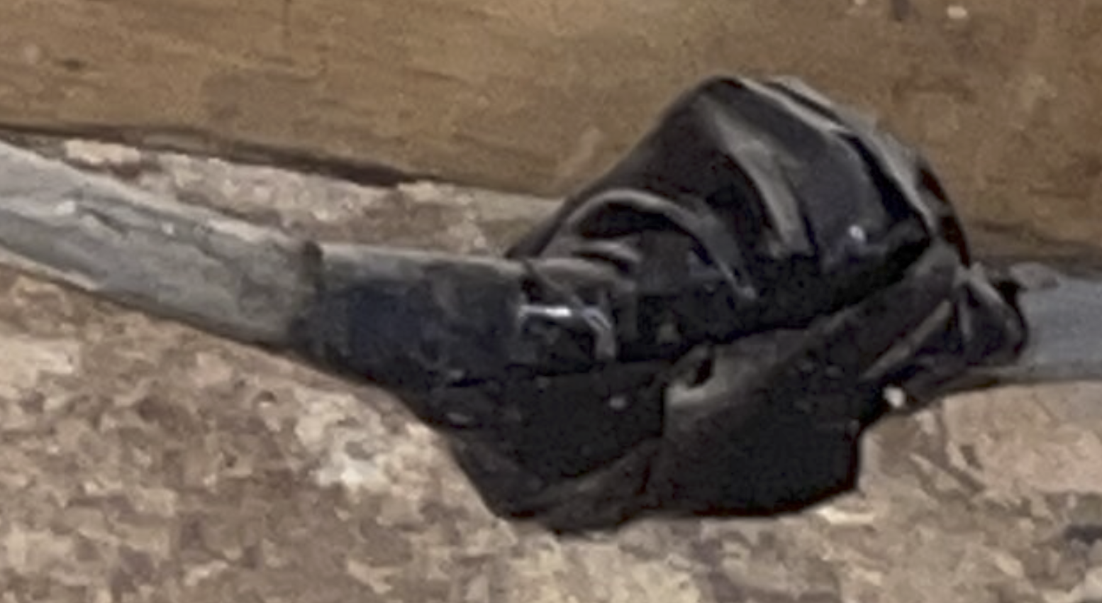

this is the wire which had a single gang socket, there was a wire coming out of the white box into the socket which was removed, I was thinking to use this wire for the new socket that i want to put on the other wall.

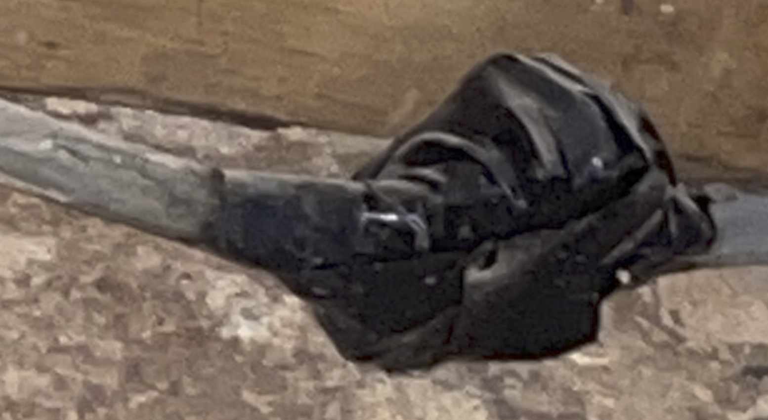

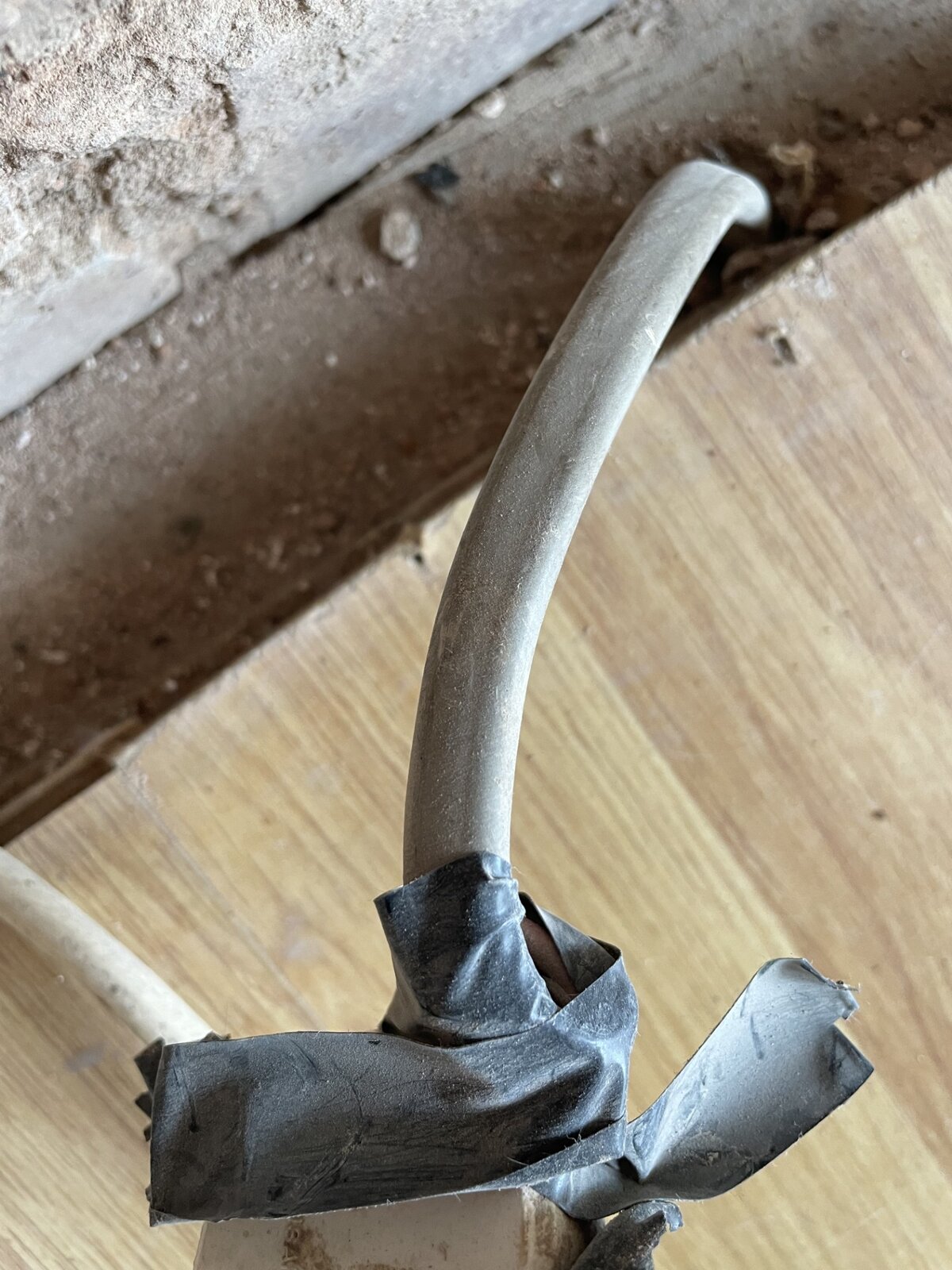

also this socket is on the one upstairs is this wire just getting extended by a connector block im assuming, and how do you check which socket is spurred on a ring circuit?

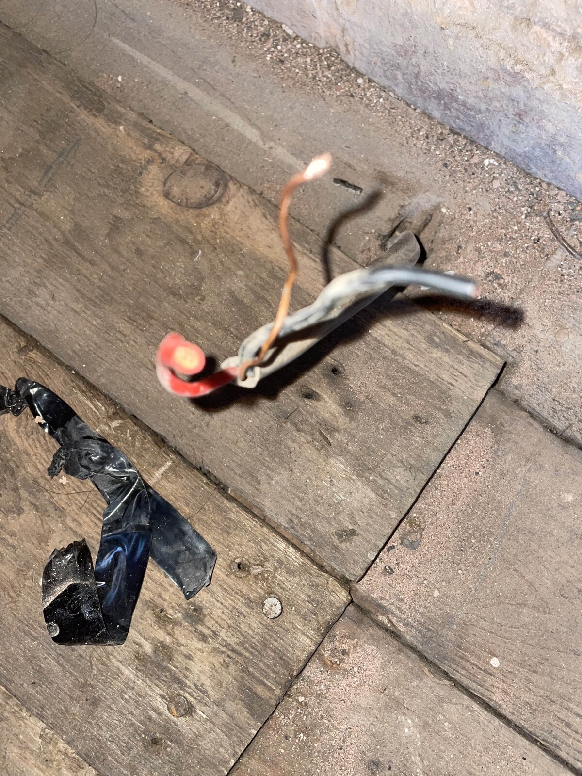

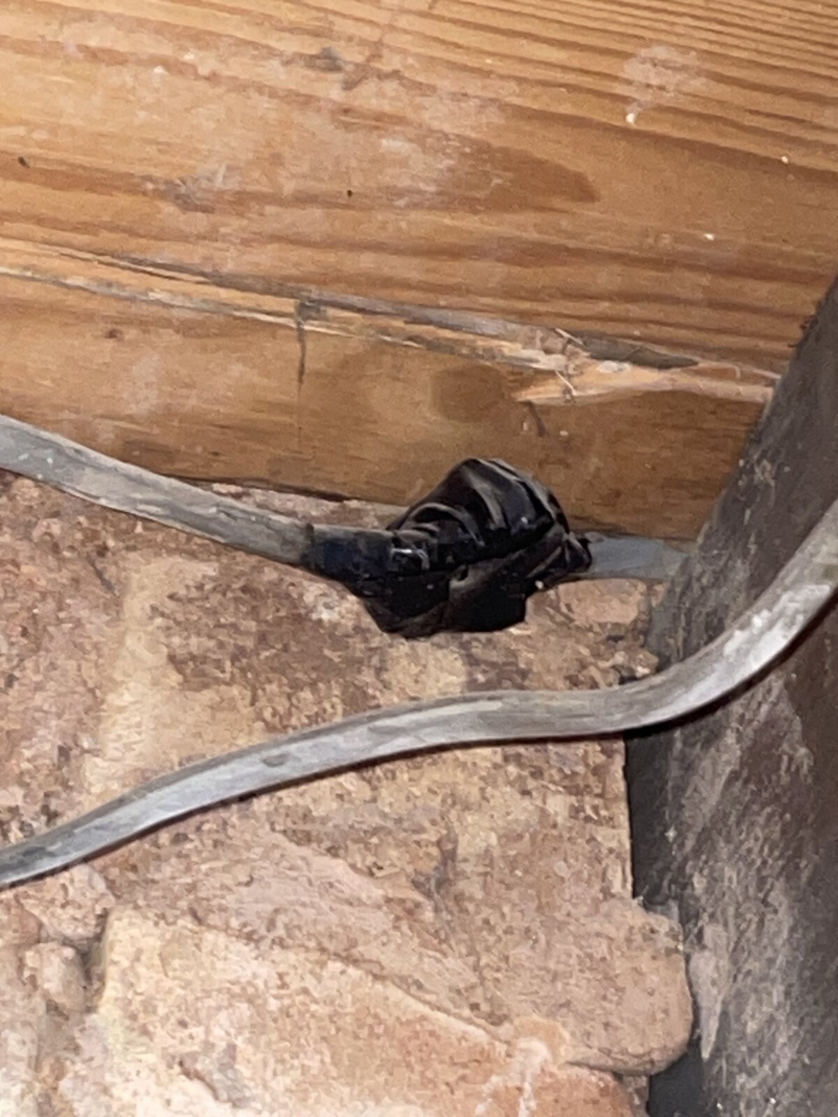

I'm sure that others can be more specific about why, but I'm sure you're not allowed to have a connector block wrapped in tape.
And can tell you exactly what you need to do to fix it while its all exposed.

also I'm thinking maybe there's 2 radial circuits coming off this 32a mcb but then wouldn't it need to be a 4mm cable since its a 32a. I will check it tomorrow with removing 1 of the wires from the cb to see what is getting power then, but no it shud be 1x MCB/RCBO = 1x Circuit Radial or Ring. might be a junction box under the floorboards?
Two 2.5mm cores exiting an MCB is highly likely to be a ring. As I wrote in my first post, disconnect them both and (use a multimeter to) test the resistance between the two. It should be very low, and make your meter beep if in beep mode. If it does, then removing any socket (so as to break the connection elsewhere than the CU) will make the meter show open circuit/no beep/no continuity. That is a strong indicator that it is a ring
Highly unlikely to be two radials as an original design because there isn't an installation method that would allow it to safely carry 32 amps. A break in the circuit caused by wear and tear or other bodged work may have caused it to become two radials, but that should be checked for (and fixed) if it tests as open circuit to start with

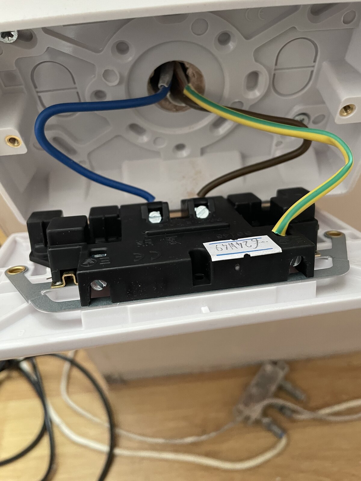

I don't find your post easy to follow; can you get a multimeter and use it to work out a plan of your wiring? Eg after you have pulled two sockets off and are wondering if some wire present in the back of each is the same wire, temporarily bend the live and neutral cores at one end so they touch then go to the other end and test the resistance (which should be very low), then bend the cores so they do not touch and test again; it should now be high. Label each end of the cable with the same unique ("spur A" for the first wire,"spur B" for the second etc). When all cables are tested sketch them and show us the plan
Remember, use the multimeter in AC voltage mode to test between L and N before touching the wires; the previous owner has clearly demonstrated their incompetence with a junction box covered in electrical tape, and may have done the same poor idea you now propose of having an upstairs socket supplied via the downstairs labelled circuit (or vice versa), and you may have turned off only the upstairs (so as to keep the freezer alive), and end up grabbing a live cable. Test wires before touching them.
If you have opened several sockets and found a single wire, and you have determined that you have a ring, then the single wire socket is a spur and cannot be spurred off again without finding the other end of the wire (the socket it was spurred off) and either replacing the wire with 4mm or placing a protection device (fused outlet for example) so that the original 2.5mm section of wire between the socket and [all the multiple spurs it must supply] do not overload it

Also, where one of the sockets is installed, if I remember correctly there use to be a fused switch there which was for an outside floodlight, but an electrician came recently and removed that since we didn't need it.

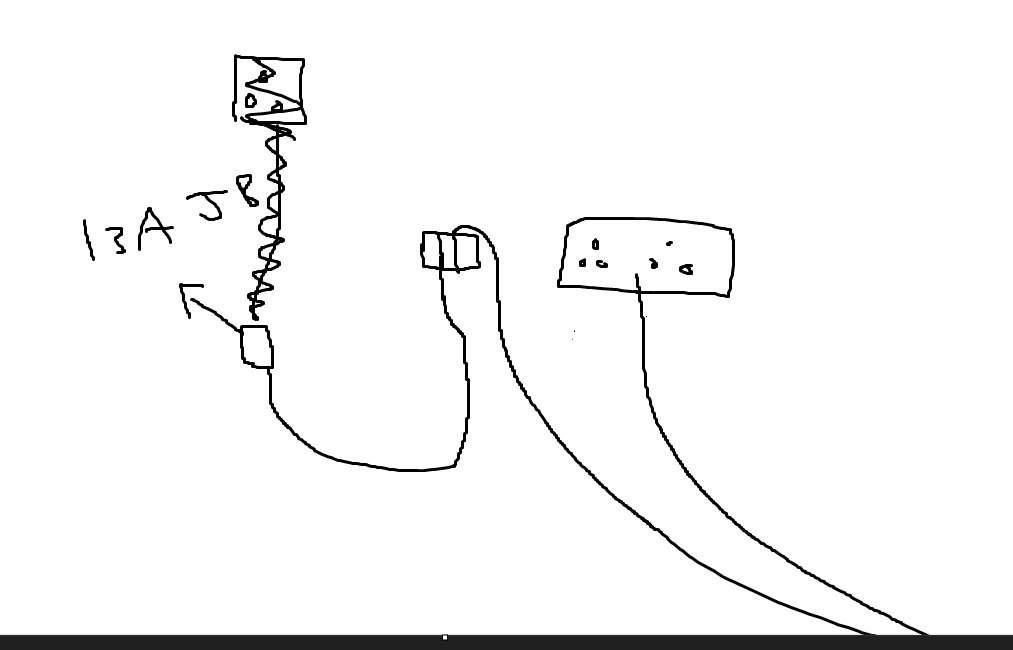

Where that single wire is going into that junction box also had another wire coming out of that to power up a single gang socket, so if I just get a 4mm cable trace that cable back to where it's going connect it up and just put it on the opposite wall where I need the socket should be ok?

see where the wires are routing to and to see if there are any junction boxes.
If you find any that aren't maintenance free they should be replaced or wired out
can't see anything in your pictures that I would call a junction box; show a picture of what you referring to?

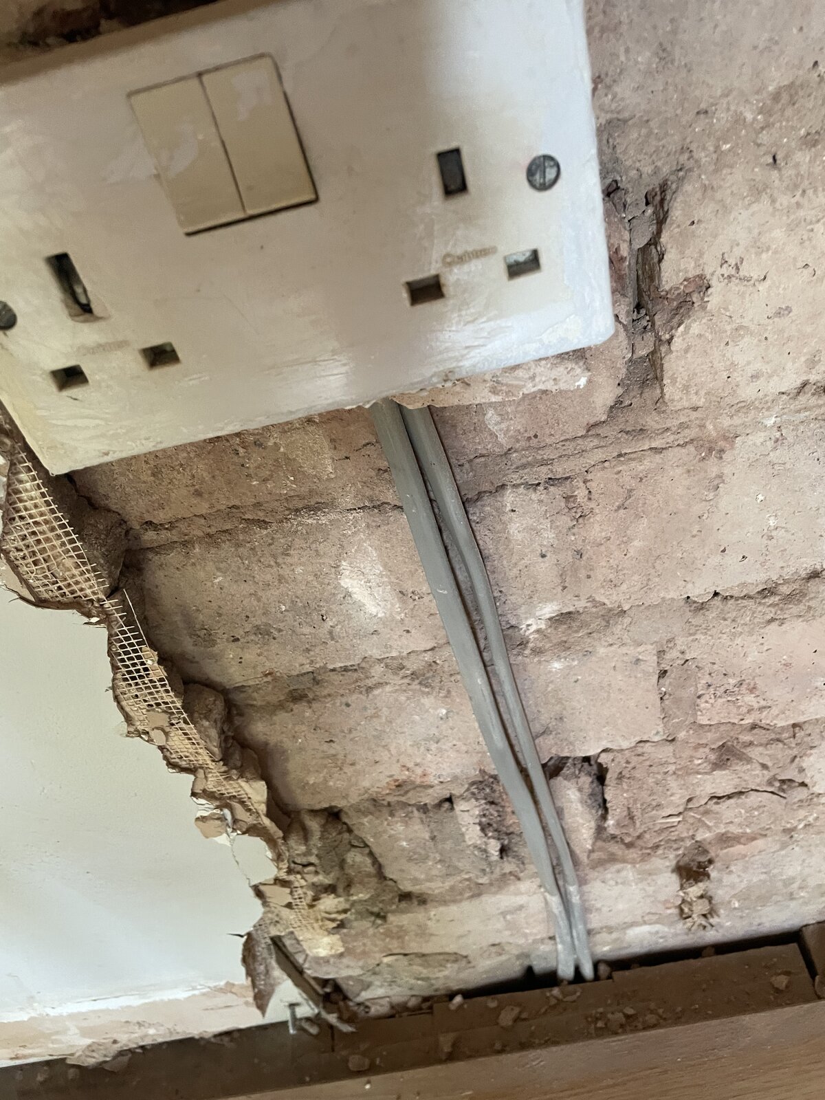

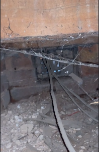

i've just pulled some floorboards up this is whats under, so i'm assuming there's a connection point next to the socket on the wall which has a single wire in it, the bit i've drawn next to the socket is where the switched fuse spur was but they removed the socket since we dont have the floodlight anymore.
This cable seems like a 4mm is it better for me to swap the jb out for a 32amp one and then add the 4mm cable supplying the new 2 gang socket.
