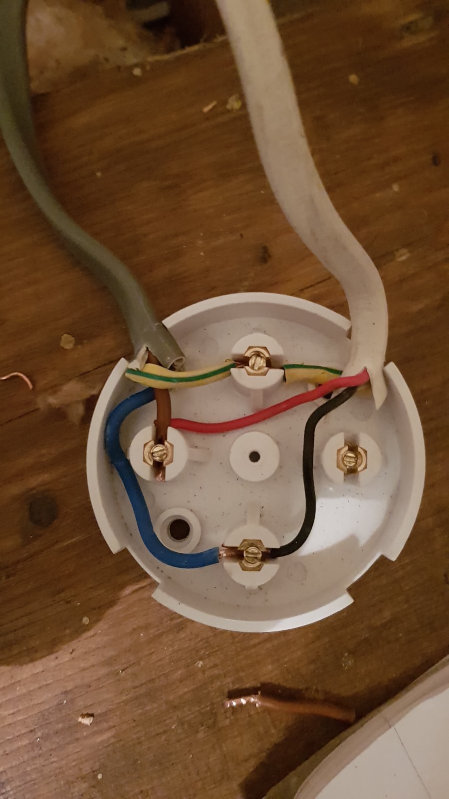

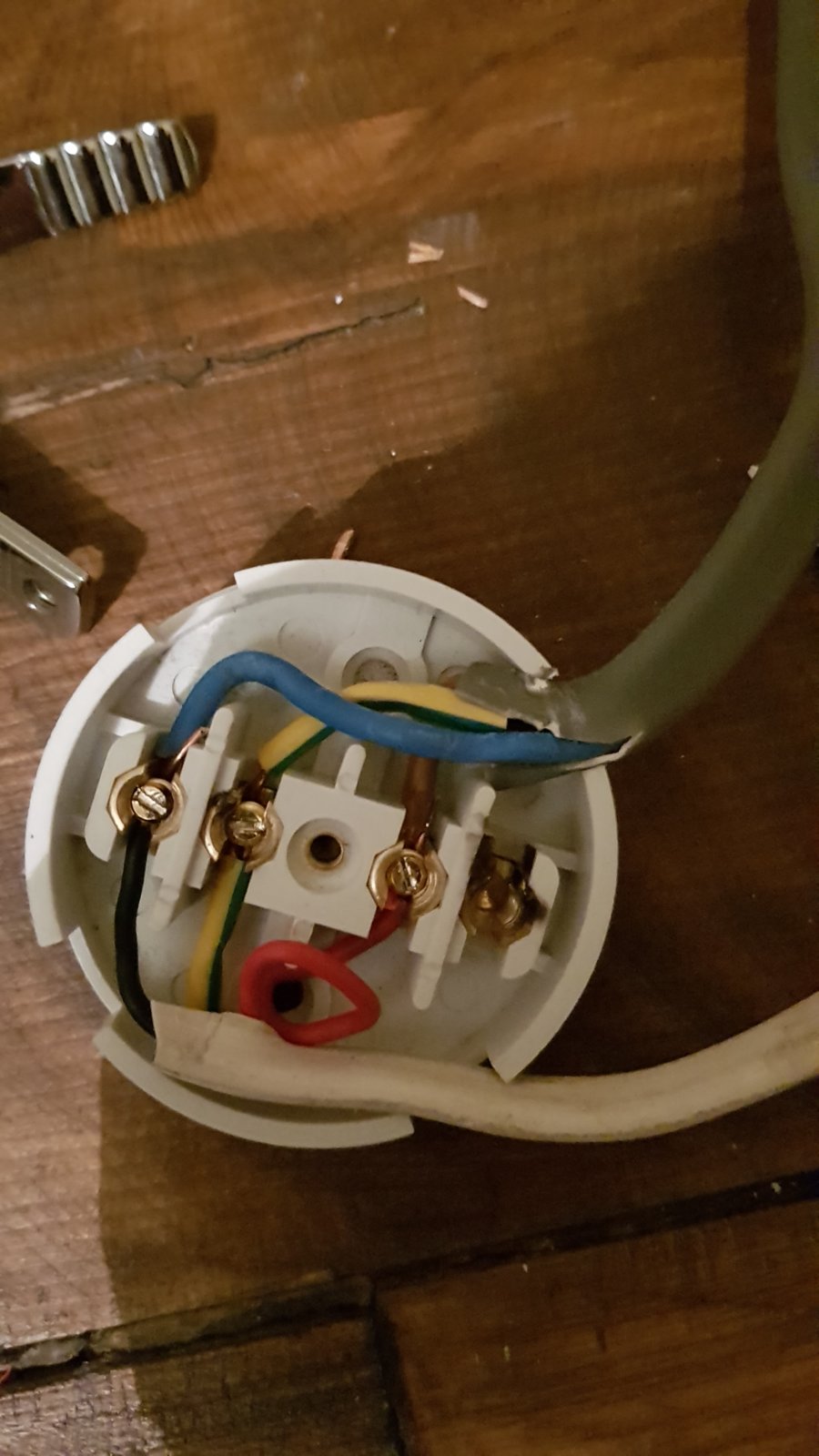

so I have a couple of pics taken this are not changes I have made but are the junctions as I found them.
The 1st one The one with the nailclippers in the edge shows the grey cable going to the switch and the white cable that goes under the floor to another room.
The 2nd picture shows a white cable that comes from under the floor from the same room as the other white cable and the grey cable that goes to the lamp.
the only actual change I have made is swap over the switch (the wiring is the same)
The lights work (albeit showing 180v - but we don't talk about that lol)
but when I added another light to the system as per the linked page (I tried many different ways) I could only get a very dim illumination 70 v.

That's what I would have liked a photo of.
