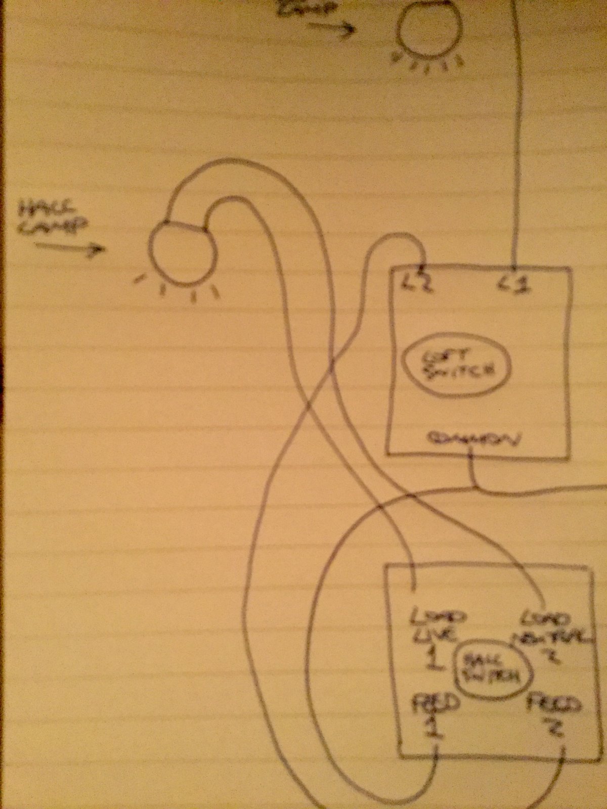

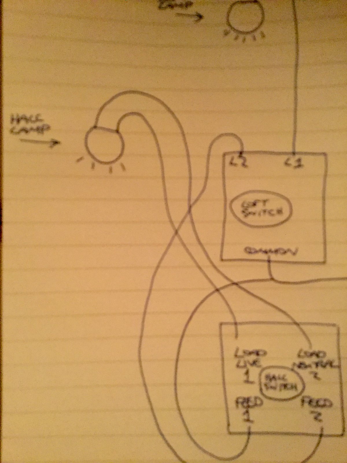

First of all let me say that i had to change the new intended light switch. The picture of the one i posted was faulty. The one I have now is labled feed live 1 and feed neutral 1. Above that I have Load 1 and load 2.
I also have some 1.5mm cable (two brown wires and an earth) and a lamp holder.
Here's what I've done:
I have wired from the common on the existing loft light switch to the live 1 feed on the new switch to give the new light switch power. The other brown wire is not currently wired in. I have wired from the Load 1 terminal to the lamp holder. The other wire from the cable going from the load side to the lamp is not wired in at present but when i turn on the new switch the load 1 AND the wire that it not wired in to anything is live! How is this possible?
I think I'm back feed now. I've connect the remaining brown from the loft switch (L2) to the FEED 2 on the hall switch. Load live 1 and load neutral on the hall switch now go to the cup light.
It is "working" after a fashion. If i turn the loft light on the cupboard light stops working. Also, i can only power a 60 Watt bulb in the cupboard, if I try a 100 Watt bulb nothing happens.

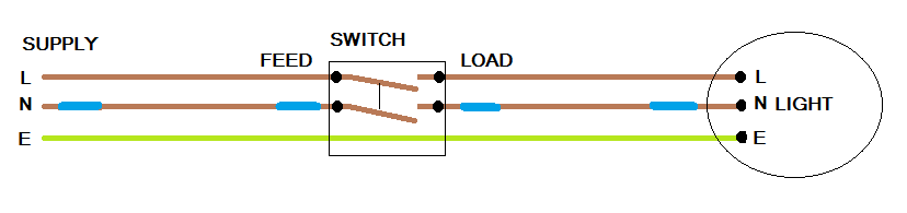

You have bought the wrong kind of switch (a Double Pole one) - although you can use it, and
the wrong kind of cable - although you can use it by sleeving the Neutral with blue at all its connections.
This is what you should have:
The wattage of the bulb doesn't matter. I suggest your 100W is faulty.

Ok, I'll take another look. The cable and switch were in my shed. I don't remeber how they came to be the bulb works fine in my lamp...
The only existing wires i have to work with are a red one going to the common and a black one gong to L1 on the loft switch. No neutral.

Yes if there is a Neutral there.
The blue ( or black ) wire connected to the switch is NOT a Neutral. It is Switched Live.
There isn't a neutral there. That was my first problem. The is only a red to the comkn and a black (red sheafed) to L1.
Without a neutral it will never work properly.
Yeah, I'm beginning to realise that. So how do i make it right? why doesn't the loft switch have a neutral? If I were to take a look at the other swiches in my house would i find others without neutral wires?
Yeah, I'm beginning to realise that. So how to i make it right? why doesn't the loft switch have a neutral? If I were to take a look at the other swiches in my house would i find others without neutral wires?
Most likely. A switch does not need a neutral, and if one is present it will just be looped out in a connector block. The neutral will be at the light fittings. The Wiki explains it well.
