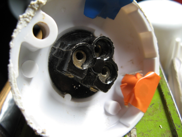

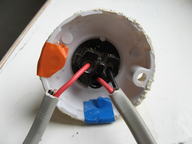

Thanks for the replies and help. Yes, I took note and colour coded (hence the tape) before disconnecting so that if I didn't know how to wire in the new ceiling rose I could put the batten holder back in place for the time being (thanks for the nomenclature tips donrkebab :) ).
So here's how it looked with the wires attached. If that's not enough to go by, I can trace in the loft...
Cheers
As I suspected, looks very dodgy ie dangerous.
The earth wires have not been connected, and you have what looks like a borrowed live or a borrowed neutral and that is potentially dangerous. Unfortunately, you need an electrician to sort this out.
That's very odd for a batten holder, there are usually only 2 phase connectors (L and N). Or is that the back of a pull switch?
Re the earths, unless you have a multimeter & know how to use it you won't be able to prove they are connected at the other end so don't do anything with them (long as your new fitting is plastic you can live without them).

OP- your wiring is fairly old (at least 14 years, probably a lot more). Has an EICR ever been carried out on it? (There might be an inspection sticker on the CU with a date). Lighting outlets without earths were outlawed some time ago but changes in the regs are not restrospective and as long as you don't start putting metal light fittings up you'll be OK. As before, if you can safely trace the cables back to their next ports of call (and back to the CU) and post a schematic we might be in with a chance.

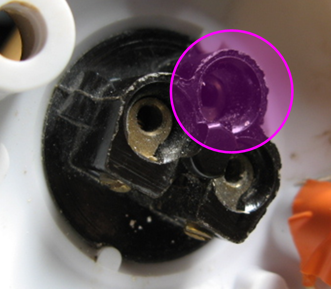

ban-all-sheds - even with yournicely coloured circles I still can't see it!!?! Where exactly should I be looking? Sorry if I'm being blind, which I'm sure I am.

So you have two lights controlled by 2x2way switches, and I appreciate you want to sort this out, but you can't because what I said earlier must be sorted out first.
