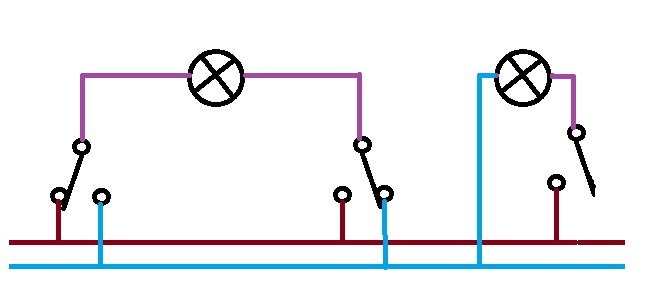

Two way lights that trip the MCB when the light is turned OFF may have been wired with Live and Neutral looped at the switches
When a switch is operated to turn the lamp ON there is no current being broken so no arc between the contacts in the switch.
When a switch is operated to turn the lamp OFF there is an arc created by the breaking current. If this arc continues long enough for the moving contact to reach the other contact the arc is now across the Live and Neutral and will continue as a plasma short circuit between Live and Neutral until the MCB trips.
Older switches with large gaps between contacts did not sustain the arc because the gap was two wide and this economical way of wiring lights was trouble free (*) but modern switches with only a 3 mm gap between contacts will sustain the arc.
(*) it is not a sensible way to wire two way because the two contacts in the lamp holder can be both Live when the lamp is OFF
Theoretically true - but, as I wrote in the previous message, it appears that one of the problems is that the OP only has 1-way switches, in which case what you postulate would obviously not be possible.
