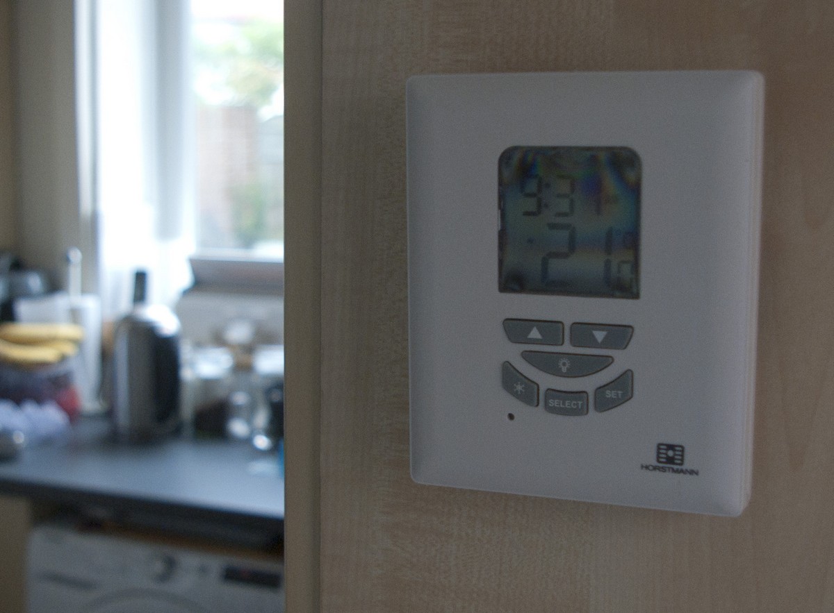

But I came up with a way to add adjustable flow temperature to W-plan, using a pipestat on the flow, (very) rough sketch attached. This shows manual adjustment of the pipestat switchpoint. For weather comp it would be automatically adjusted by a signal from a control box. The boiler could be on/off or modulating, but if modulating it would be on/off in WC mode.

The manual adjustment is Mk 1. The Mk 2 version with weather comp has the pipestat setting automatically adjusted.
All I need do, should I want things warmer, is turn my room control up a touch, and leave it to sort out what flow temperature, it needs from the boiler, and how long it needs it to run for, so it precisely hits the spot.

The system knows the present room temperature, the preset room temperature, the flow temperature, return temperature, the outdoor temperature, and has a close idea of how much heat input it needs to generate, to meet the likely demand for heat, from past-experience - and so sets the boiler appropriately.
it needs to know the actual room temperature, rather than on/off, demand/no demand.
