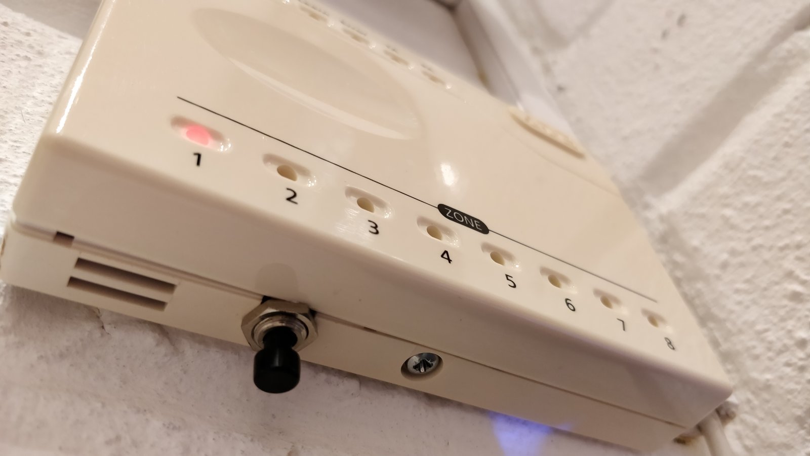

In case anyone comes here with similar issues (there are a lot of these readers out there after all) my experience is that every so often the device 'locks up'. That is to say, it looks 'alive' as far as the LEDs go but it is both unresponsive to fobs or to status changes (i.e.day mode on/off).
As the alarm panel remains powered up all the time, I suppose one could expect this in time.
It is a bit inconvenient when you come home to disarm the panel and there is no response! All that is required is to remove the power to the reader for a few seconds. I fitted a small push-to-break switch underneath that does this. I 'reset' it this way every few weeks and have never had a problem since.
Maybe this is why an otherwise successful device was discontinued by Honeywell??

Hi I’m having the same problem and it’s a pain to keep opening up the reader to reset the power. Can you share which push to break switch you purchased and how you fitted it please. Tks
It must be a pain for you to be opening up each time, especially as that little screw on the bottom gets a bit fragile over time. By having the switch, you will tend to reset it whenever you feel like it and not just when it locks up.
I just filed out a little semicircle in one side of the lower case with a round file and fitted a very cheap little momentary push-to-break switch such as this from Ebay...
https://www.ebay.co.uk/itm/Push-to-...341735?hash=item3b03d4b3a7:g:gpYAAOSwxJlaui-t
Then I simply wired it to interrupt the 12V supply wire.
I usually press it for a few seconds to let it completely power down. When it comes back on, the power light comes back immediately but it sometimes takes a few seconds for the 'status' to be shown correctly by the 'Day' and Zone LEDs. I presume the panel only sends update data quite rarely if nothing new is happening.
Not the most elaborate of solutions... but it does the job and it will hopefully extend the life of this (obsolete) useful device.
