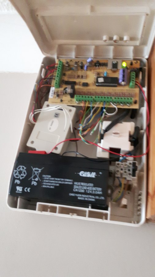

Ademco accord tamper light on

Hi all new too forums so please have patience with me I have an ademco accord alarm in my house at least 15 years but since battery drained the tamper light is constantly on and it won't allow me set the alarm it takes user code and continously beeps but doesn't set I have replaced battery and tamper switch in box seems to be fine does anyone know how to fix this problem any help greatly appreciated as I am moving out and must fix for the landloRd this week
Hi I didn't try that will post picture when back home thanks for response Mark all help greatlynch aporeciated
Hi see photo of control box attached thanks again

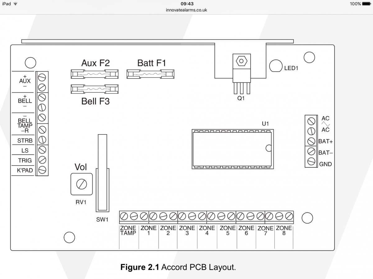

Your picture is blurred , link out zone tamper ( bottom pcb) and.... bell - and -R ( left pcb )

I will be trying to resolve problem again later when finished work thank you once again for assistance I hope I can sort it i will try send better picture later but the pcb picture you sent is identical
