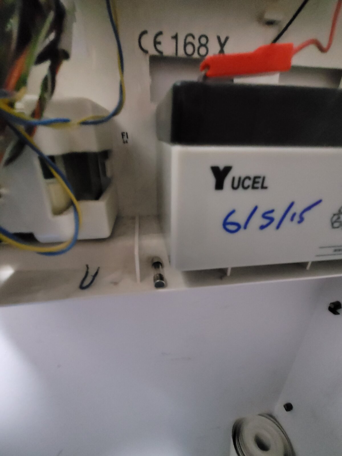

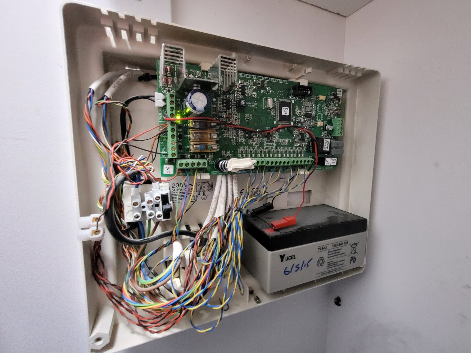

Hi,
I am new to the forum and have joined as I am need of help.
I have an adt accord xpc alarm. It is not on a contract and came with my house.
I have been doing some DIY and recently removed a couple of sensors for painting.
I have just replaced these with new ones. Since doing so the alarm panel had a solid battery simple with a flashing X. The manual says this means battery missing or low.
I have just replaced the battery with a brand new one. The symbol is still present.
As far as I can tell everything seems to be working as it should.
Any ideas? As it's starting to frustrate me.
Kind regards
Stuart

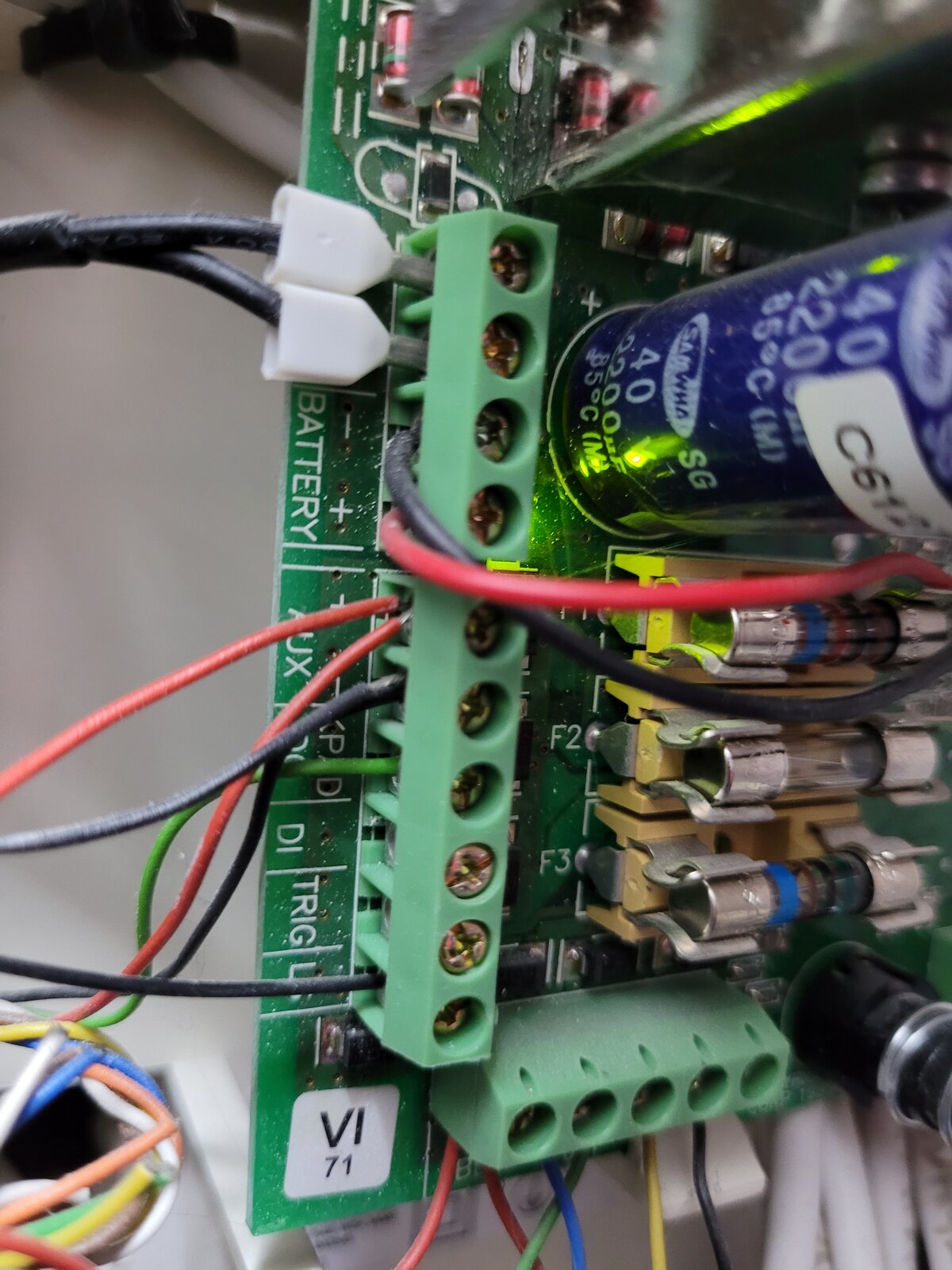

Check the glass fuses on the main control panel
I've just taken the panel off and replaced all three fuses and seems to have solved the problem. Although I cannot see that any are broken/failed.
Wouldn't worry about it in that case then lol. If your really bothered you could test the continuity of each fuse with a multimeter

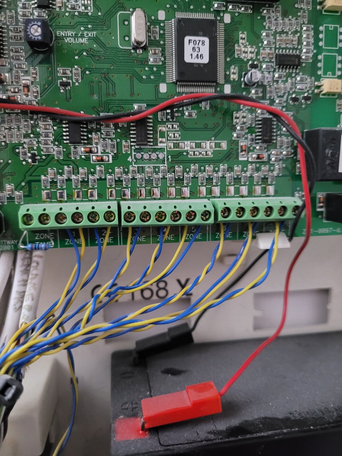

I also have another problem.
When I took the panel off and changed the battery I noticed that there was a small jumper wire on the panel floor that may have fallen out.
I am not sure if it did or not and have no idea where it goes.
I have tried to feel each of the connections but none seem loose enough for a second wire.
I have uploaded photos. You can see the little blue wire. It is only long enough to go between two connectors that are next to each other
