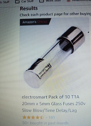

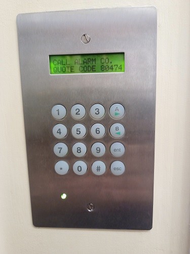

Well I pulled the top fuse and guess what its blown.......pulled the other 2 on the panel and they're ok.
When I put the good 2 back Alarm started beeping....legged it downstairs keypad now has writing on it and it appears to be in the process of arming.
Put the code in and stopped the arming process but when i went to test arm it again got a message on the display stating "Call alarm Co. Quote Code 80474" is that because I havent yet replaced the blown fuse??
Also are the fuses pictured from Amazon a direct replacement for T1AL 250v fuses as I need them in a hurry.
Col

That's because the panel is configured for remote reset. On the 16+ panel, when in engineering programming mode, select 06 - Parameters, 10 - Remote Reset and set to 0 - Off. This will disable remote reset and you can then reset faults with the engineer code. You'll still need to replace the fuse before the engineer code can reset the fault though.
Thanks Galaxy Guy....you know what my next question iss gonna be..........how do i get the engineer code?
Hi all and thanks for your help
I've replaced the blown fuse and installed a replacement back up battery alarm started to activate so legged it downstairs and managed to disarm using my code.
Still getting "contact alarm code and quote code 80474"
I'm not confident enpugh to try and reset the system myself and dont have any engineer/management are any of the installer/engineers on here based anywhere near Coventry/Solihull?
