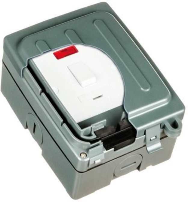

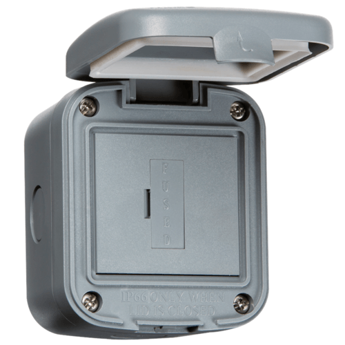

Can you fit another Fused Spur Connector Unit (the cable is the spur) with a 3A or 5A fuse?
That's an idea. The only place I could access the spur, without disruption and considerable additional cost, would be where the external junction box is sited. So maybe one of these could replace the external junction box? Or be positioned alongside it?
I remember an electrician telling me that a fuse protects the wiring, rather than the appliance, which is why I was wary of using 6 amp cable when the preceding switched spur has (and needs to have) a 13 amp fuse. Would I be going against the IET Wiring Regulations by using 6 amp cable?
It could be.
