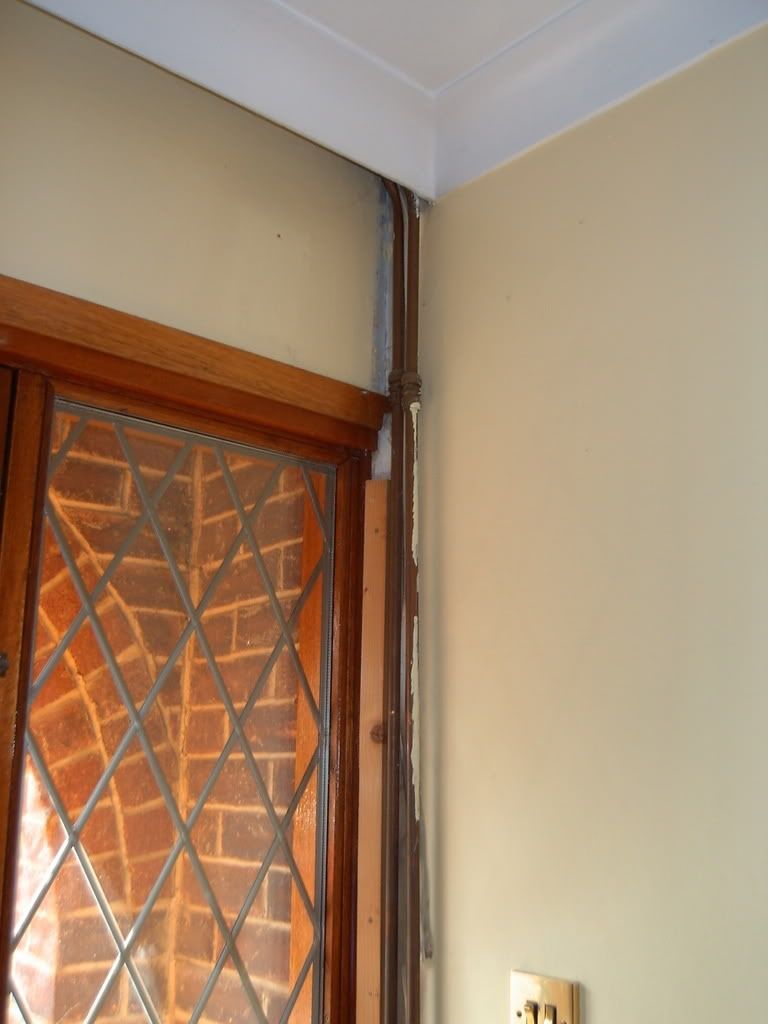

This picture shows the pipework coming down from the bedrooms to the hallway rad via the front door surround.

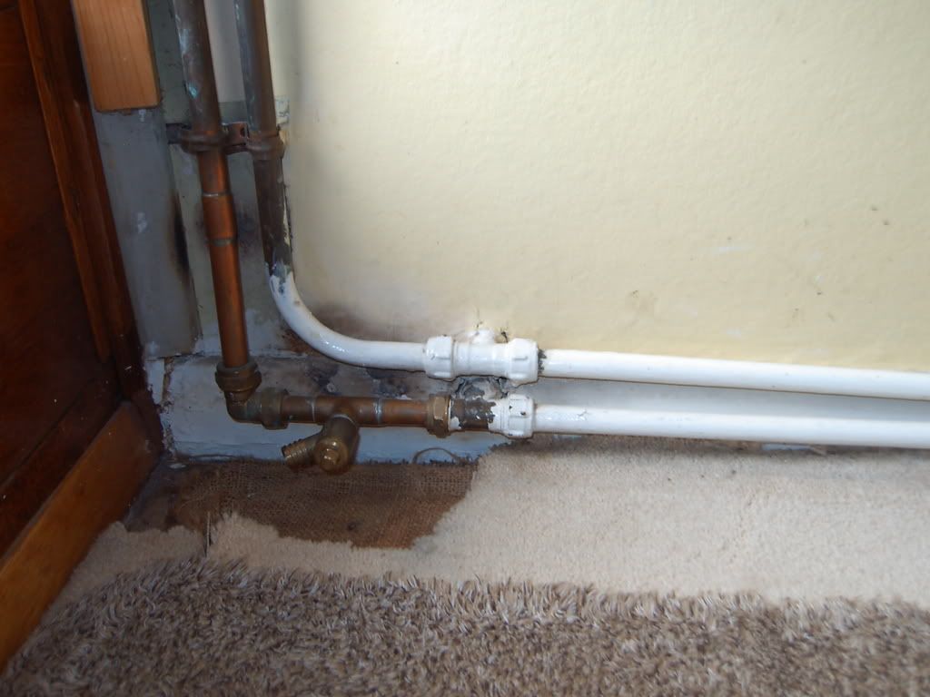

The next picture shows the pipe work splitting, through the wall into the front room.
What I want to achieve is moving a lot of the pipes away from the hall where they are on view and into the front room where furniture and boxing can hide them.
What I was thinking of doing is putting the pipe work through the wall above the front door, and then feeding it down the corner of the front room, where I can box it in.
I can then "split" the pipes and feed the hallway rad from pipework coming from the frontroom. I hope that makes sense :rolleyes:
What concerns me is that I mess up the flow to the rads by putting in a couple of right hand bends to get the pipes through the wall and down again.

A pumped 2 pipe system will not be affected so much as to worry about flow with a few elbows.
You could always bend some nice sweeping bends if you like.
Make sure you flush the system afterwards and add an inhibitor

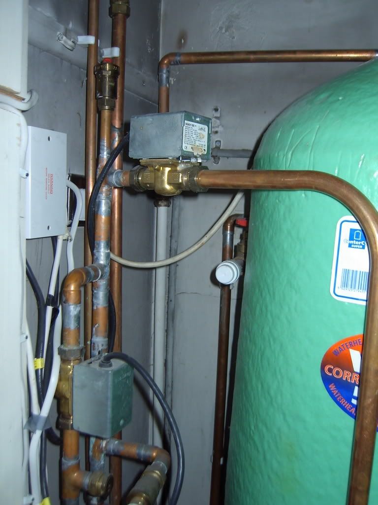

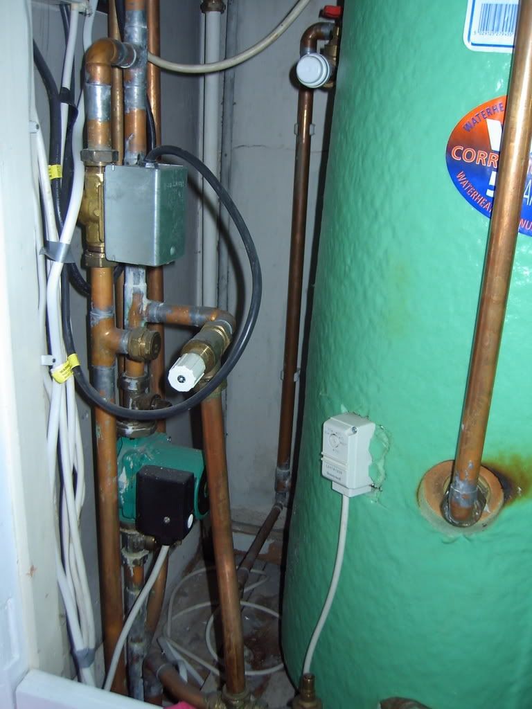

Here are some pictures of my airing cupbaord for ref. I haven't touched anything yet - I was waiting for advice :LOL:
I was hoping to get the boiler up and running then i could work on the other rads at ease!!
Any help from anyone in the know would be appreciated.
Lee
When you filled the system did you set the 2 port valves to manual open?
Make sure pump is set to 3
nope, I just untied the ballcock and let it go.
Should I move the valves to open now?
Yes set both to manual and bleed all rads and the bleed point next to the cylinder. When you turn the boiler on you should set temperature to minimum, about 30/35C. Make sure pump is on 3. These boilers are prone to faulting without a fast flow through them.

lj329 said:
I bled the point on a pipe coming from the bottom of the cylinder.
Bleed point next to cylinder should be on flow pipe into it about half way up. Probably after h/w zone valve.
When you bleed upstairs rads do you get air/water out. Is there water in your f&e tank?
As a side issue have you added new inhibitor as you were filling system?
If you have no luck with above I suggest you drain down completely and start the fill process again. Unfortunately as the boiler controls the pump you cannot easily circulate the water to remove air before boiler comes on.
