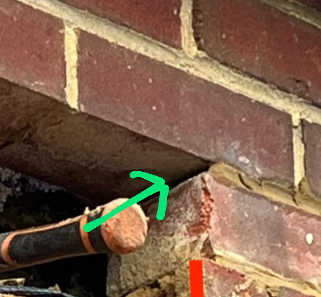

Advice needed for poorly finished brickwork and beam installation.

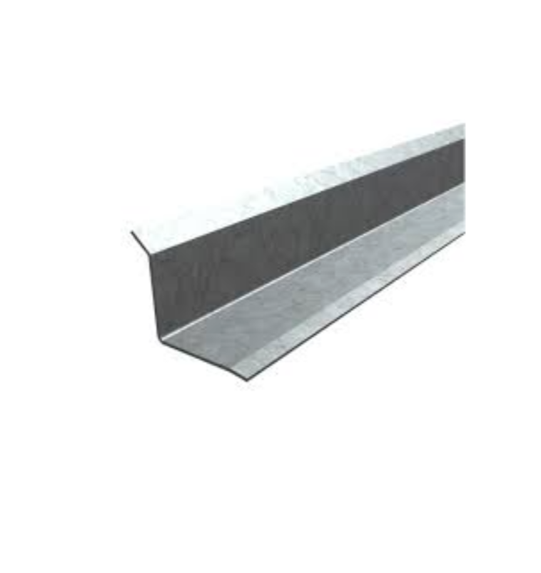

I'm still slightly puzzled by what you want to achieve here? The job should have been done with an off the shelf single leaf lintel:
This is galvanized, forms a cavity tray via the angled section at the rear and won't need any calculations.
Your SE should have told you this rather than that contraption you have now.
If it were me, I'd strip it all out and rebuild with a lintel. You've mentioned the different heights of the internal/external lintels - either drop the new external lintel a course lower, or fit a frame extender on top of the new doors.
You could try to rescue it, drilling weep holes where you've suggested would probably be ok - drill up at an angle and "waggle" the drill bit down till you feel it touching the front edge of the steel, it won't hurt the dpc. I think you've realised that even then any water won't necessarily drain, but the reality is that you shouldn't have bucketloads there and it will be a route for evaporation. You could drill a few more above the lower flange as well.
If BC have signed it off, don't worry about rust protection, you and your children will be long gone before it becomes an issue. Given how far it's set back from the front of the brickwork the exposed section can easily be completely enclosed with uPVC trim in conjunction with the door fitting.
* Having written the above, I've just noticed this:
It that's the standard of work generally I'd have it all out and start again! And whatever you do, sort those straight joints at the sides - they look dreadful.
