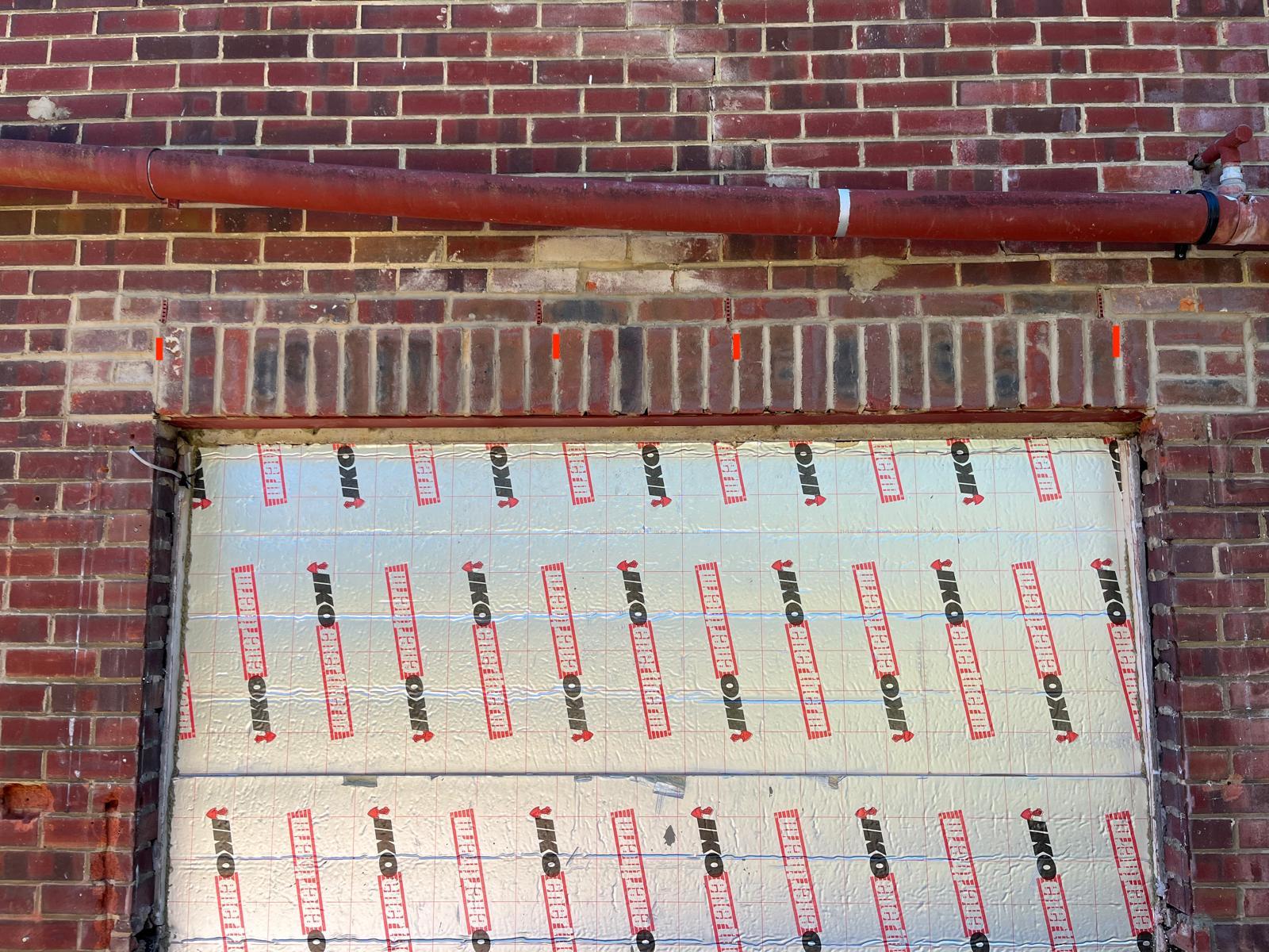

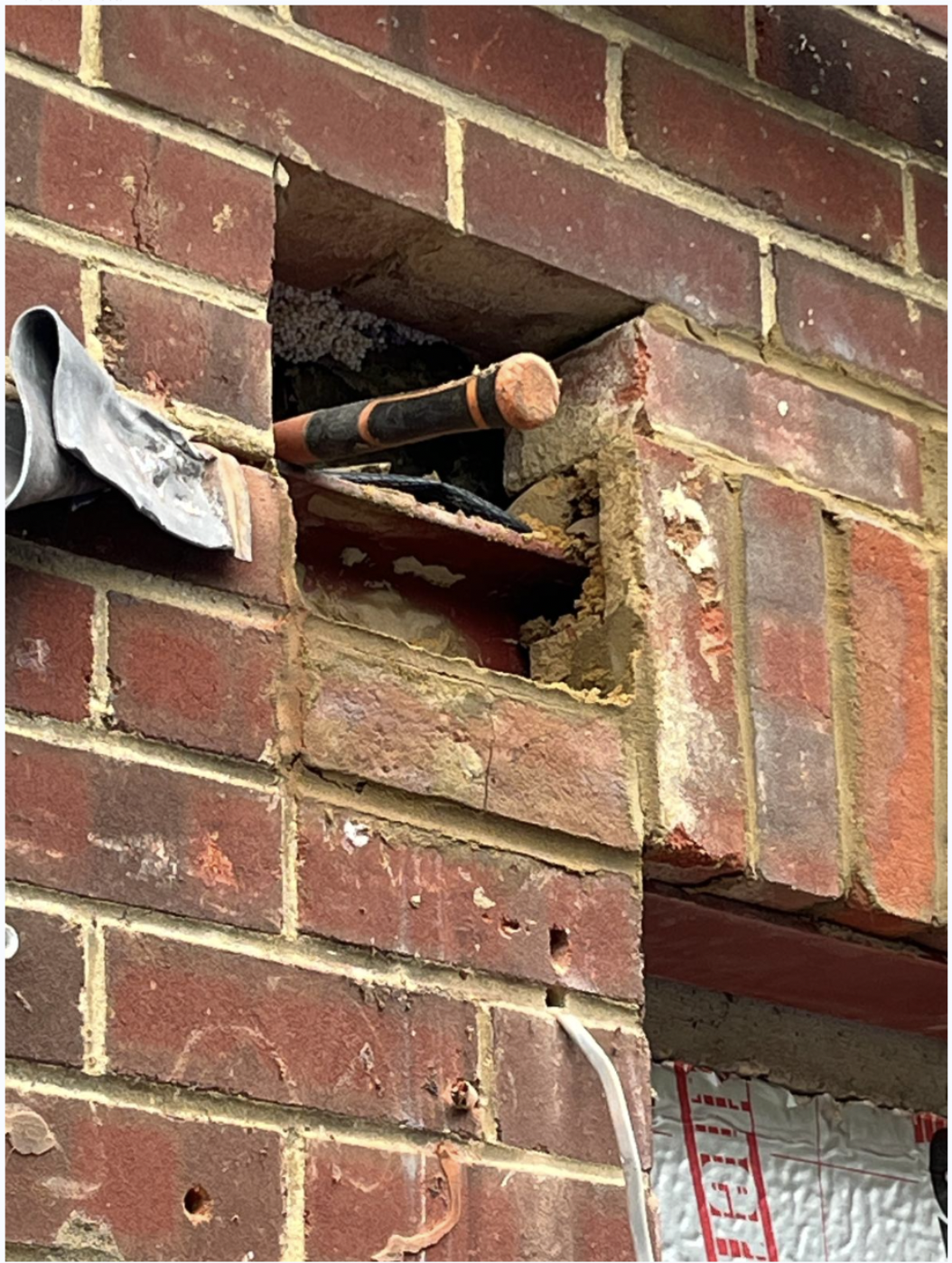

There is a new problem now that of all the quotes that came in everyone insists the beam should be an L profile not an I. They claim it will be much more expensive to do it properly with an I beam and partly the reason is on the below photo.
There is almost no brick support above the beam and just a bed of mortar which they refuse to install professionally. For some reason unknown to me the structural engineer has provided this I profile instead of L.
That would cause another application to building control if I contacted them I suppose or another fee with structural engineer unless I went back to him and asked for an L profile.

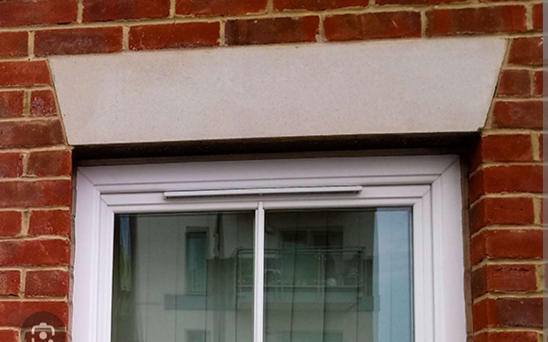

Assuming no cracking it's probably structurally ok. Have you considered a bit of render in the style of a mock stone lintel?
This is a real one as although I've seen a fair few (common trick to cover messy lintel replacement) I couldn't find a picture.
You could pack out below the steel with timber covered with cement board to level it and lower it to match the internal lintel height - you might need to avoid top hung doors to be on the safe side.
Thanks cdbe. While it may work in some situations in ours it would draw attention even more and we just want a proper blend in finish as the rest of the house.
Would you know if that steel could be not galvanised as one builder who was visiting for quote today pointed out the external steel has to be galvanised and this one is not (specs had galvanised steel).
According to him the steel should be silver not red like on the photos above.
I don't know why you have that steel, unless hanging bifold doors from it? An off the shelf single leaf lintel would normally be used - galvanised and no SE needed.
I can only think the structural engineer specced it to add strength (and to cover his back) as otherwise I am not sure why (the doors to be installed are sliding doors).
He pointed out the steel to be galvanised in his calcs and this has not been done by the builder. I've just been on a call with him and he says the steel needs protecting 100% so another thing to add to this misery...
Any ideas how to protect a Red Oxide primed steel that is already installed? Is painting the above section up to the window (the 1st floor window is same width as the steel and directly above it at about 1.5m so that gives a 2.4m x 1.5m section of the wall to protect) with Storm Dry the only option as I am not planning to render this section.
With Storm Dry I suspect I can remove the weepholes and mortart it all up. WDYT?
Otherwise I would have to lower them by about 40mm like on the attached photo below so that the are as close to DPC as possible (new position of weepholes marked in red).

Not sure, however, I would be able to do that as the section of bricks above soldier is placed on a thick bed of mortar so I doubt the water would be able to escape even if I position the weepholes correctly. WDYT? I am also risking drilling through the DPC itself...
Finally, I am not sure if by drilling through the mortar joints to create spaces for new weepholes I am not accidently going to cause cracking in these sections. WDYT?
I am also aware it would look quiet ****e and may draw attention but if it protects steel in a better way then I can compromise I suppose.
Thought the requirement could be met by painting it rather than it being galvanised
I cannot paint it in the section where it has the brickwork installed in the web correct? I could still do the paitning on the lower flange and underside I suppose + the Storm Dry on the brickwork above - that's the best I can think of hmm...
Thoughts?
I meant given it’s already red, I assumed it’s been painted as opposed to bare, and is ok.
What I meant by painting is cold galvanising it. It is Red Oxide yes so it is primed but if the beam is to be used on an external wall it apparently needs to be galvanised (not only Red Oxide) to meet the requirements.
