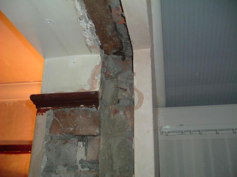

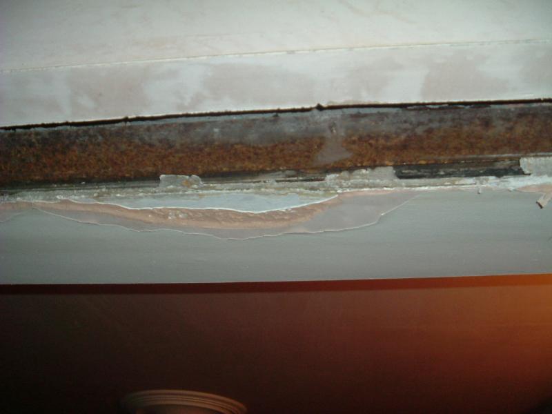

Had a conservatory built last year but didn't remove the old patio doors till a short while ago. Can anyone tell me the best way to plaster in the recess after removing the doors.
First pic is the RSJ above the old doors and second pic is the wall where it meets the 'ceiling', or rather where the RSJ is. Thought about a bag of bonding followed by a skim of board finish, how does this sound?
Plaster depth on side wall is about 10mm.

Dot and dab over the opening and bead it and skim it. Might be worth painting the old rsj with red-oxide first...
Roy,
by dot& dab do you mean fill in with plasterboard first and then a light skim. Thanks.

Re the steel beam, dot & dab PB & then skim as Roy suggests.
