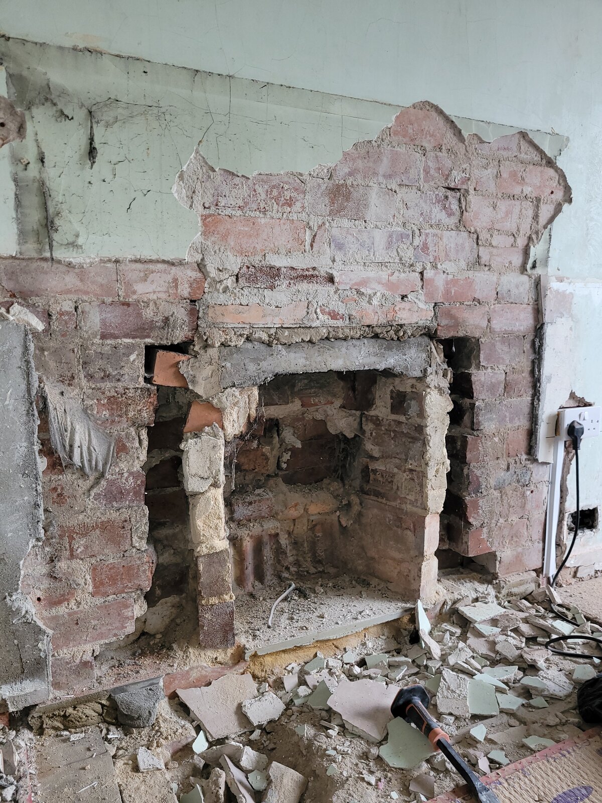

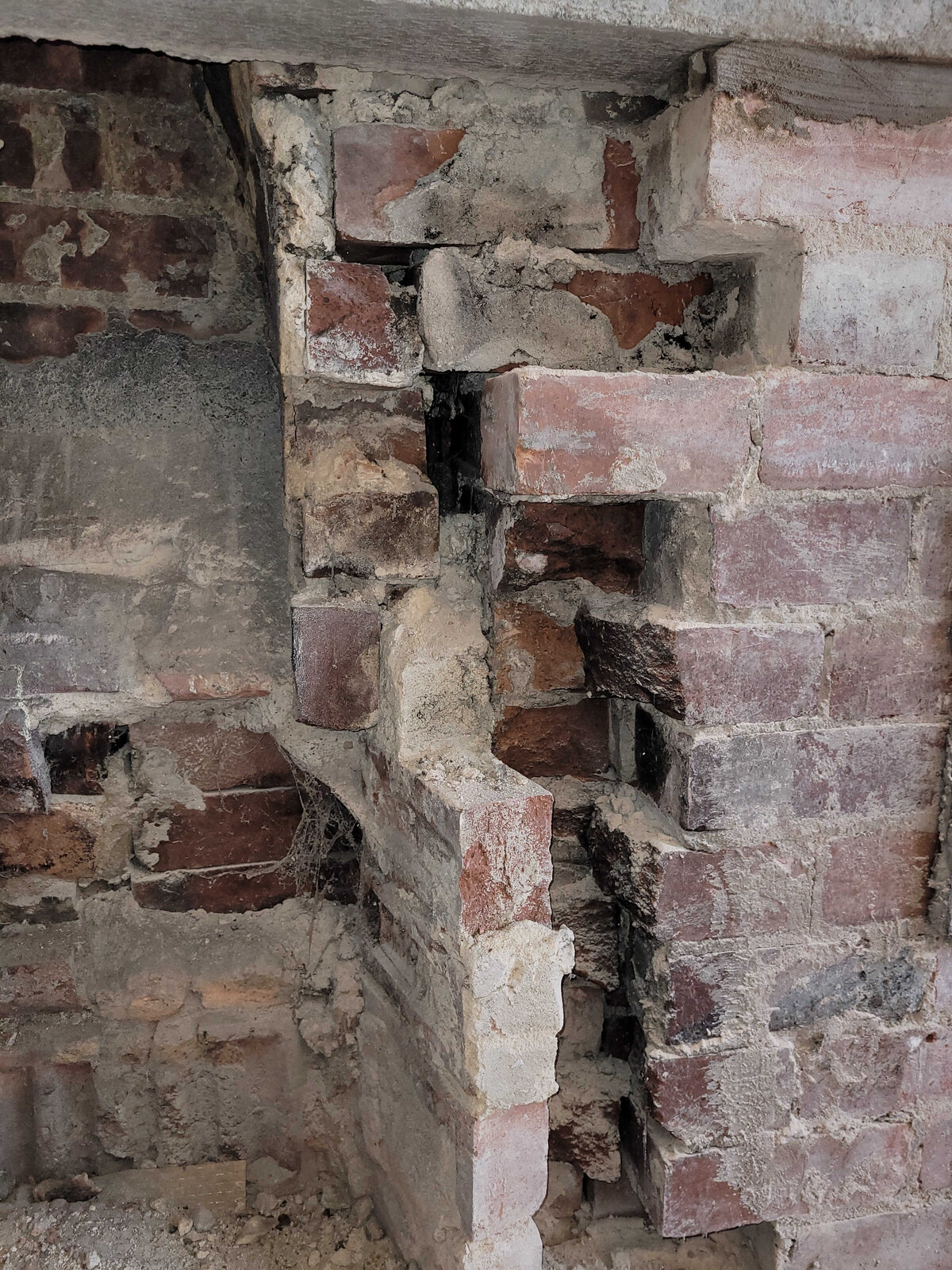

Hi,
We're in the process of renovating our living room and are replacing the old gas fire with a fake/electric woodburner.
Had the fire removed and gas supply capped off and now we've got round to removing the fire surround, mantel etc.
Bit disappointed to find some questionable brickwork and no obvious lintel.
The actual chimney stack is external to the building (built in late 50s), but I still presumed a lintel might still be required to support the internal brickwork above?
Our aim was not to widen or deepen, just to tidy up and have the cavity plastered ready to put a small/medium sized fake woodburner in.
I've attached a photo of the current situation.
Any advice on how to approach this is greatly appreciated

There is a lintel its on the rebuilt fire back. That lintle is supporting a 45 degree triangle of bricks above it so about 8 bricks worth. Just fix a 2x4 batten across the line of bricks that you want to keep , plug and screw the end of the batten then into each brick centre, bricks supported get rid of the lash up and pop in a lintel, the chimney above will not collapse its toothed in from the rear wall like a lego wall. eg as below

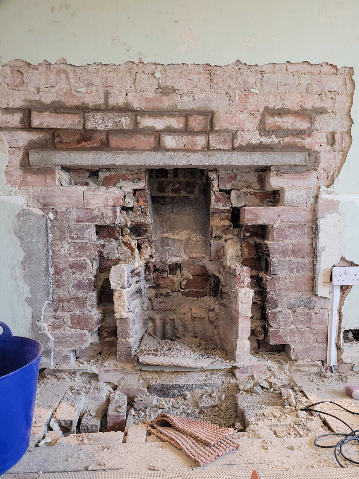

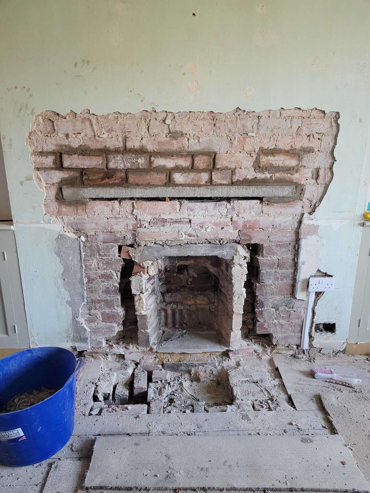

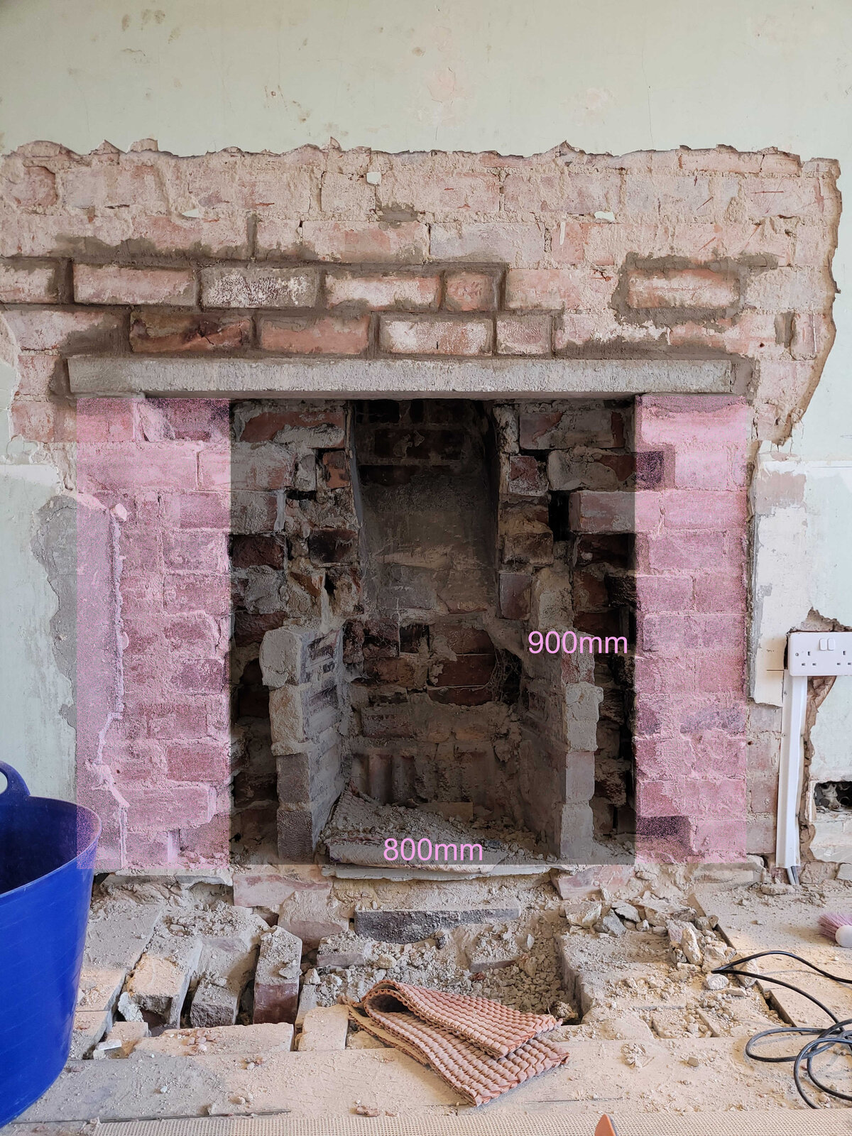

Hello all, I cracked of this past week and made a start

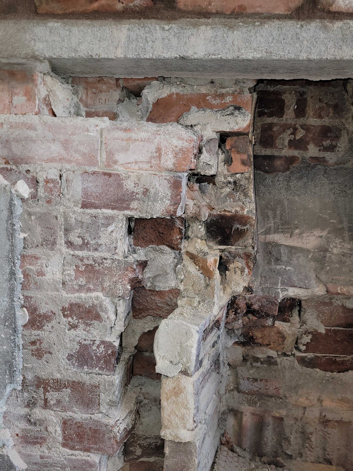

I proceeded to install a concrete lintel on the front layer of bricks, replaced the bricks that dropped above and today began removing from below.

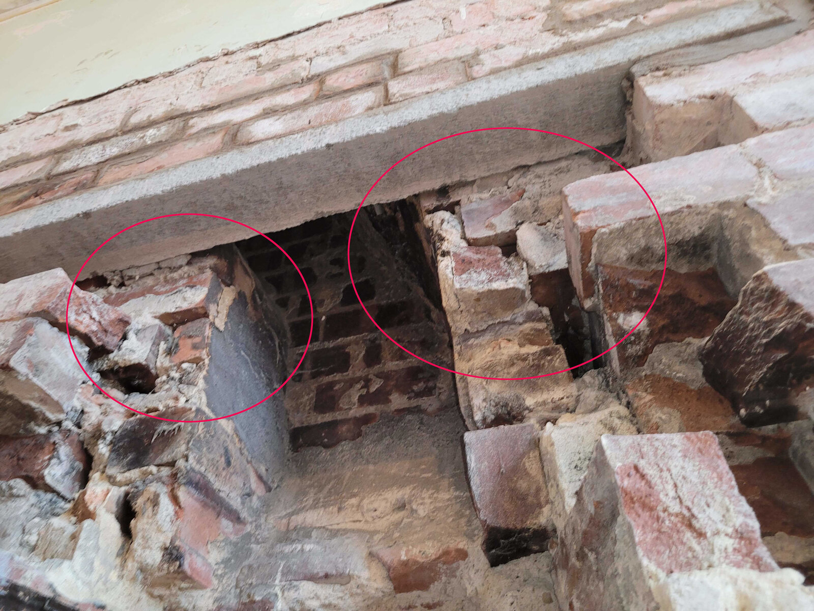

my question is, I'm not certain how to proceed making the fireplace as wide as we wanted (aiming for approx. 800mm wide after plastering)
the sides of the flue, which goes up at an angle, look like they might stop me doing this or at least I would need some other way to support them if I removed any bricks? am I correct in assuming that these are bearing load of those above them? or are they supported in some other ways?
Thanks, Tom

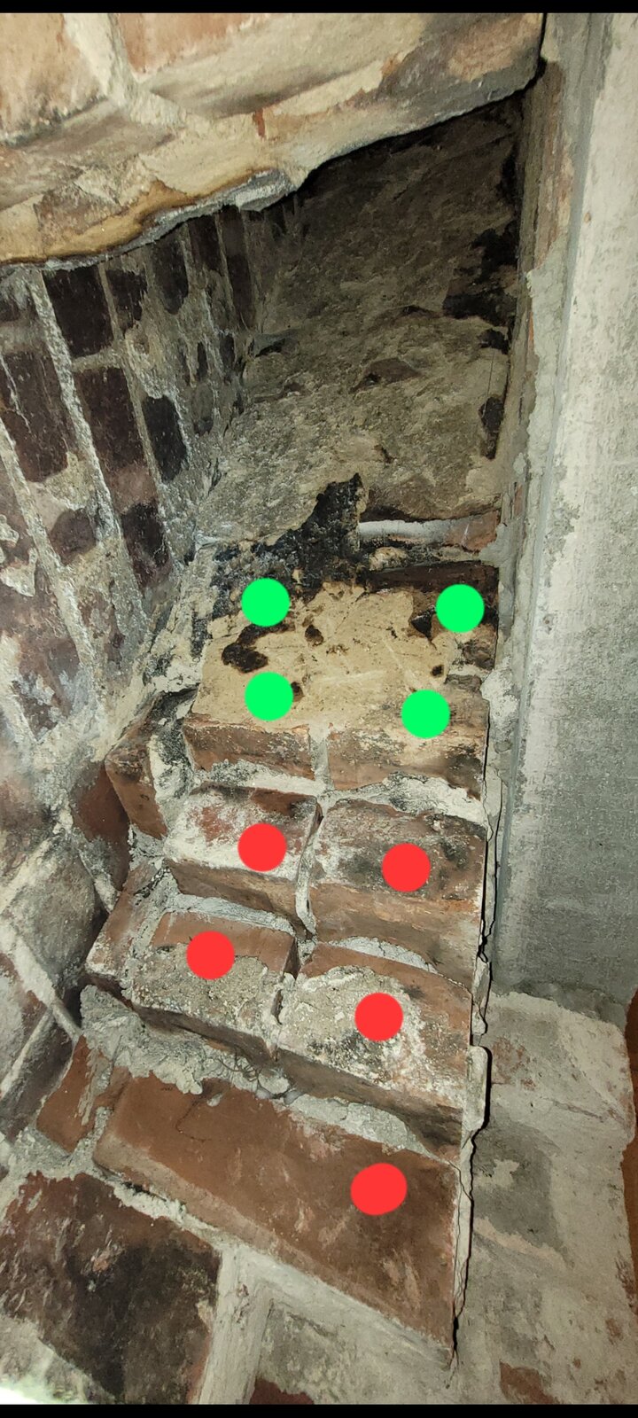

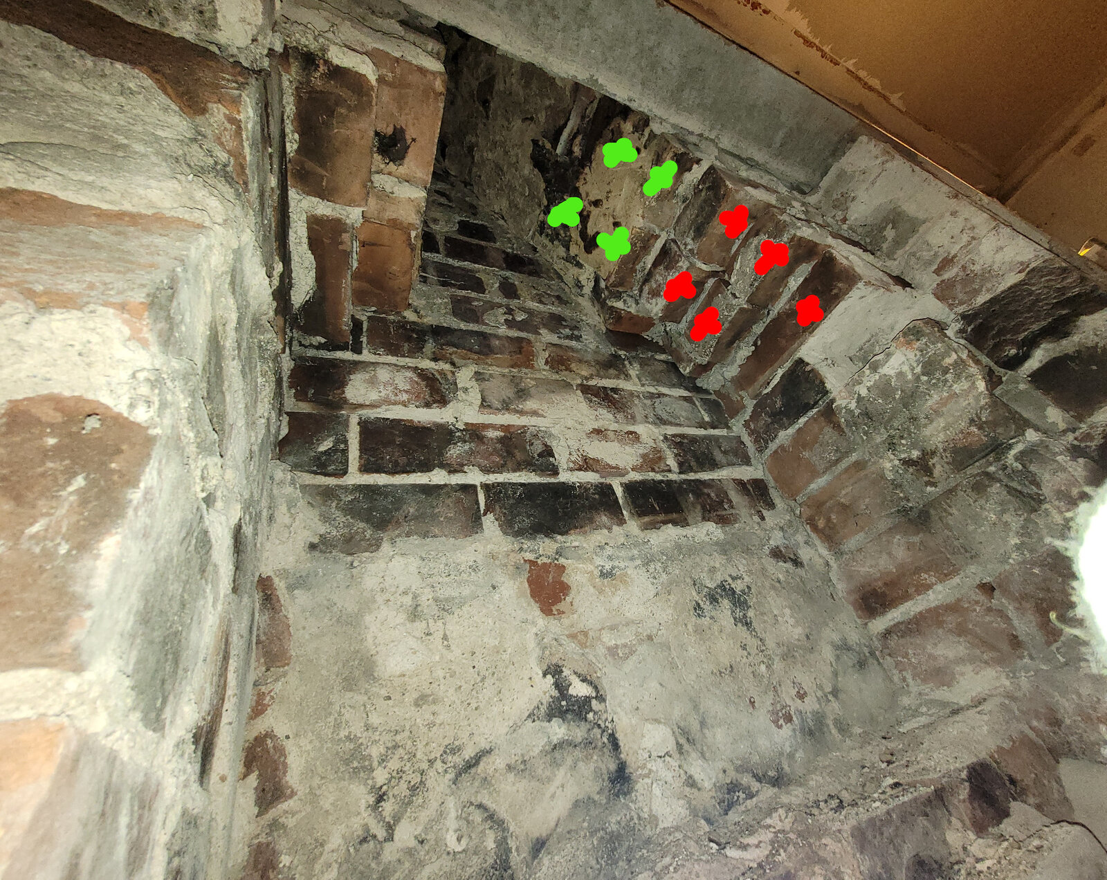

thanks, i would presume (hope) so. my worry is that even if that's the case, I'm not sure at what points they would be toothed in, certainly I can't see how those immediately above would benefit.
if I were to remove those with red crosses in the photo, those bricks directly on top (with green crosses) would only be staying in place with the existing mortar? , and gravity would eventually take over?
presumably either we just let the bricks come away until the keyed ones remain (how would we be certain we've got them all) or is there an alternative, possibly angled steel in from front to back for those green bricks to rest on?
Also curious about those small slips of bricks between them and the back wall... just used as padding while constructing? To keep it level?

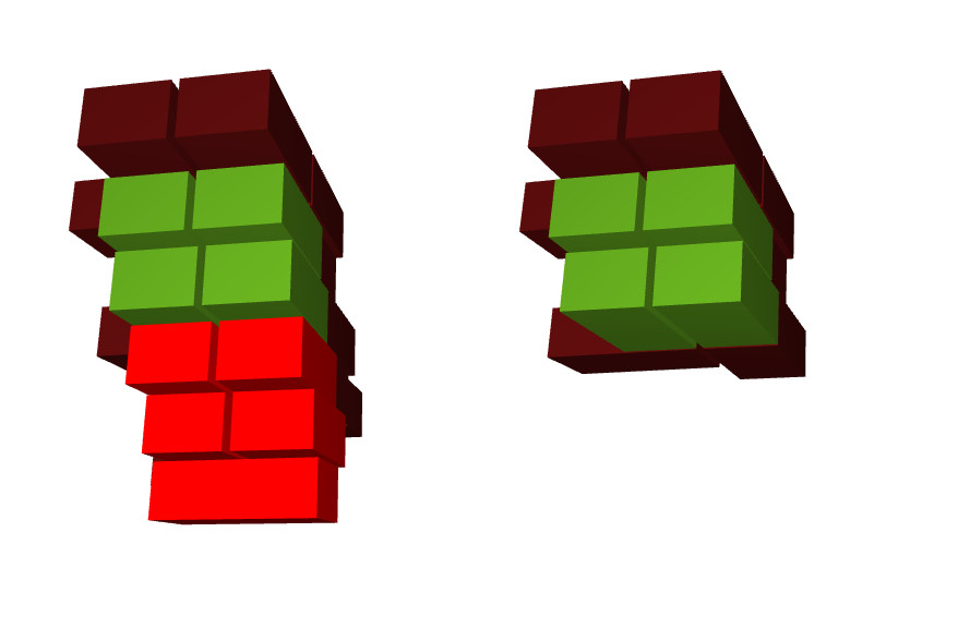

They are toothed in to the side wall...a brick comes out the back wall and is constrained by the brick above and below, next the green brick 1 closest to the back wall comes off that brick at 90 degrees, green brick 2 closest to the lintel is comes off a brick toothed into the front wall.
It has to be this way otherwise the whole weight of the chimney would be resting on that bottom half brick just poking out the wall...think about it.
I assume that pretty standard so each level of the corbelling then supports itself. So you could take out a few levels at the bottom if you wanted more hieght?
I've had the same query here: https://www.diynot.com/diy/threads/widening-fireplace-corbelling.598822/
Thanks for the help.
I understand there the must be interlinked/toothed bricks behind, and, as a whole that structure supports itself.
but the location of these interlinked bricks can't support things below them? maybe I'm missing something here, but i still don't see how those green bricks (and subsequent levels above) would stay floating in place if the red bricks were removed? there can't be anything supporting them below other than the red bricks i would remove?
And....what is it the problem...if you need to remove the red ones do so, the green ones may or may not move pop a tile in to give them some support...its 4 bricks. The point being that they are not structural item of the chimney they are just the flue liner. The bits above will not collapse.
I'm not sure that it would be just 4 bricks? they continue in that orientation for a least several more course above so could potentially be all the flue liner bricks on that side.
it's not that it's a problem if they fall away, i would just rather they not if possible, which is why i thought it best to put something in to support it.
or at the least, get them all out in one go and not leave anything nasty behind to fall at a later date.
