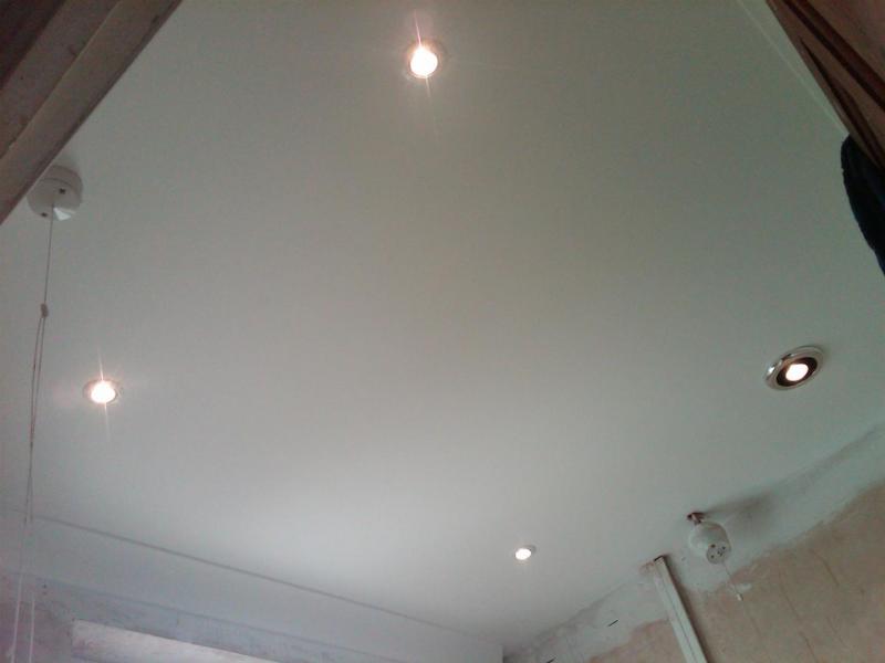

I had the same issue with bathroom ventilation need and opted for one of these:
http://www.lyonlighting.com/acatalog/info_EFKITL.html
You fit it directly above the Shower in place of one of the downlighters that you might already have installed there, the rest of the components sit in the loft. Try to avoid attaching the fan unit to the ceiling joists directly above the bathroom else you'll get noise/vibration, alternatively insert some acoustic insulation material beneath the fan unit.
Really pleased with mine!
p.s. Photo of ceiling/lighting finished, but rest of room was still in DIY stage...lol!
I suggest replacing that crappy concertinaed plastic tubing with rigid PVC pipe to reduce noise and stop water condensing in the folds and then , inevitably, leaking out sometime.
I don't think you noticed the caption above the photo :D
It was only to show the extractor/downlight to the OP.

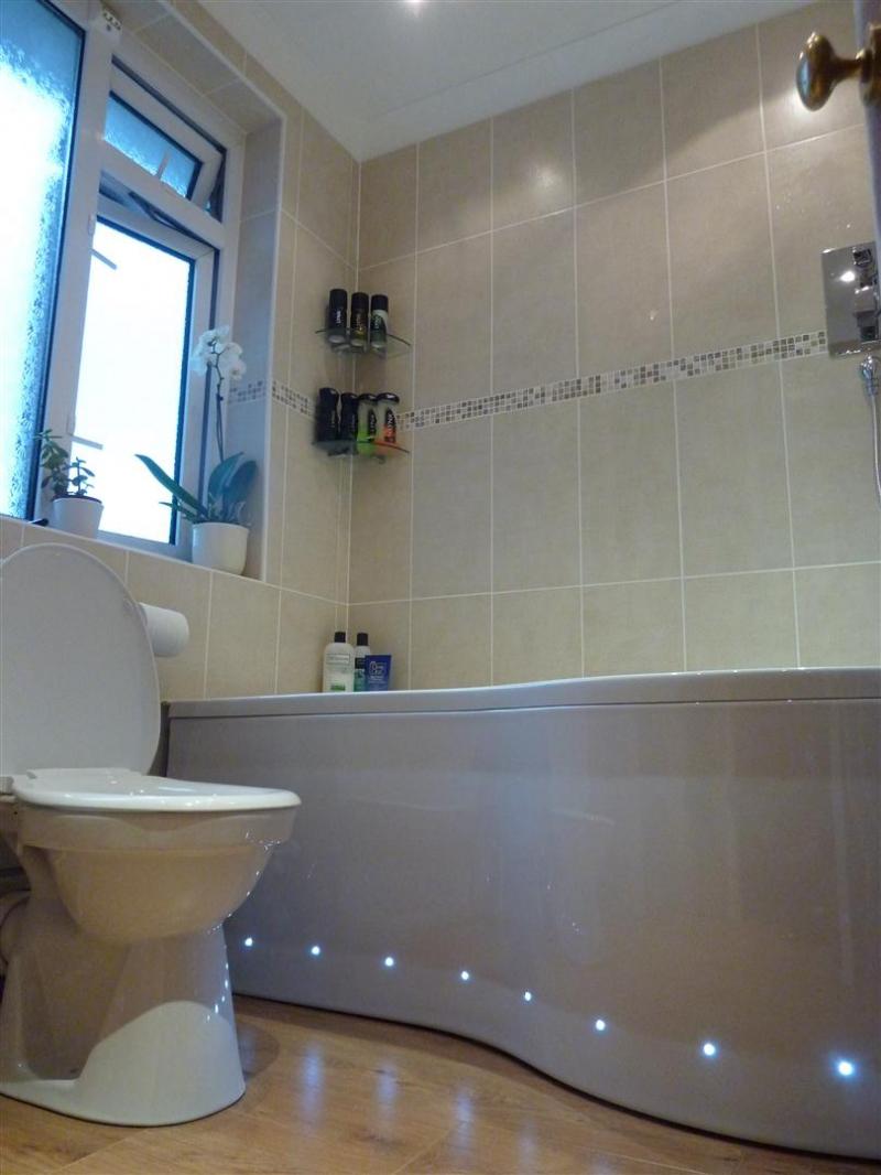

My bathroom now looks like this:
