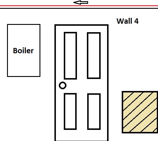

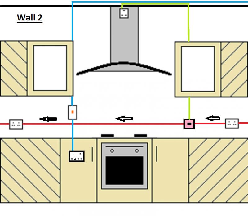

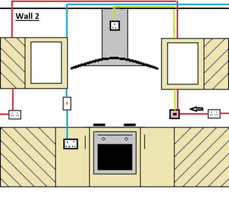

Ive actually changed my route on wall 2 as i wasnt happy with the way my cooker feed and ring crossed new pic:

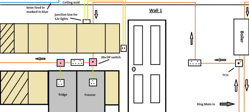

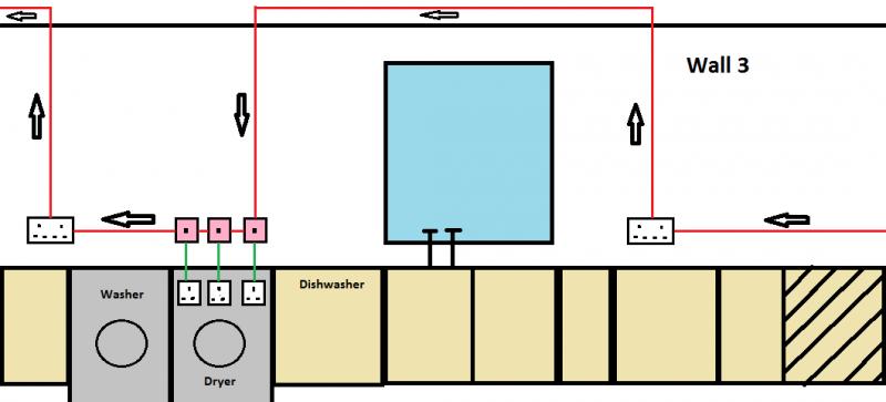

I know what you mean about consistency but as long as its ok im happy with the route... Just spoke to someone with regards to the 20 amp DP switches for the spurs to the appliances and he seems to think the should be FCU's.. i was only going with the switches as i read somwhere that each appliance should only have 1 fuse and as they all have moulded fused plugs 20amp DP switches were ample, Any thoughts?? Cheers again Lads for your help :D
I have looked and this is what i came up with, made the mistake of thinking i could come on a "Forum for advice on electrical practice" and actually getting some advice... not once has anybody yet looked at my pictures and said "No you can not do it that way" or "Yes that will be fine" which was the main purpose of the post in the first place so,
PBoD has actually given you some advice.
not to be rude or ignorant i'll ask it once agiain, as concise as i can put it... "Is there anything wrong with my proposed routing of the cables"
I would apreciate if the answers from here on in would tell me why im wrong or right and not be about members "Spending the pink pound" in brighton, as i believe that is the true purpose of a DIY forum
Cheers again Dave

spur off spurs off radials
Do you think that there is something wrong with that?

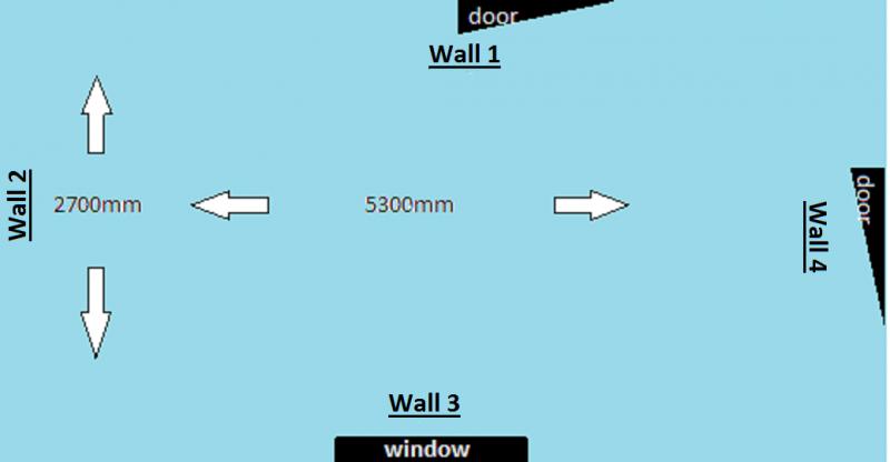

i now have a blank canvas to install a fresh ring for the kitchen...
OK - as you want to assume the role of circuit designer, what work have you done to analyse the distribution (temporal as well as spatial) of the loads in the kitchen which has led you to decide that a ring final is the best design?
want to get all the wireing inplace myself to save money then get a spark in to connect the tails and check and sign off before i board.
